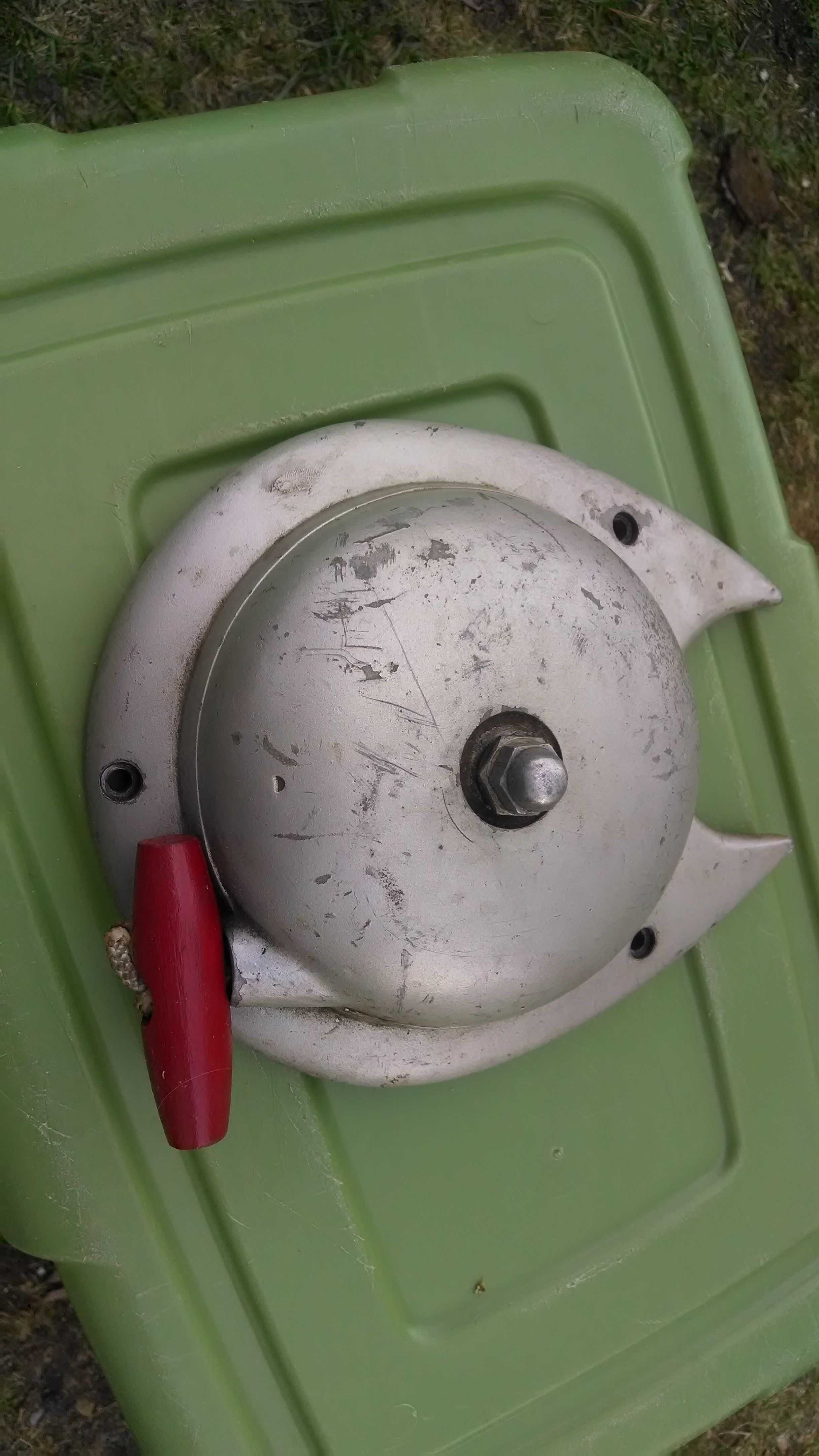

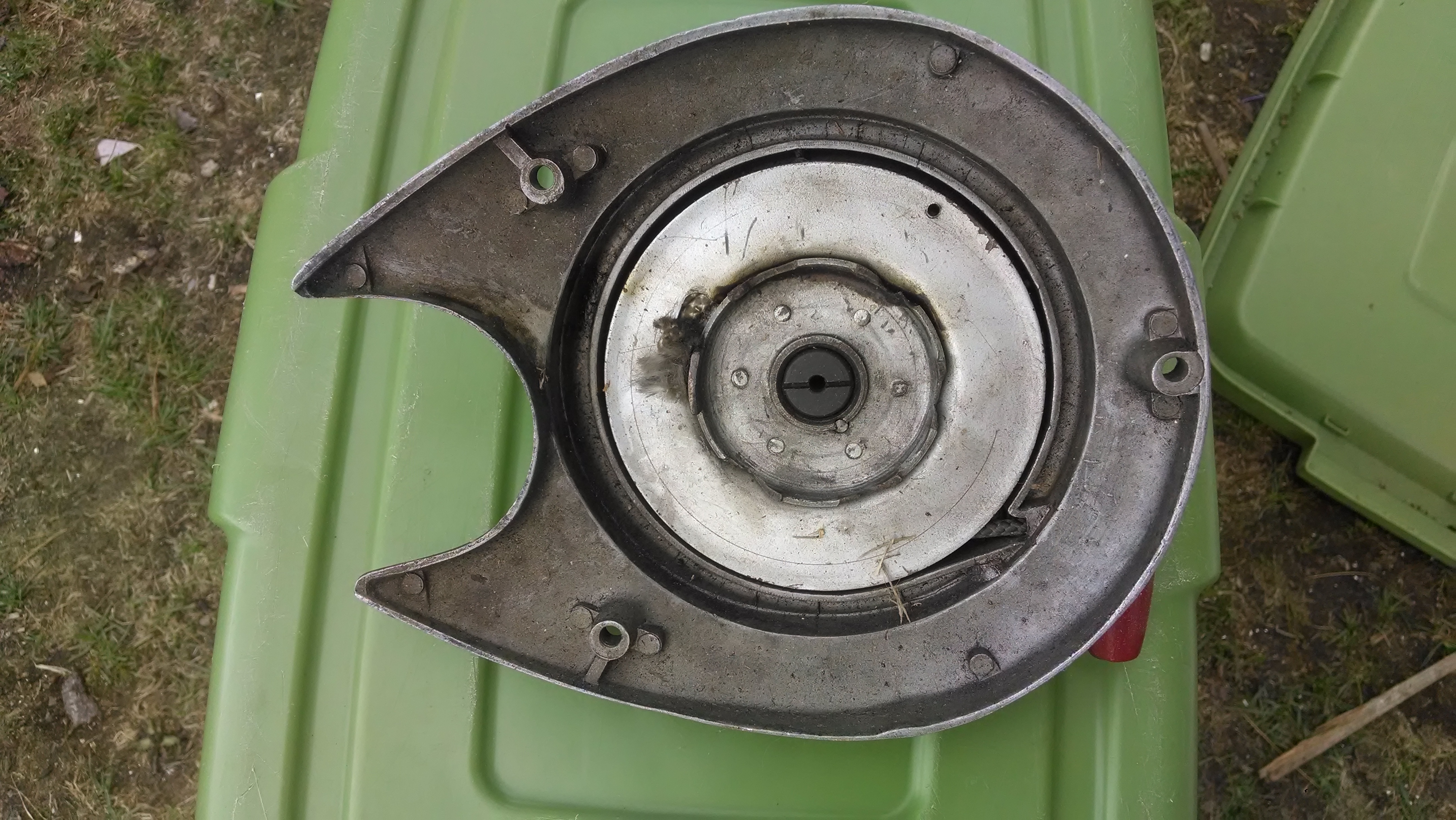

      I wonder what motor this might fit?
      #56820
        My first thought is that it looks "Evinrude-ish"
        #56821
        wedgie
          I’m thinking Zephyr
          #56822
          leeinnh
            evinrude sportman 2 hp 1941 ish to 46 ish , and also ranger had similar. ranger is smaller?
            #56823
            davidk
              I was hoping it would fit the sportsman I’m reconstructing but it’s too small. Maybe the Ranger?
              #56842
              kees
                International Member
                if it is too small for the Sportsman…..it is also too small for the Sportwin and Zephyr
                it must be the Ranger
                maybe dimensions will help.
                #56849
                Leon
                  Look for a casting number. That often times is the part number.

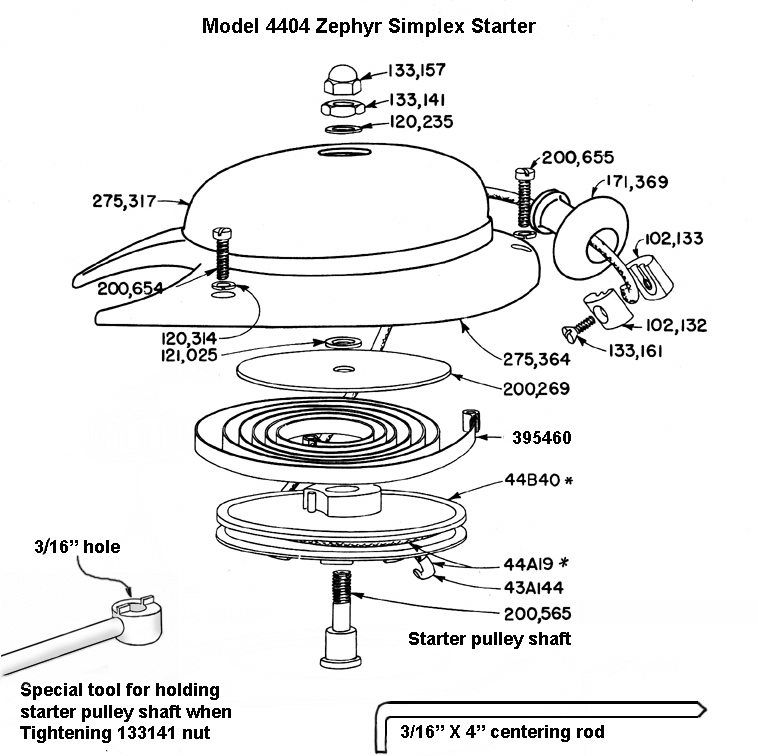

                  #56917
                    It looks to, me like a 375392 starter for a Sportsman. The Sportwin and Zephyr had the bigger 375317 starter. . . 😀
