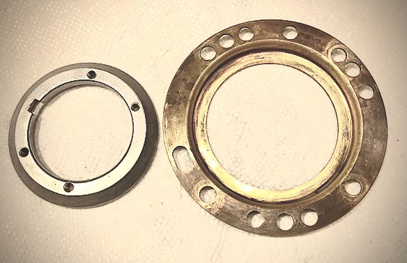

I seem to remember the recipe for moly grease was one drop of oil to a small amount of moly grease, just enough to thin it out a bit. Whatever it was, I never use moly anymore and just use a light coating of a thin light grease. My daily driver now is the green Lucas Xtra Heavy Duty Wheel Bearing Grease which is thin and has no fibres in it to get hard when the weather is cold. It seems to work OK.
You have to remember that these bearing surfaces are in the ground path for the spark plugs so cleaning any tarnish off with fine grit paper first will help the electrons flow. What you don’t want to use is a dielectric (non conducting) grease of any kind as it will act as an insulator.

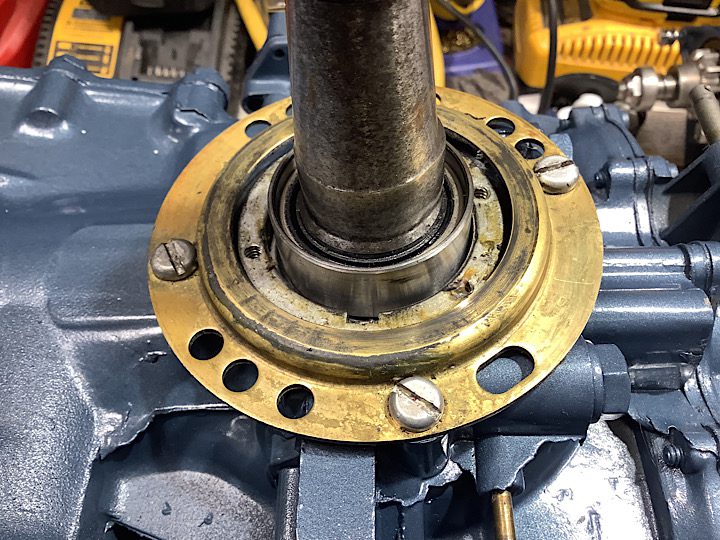

October 15, 2022 at 6:13 pm #267702Biggest mistake people do is slather on too much grease. It just splatters out and fouls the points. Just a thin smear is all it takes.
October 15, 2022 at 8:01 pm #267704Yep, it is a delicate balance for sure. The “recipe” you heard about the moly lube and the TCW3 oil is for the engines that use the mag plate/timer base that has the plastic bushing around the outer diameter. Use the moly lube on the pilot bushing, and a thin coating of TCW3 on the plastic bushing.
I use a very thin coat of the moly lube on the standard mag bushings as well.

I got paranoid, and scrubbed all of the old hard grease off them, and even popped them into the ultrasonic cleaner.
That should give me a good clean starting point.Bob D
October 16, 2022 at 2:15 pm #267737if you are really worried ……..run a flexing braid wire between the armature plate and the engine body for 100%….continuity 0 ohms
grease or not you will have a full circuit to the plugs

October 16, 2022 at 5:00 pm #267745If you ever install a ground wire, try and get a length of scrap elevator cable. It’s composed of many insulated mutistrand wires and is meant to flex as it coils up in the pit as the elevator goes up and down. The stuff I have is about 16G and it works great for a ground wire on a magneto plate which is costantly going back and forth.
October 16, 2022 at 5:17 pm #267749While it is true that the mount is the ground return, it’s nothing to get paranoid about. The high spark voltage has no problem jumping across any resistance.
