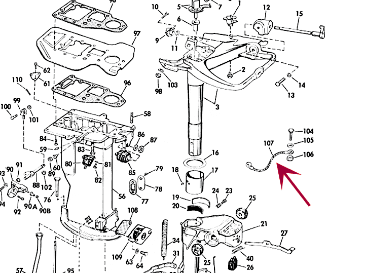

        Well since this post went from grease to grounds, I have another question.
        I noticed that OMC added a ground strap on the 33HP where my 64 28HP didn’t have one. Would it be a good idea to add it, and where exactly does it go?
        Thanks,
        Bob D

          #267797
            Thanks,
            Bob D
            IMG_2089
            Since the motor is mounted in rubber mounts, the ground wire bonds it to the steering bracket.
