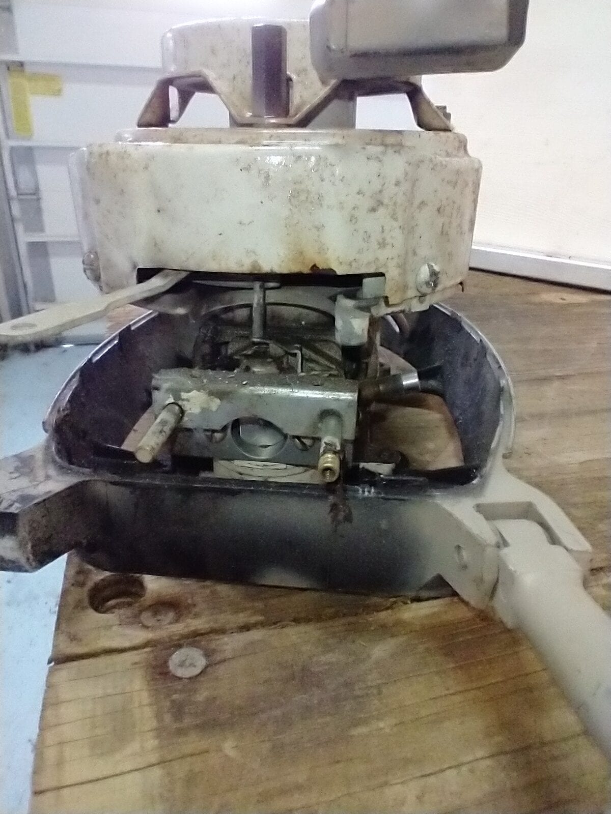

      I have an Arrow air cooled outboard. Serial number 690570. Can anyone help with narrowing down the horse power?

        Is there no Model number anywhere?

        #237767
        thephridge
          I only have the power head and recoil and the transom mounting part. I can’t see a model number. I checked discount parts sight and didn’t find anything there. I’ve attached an image of the power head. Its not a great picture. Is there anyway from the power head I can tell the HP?

          #237771
          CHUCK
            Here’s the other page on discount marine parts that gives the over-view.
            https://www.discount-marine-parts.com/ob_triton.html
            From the picture I wonder if that is a tecumseh powerhead? Tecumseh made powerheads and sold them to various outboard manufacturers. If so; then you can look over the powerhead and maybe you will find a Tecumseh model number. Then you can look that up and see the HP. Look for numbers punched into the blower housing or for a small tag mounted on the engine somewhere,

                #238417
                thephridge
                  So everything has petered out. The only other number I can find is on the flywheel…610751. And that only comes up as a part number. There has to be a way to find the HP of this motor.
                  #238423
                    If you can measure bore and stroke and find “specs”, then you’ll know horse power.
