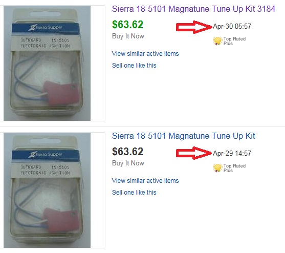

go to ebay look up 361535236657 if you cant get itMay 4, 2016 at 7:24 am #35943…there are 4 now..yippee I got mine!
May 4, 2016 at 2:11 pm #35953Anonymous
Checked it yesterday after it was posted and again just now. I’m getting old and my memory isn’t what it used to be but I’m pretty sure the price jumped by $10 per unit.
KirkMay 4, 2016 at 2:53 pm #35958As long as were on the subject of "modules" to replace points and condenser…..
I was wondering as I was helping my uncle on his JD lawnmower with the
Kawasaki engine and little igniter module, if this type of external module
would work on an outboard magneto, using the original outboard coils?Prepare to be boarded!
May 4, 2016 at 3:07 pm #35961Thanks Dave. Now I see it.
I thought the last ones I bought from Banta Saw were pricey at $25 each but these ones convert to $94.36 Cdn at today’s rate!
Buck: Yes, these are the red Atoms which are for outboard motors with adjustable timing. Fixed timing outboards, chainsaws, lawn mowers, Briggs engines etc use different color coded modules depending on the application.
May 4, 2016 at 3:18 pm #35965quote kirkp:Checked it yesterday after it was posted and again just now.
KirkNothing wrong with your eyesight or your memory.
