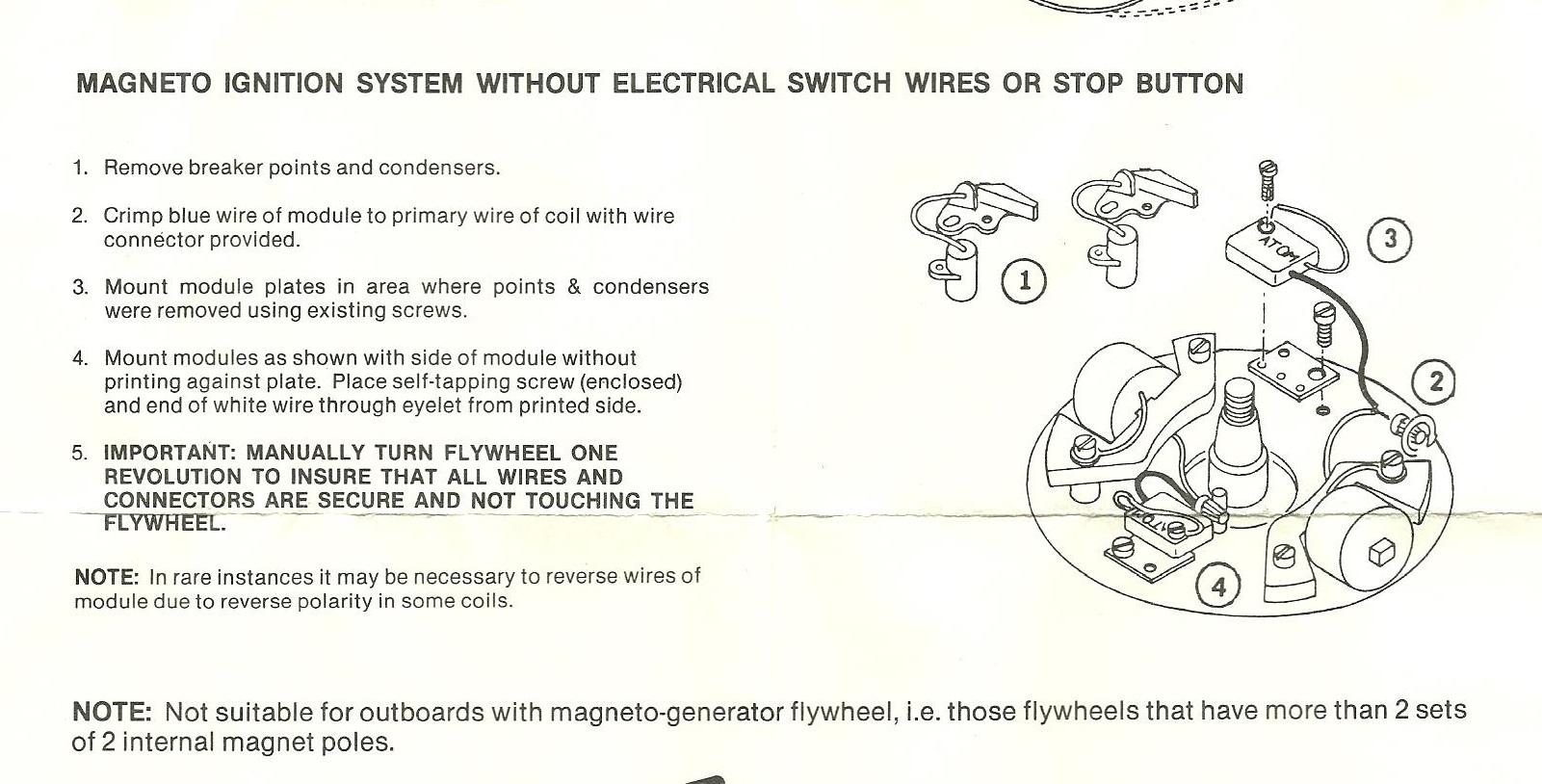

              quote rudderless:
              I do have the electric start driver coil.
              Is this motor electric start with an alternator?
              See the note at the bottom of this instruction sheet.
              #70661
              rudderless
                No, the flywheel has 2 pr of mags…non-electric charging wheel. I got the higher output driver coil to offset the inherent conductivity (about 1500 ohms) of the atoms when they open. Yea..the recoil will snap back sometimes cause of the good low speed spark. If it wasn’t for the crappy carb it would idle at 100rpm.

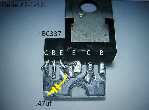

                #70667
                debe
                  This is whats in the original Atom module.

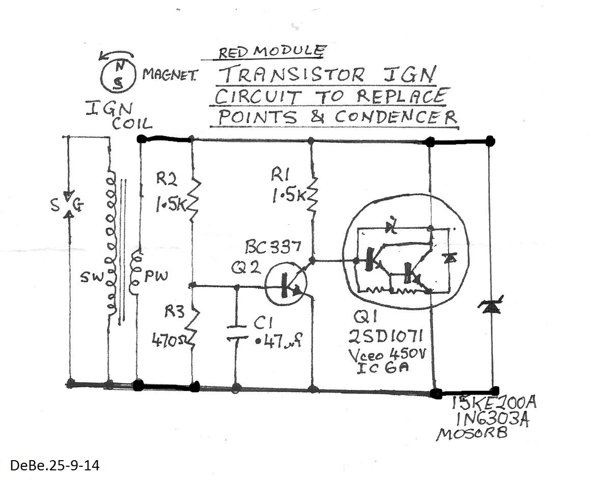

                  #70668
                  debe
                    This is the circuit with a added Mosorb to protect from high voltage spikes.
