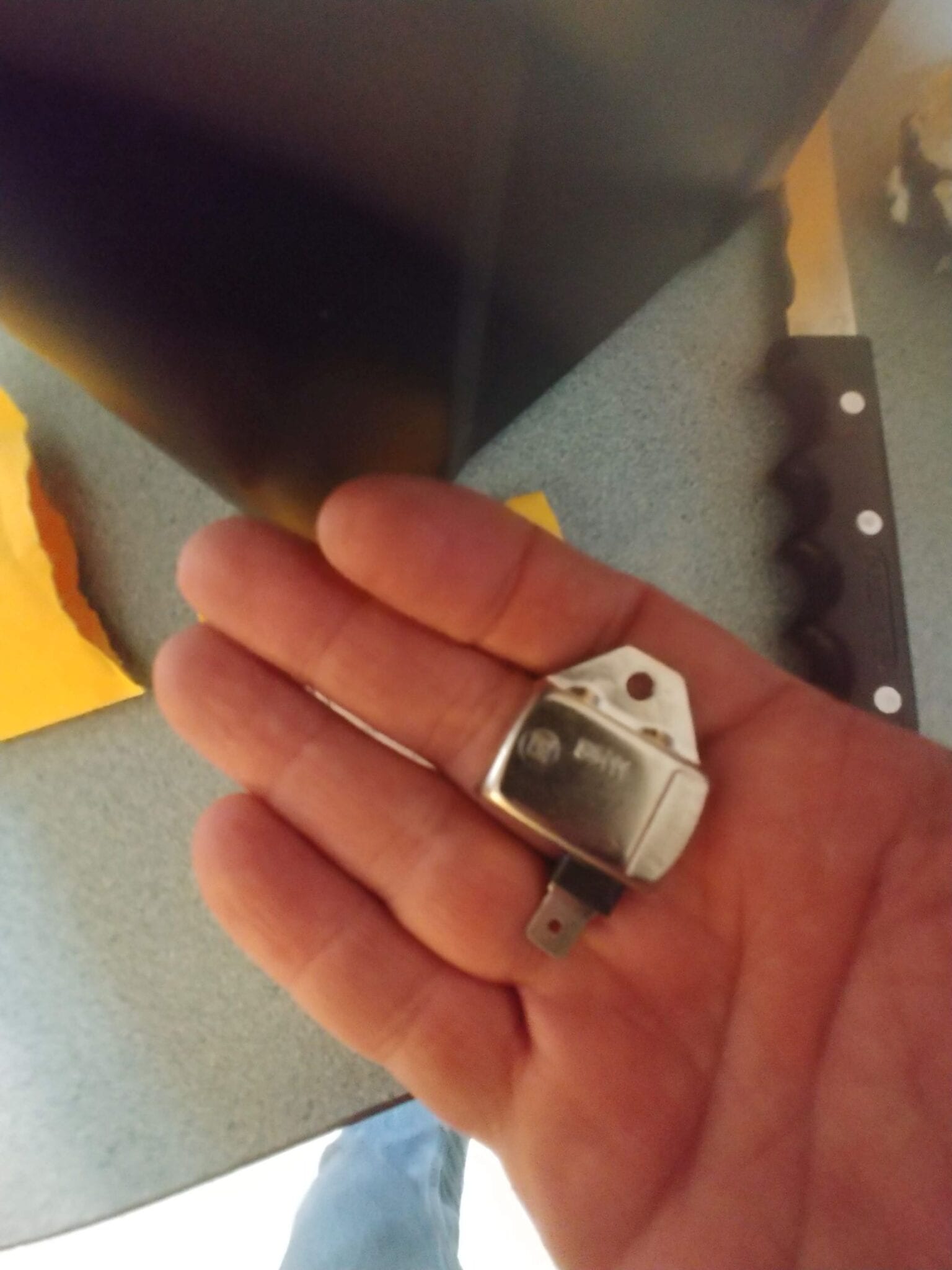

                    #239287
                    bwanadon
                      I got my Kawasaki chips in.
                      Kawa-chip-resize

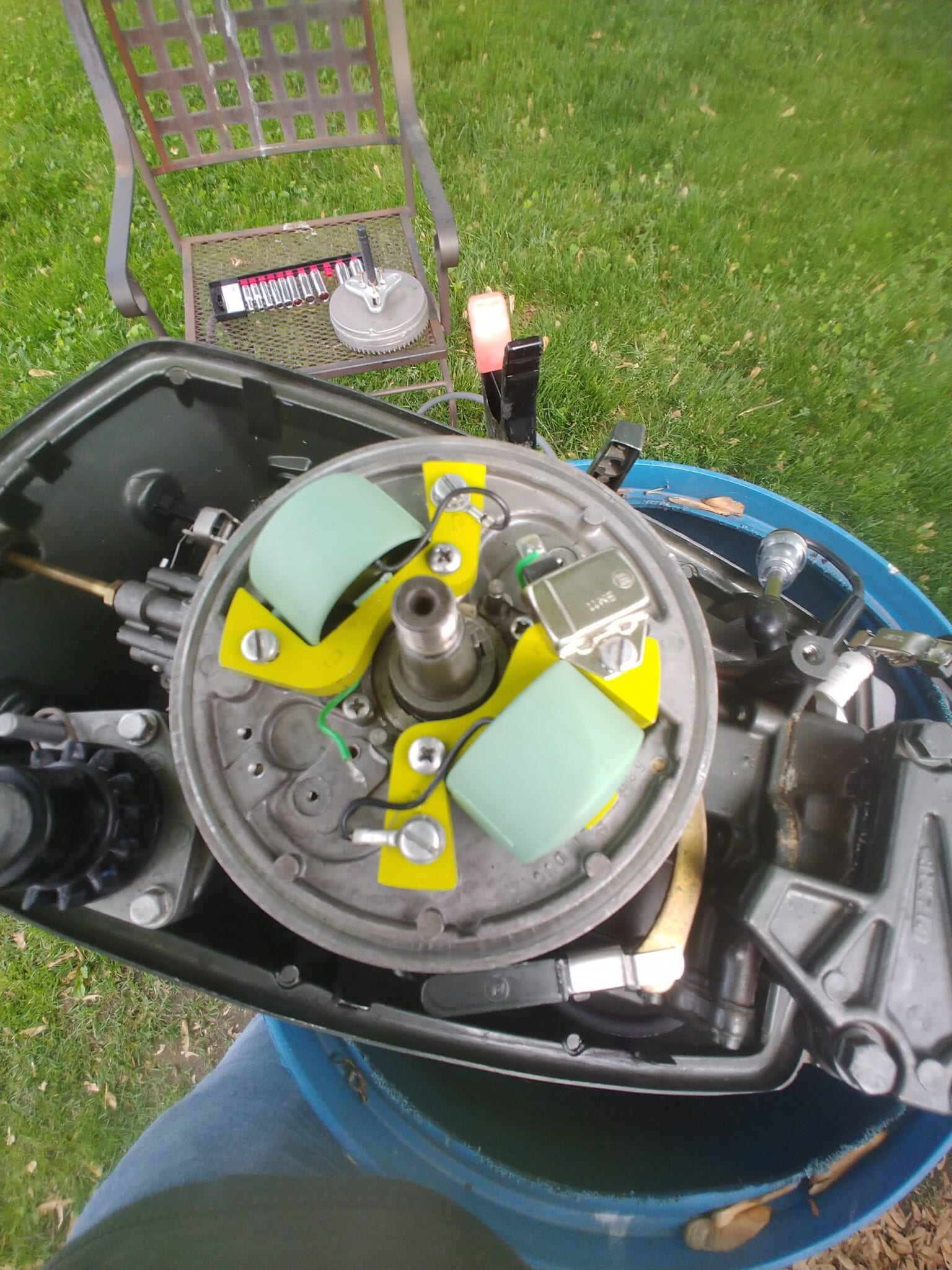

                      #239290
                      bwanadon
                        They are big and it’s a challenge to get them tucked in.
                        Will this work. Grounding it out on top of the coil. If not I’m gonna have to make an “L” bracket ad mount them standing up.
