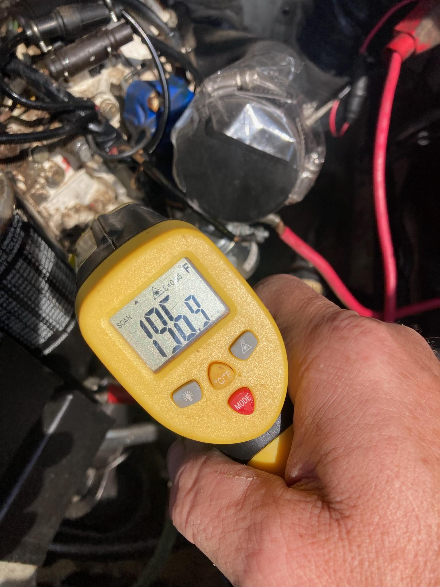

          That omc 140hp is out on tupper lake area this weekend with my brother and the kids.. it does run hot tho! They are stopping every so often to let it cool off.

            Perhaps I missed something in one of your posts…But, how is it you are determining that the powerhead is running hot? Are you judging temp based on gage readings? If so, please know that these gages or often inaccurate and are affected by high battery voltage. Did you keep the water cooled regulator/rectifier from the original turbo jet powerhead? Or, are you using the simple rectifier only system that was on the older 140 powerhead? High battery voltage drives those gage readings up giving false readings…

              My brother took the sunbird w/140hp up to Tupper Lake . He just uses a laser temperature shooter to see what temp the block is after pulling the kids around on the tube.
              As far as charging… whatever the 1978 magneto puts out is what we have. All 78 on the block…
              The exhaust system has a lot of rubber hose.. and you can smell its hot.

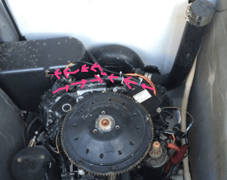

                I wonder if some of the water that is supposed to escape from the top of the heads is directed toward hot spots in the exhaust….Not too familiar with the turbo jet cooling schematic… Have him check temps on top of the heads and on the exhaust manifold/cover on the back of the powerhead…

                    I would leave it the way it is, but find a turbo jet cooling schematic, the drill/tap the current heads…Do you know where the water from the heads is supposed to be directed? There must be some port somewhere that is plugged off because this is missing….
                    #245821
                    Beno
                      Yes sir, I do know where it is supposed to go… the two rubber lines merge in a T then go to the Baffle – muffler affair on the starboard rear of the boat… see pic of some boston whaler with turjet.. the pink likes show water flow direction.
                      we plan to tap the water jacket covers on the heads.. that way we can just remove the gasket covers and not actually have to go down the whole remove the heads route. new head gaskets..etc.
                      the water jacket covers provide the same access to the same waterway path.
                      path
                      #245847
                        Like I said, there is not much room under those water covers for drilling/tapping
