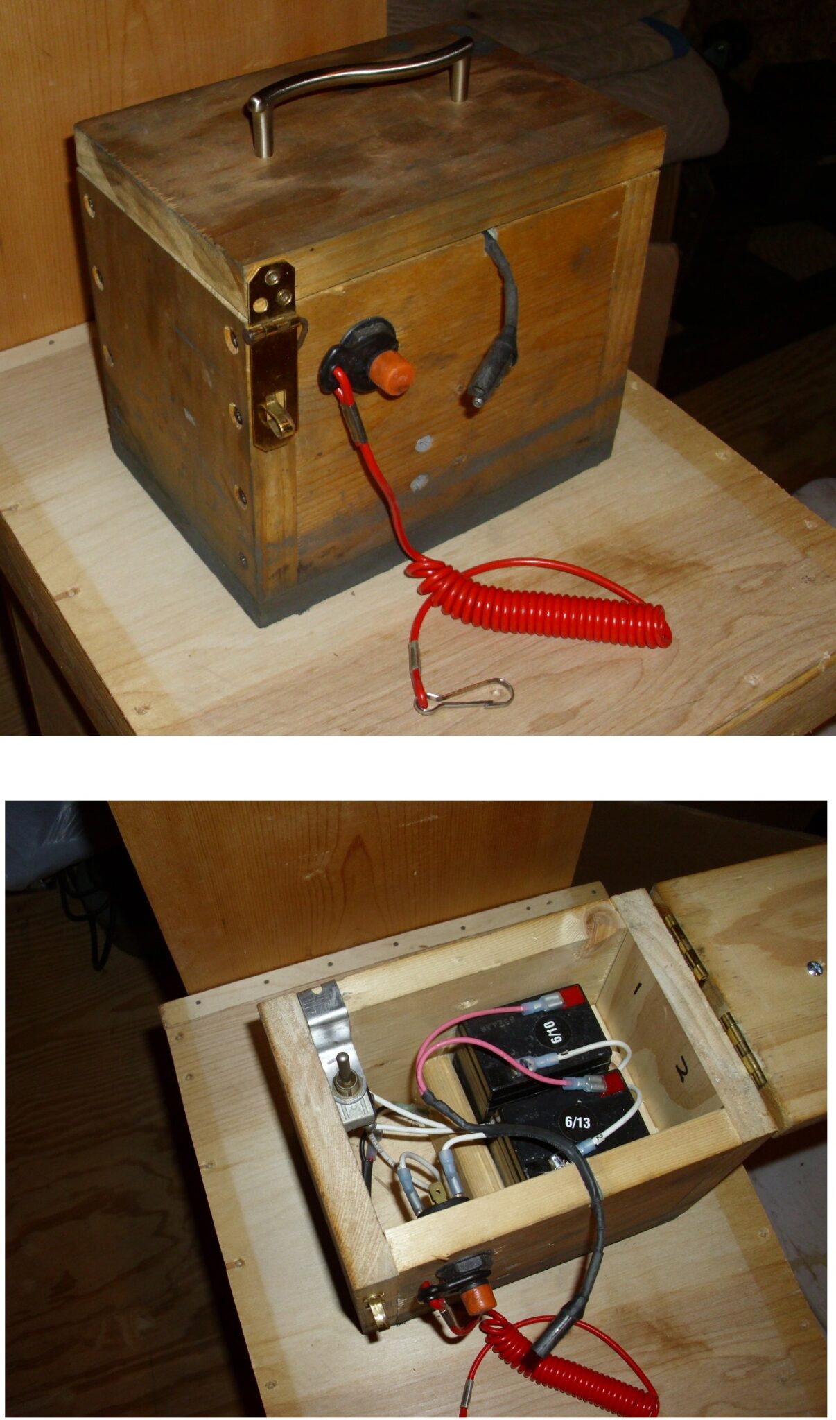

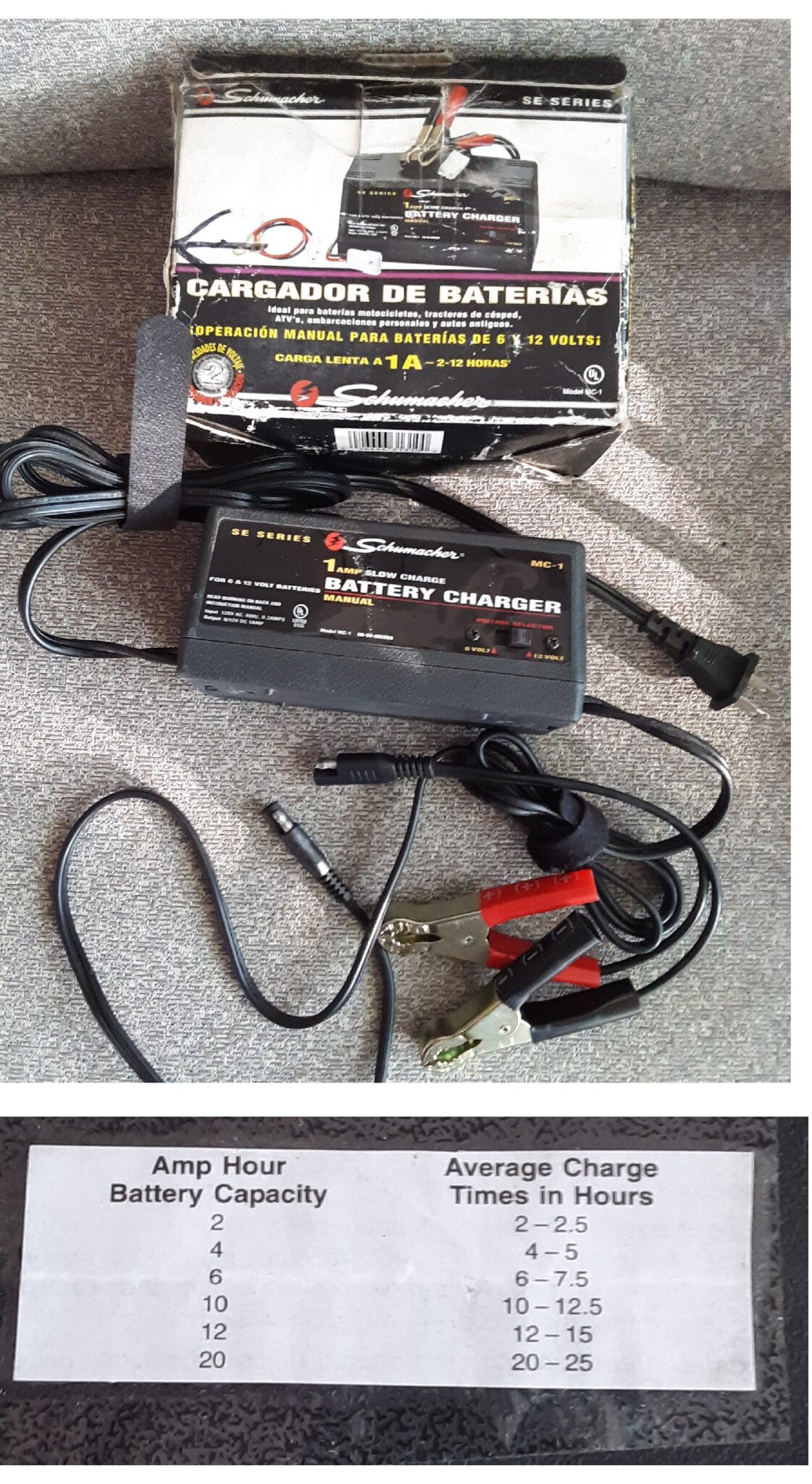

Box is just 1 by screwed together with dry wall screw. Handel is from a home improvement store. Need to pre. drill holes. On-off-on toggle switch. The lanyard was for some youngsters I was going to let run a Speedster. This is the charger I use. Came with a 2 wire plug that I have on all my motors and the battery box. Can only charge one battery at a time and the switch must be on, on the battery your charging. I believe the charging rates I have on the charger are from the manual. Used MC-1 chargers are on eBay. Search for Motorcycle, ATV, Lawn Tractor battery charger if you want something new.
