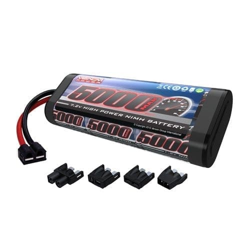

January 10, 2019 at 6:49 pm #162714I like to use the 7.2V NiMh hobby batteries. Easily rechargeable, lightweight and inexpensive. A 5000 mah will last quite awhile. I carry two charged batteries in the battery box with a Traxxas plug on each, and a mating plug wired through the walls of the box to the external posts for the coil wires. The extra voltage doesn’t seem to hurt the points either and makes for a nice, hot spark.

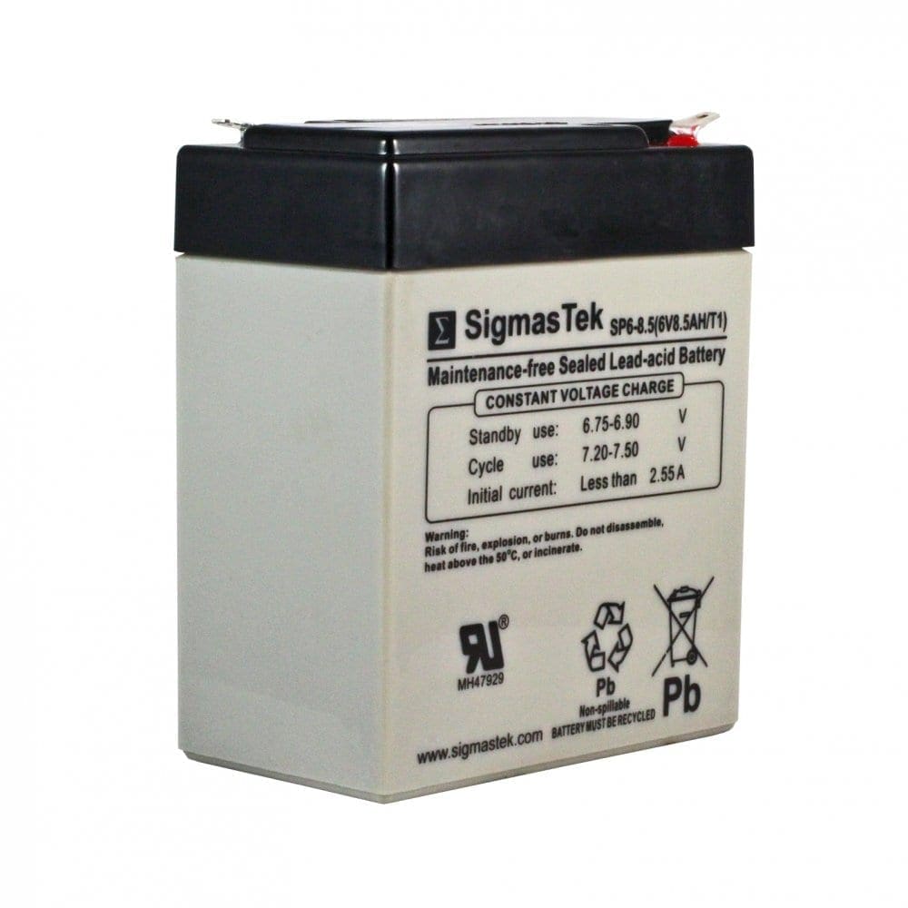

January 10, 2019 at 8:39 pm #162726A couple of battery examples below.
https://www.batterymart.com/p-6v-8_5ah-sealed-lead-acid-battery.html
https://www.amazon.com/dp/B004A8V3D6/ref=sspa_dk_detail_1?psc=1&pd_rd_i=B004A8V3D6

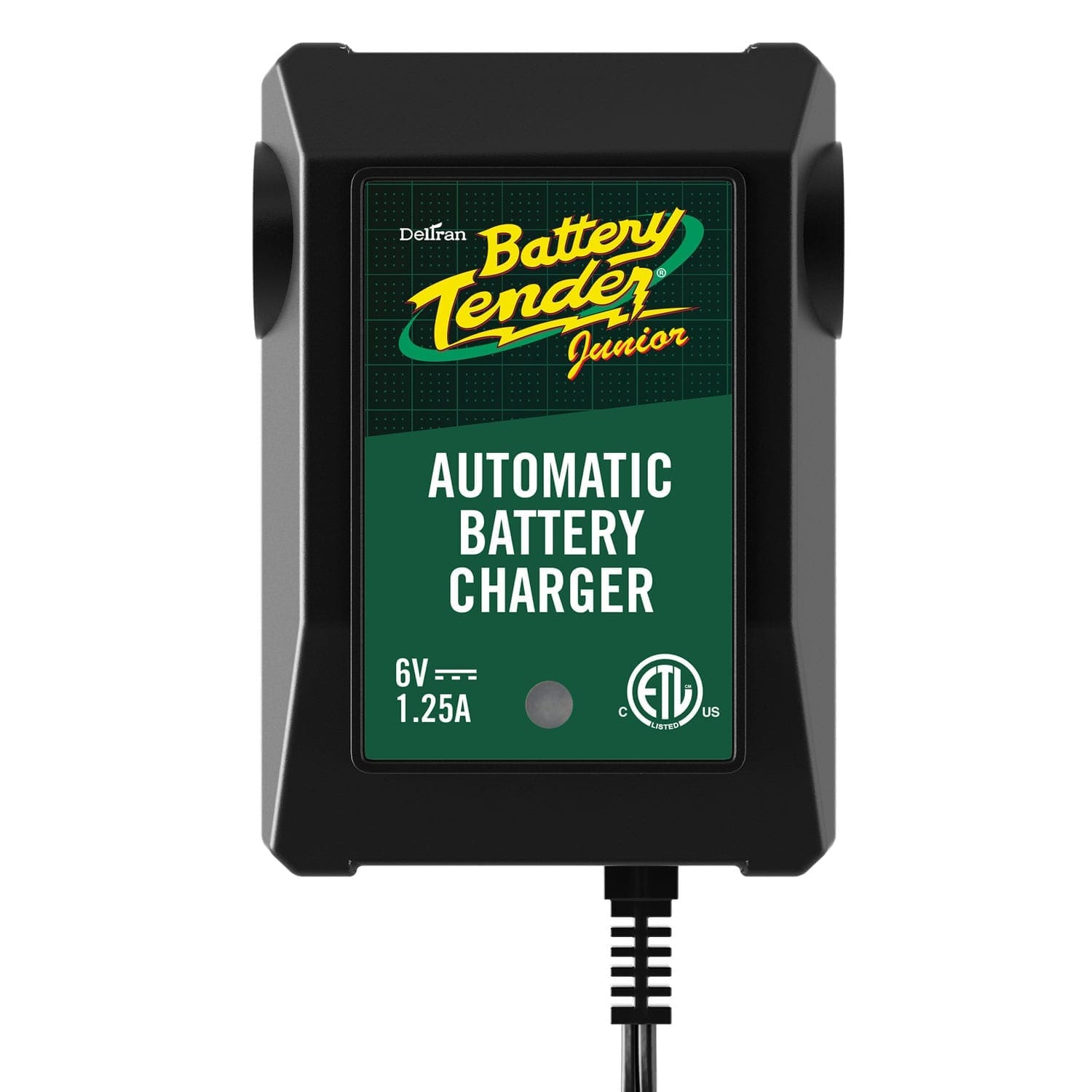

A couple of good chargers for above batteries.
http://products.batterytender.com/Chargers/Battery-Tender-Junior-6V-1-25A-High-Efficiency.html

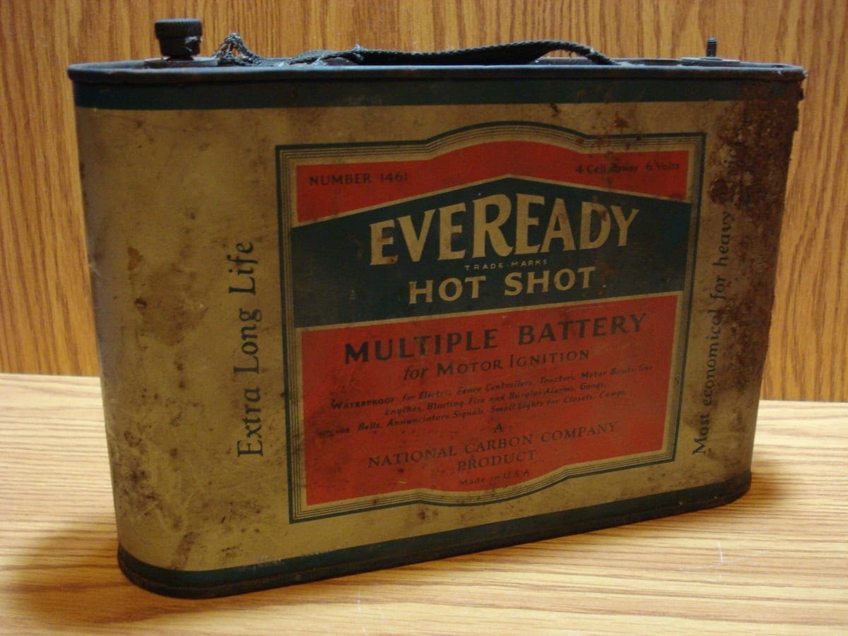

January 10, 2019 at 9:57 pm #162737Back in the day we used a 6 or 7.5 volt Hot Shot dry cell battery. it was used in a lot of alarm systems. Steve woods has made a “D” cell container from PVC pipe that takes four or five alkaline batteries. Replacement batteries are available every where. Of coarse the lithium is more expensive, but if you run a lot it will save you in the long run being rechargable. . .
