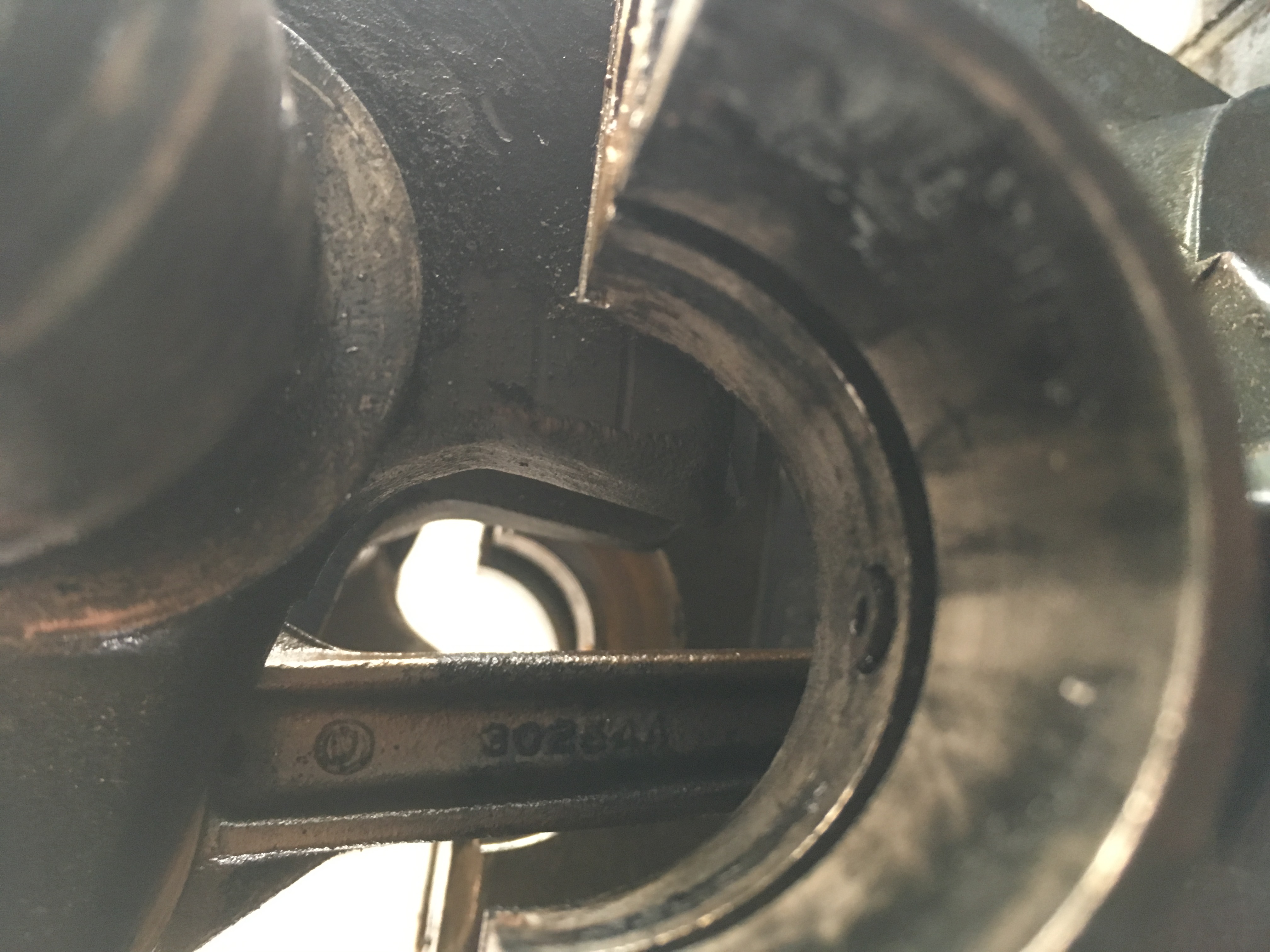

      These pins keep crank bearings from moving in crank case.They look to be pressed or threaded into crankcase casting.Any body ever have to replace one?Are they available?You can see one is considerably shorter than the other,and barely engages the bearing.

        They are pressed in after the Assembled crankcase is line board for the bearings. They are not available because pushing them in further would require high torque on the main bearing bolts with the bearing misaligned which could seriously warp the crank case and causing problems with sealing & alignment . . . 😎
        #83964
          For what it’s worth, I had one that got pushed in too far, one time. I cut some threads in the hole with a small tap and was able to pull it out with a screw. I cleaned it all up and was able to reuse it. Gary is right, I am sure…the crank case probably didn’t like it….but I don’t remember any problems from having done what I did….All that being said, as long as there is enough still sticking out on yours to keep the bearing from turning, why mess with it?

            When I say barely I mean,"maybe it will or maybe it won’t".With the o-ring on the bearing it doesn’t catch.After every thing is bolted up,maybe.Instead of pulling the pin,how about tapping it and putting in a small brass screw,then filing the head to fit?

              I would sure go with Bill’s solution…These things are only there to locate and secure the bearing race so it won’t rotate in the block. Yes, oil does pass through some of them, so be sure passages are clear….
