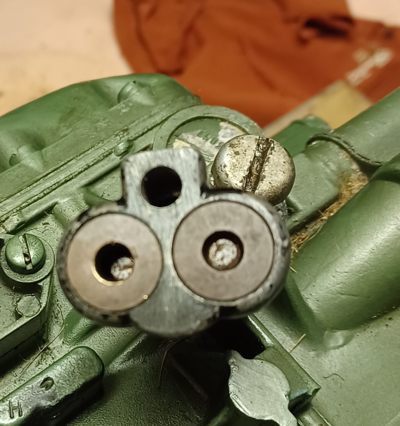

    outboardnut
      Before I screw up-
      Can I stick an end of a coat hanger and push from the inlet side to loosen the spring in there?
      The plunger thingy is stuck down in there

        Probably has a chunk of debris in there, like a piece of o-ring, for instance.

          There is nothing preventing the plunger from coming up.
          What is behind the plunger?
          Is there another O -ring?
          Should I take out the old o rings and heat the fitting?
          #264131
            Those parts are all loosey-goosey in there.  I suppose the spring might be rusted away.  Sure, poke all you want, nothing to really hurt.

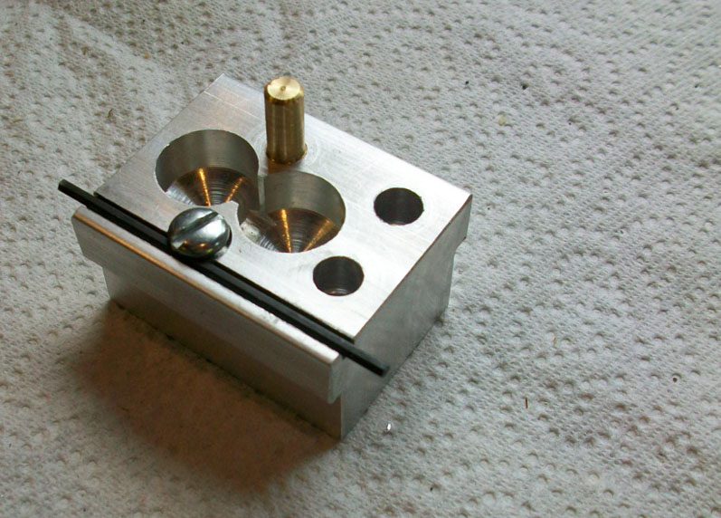

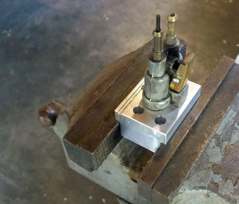

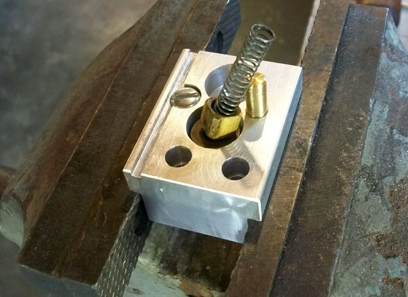

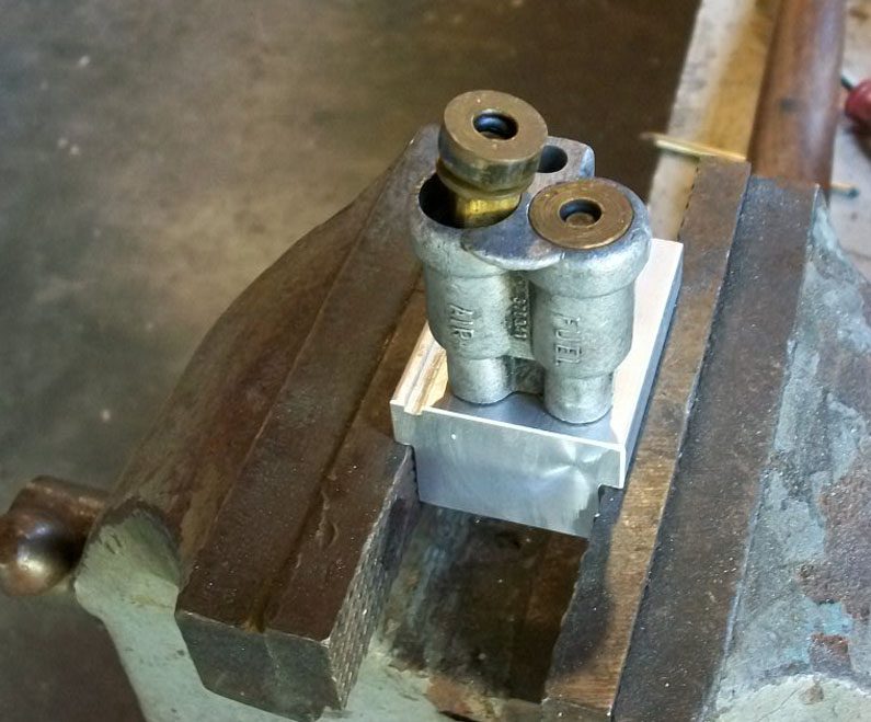

                I used to make these tools, now made by Richard White richardsoutboardtools.com

                #264147
                  I bought one of those tool back when Frank was making them. If you are going to be doing any work with pressure tanks, that tool is indispensable to have around. It makes an awkward job simple as pie.
