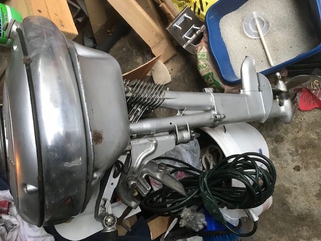

      Found a real nice Bendix Eclipse SMD at a garage sale the other day, looks like it should be a runner with out to much trouble other than I am not getting any spark. looking for a manual on this and also what kind of points I need to use for replacement. Appreciate any assistance or tips.

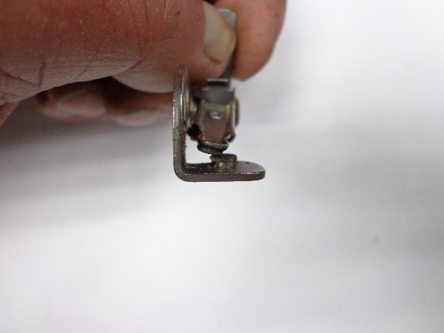

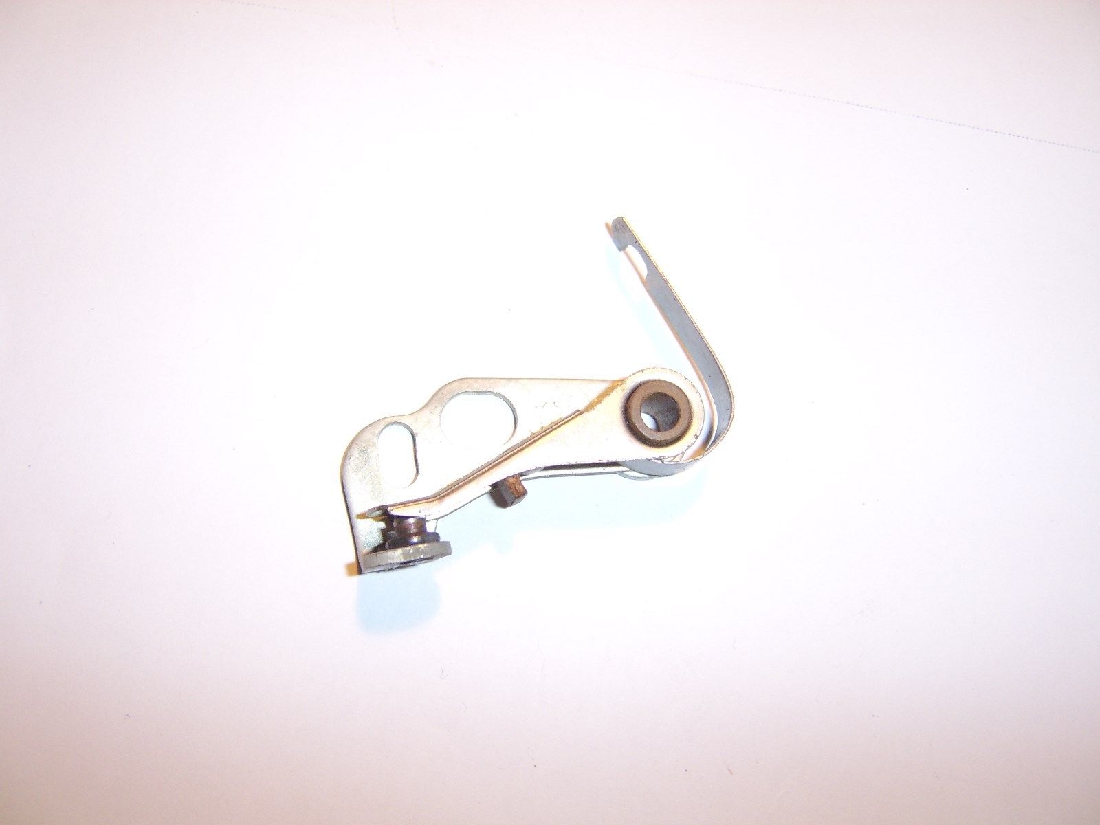

                  I found some sets of points on eBay (3) sets. I have some Bendix Eclipse so I bought them. These are Delco Remy D110. Listed as used on Checker & other GM product. Distinctive in that the two holes go around the points hold down screw & adjustment screw. I used Mumbles box to order some, but my auto parts store never got them in? Trying to send a pic, but may be small. Hoping Delco Remy might be better quality? These are very NOS, but in surprising good shape.

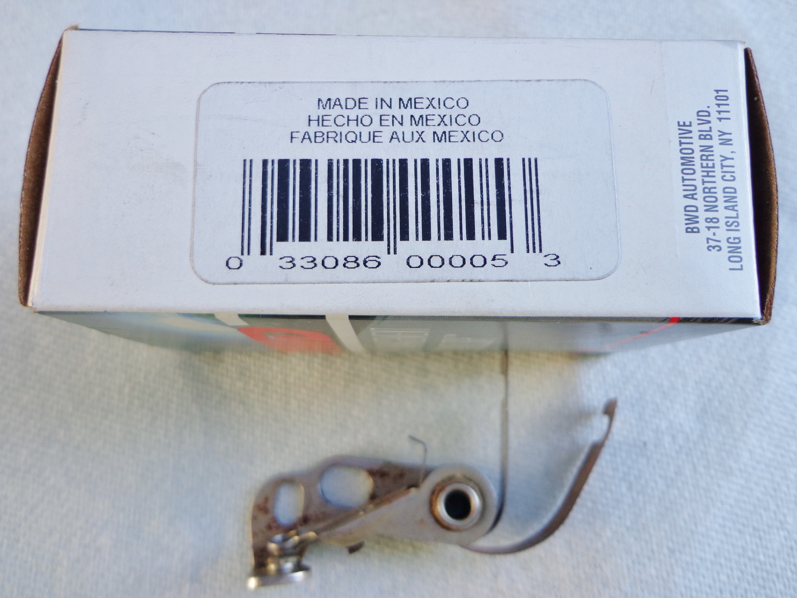

                      I found the points at local parts store they ordered them and were not cheap$14.00 so I made real sure I put the flywheel On correctly
