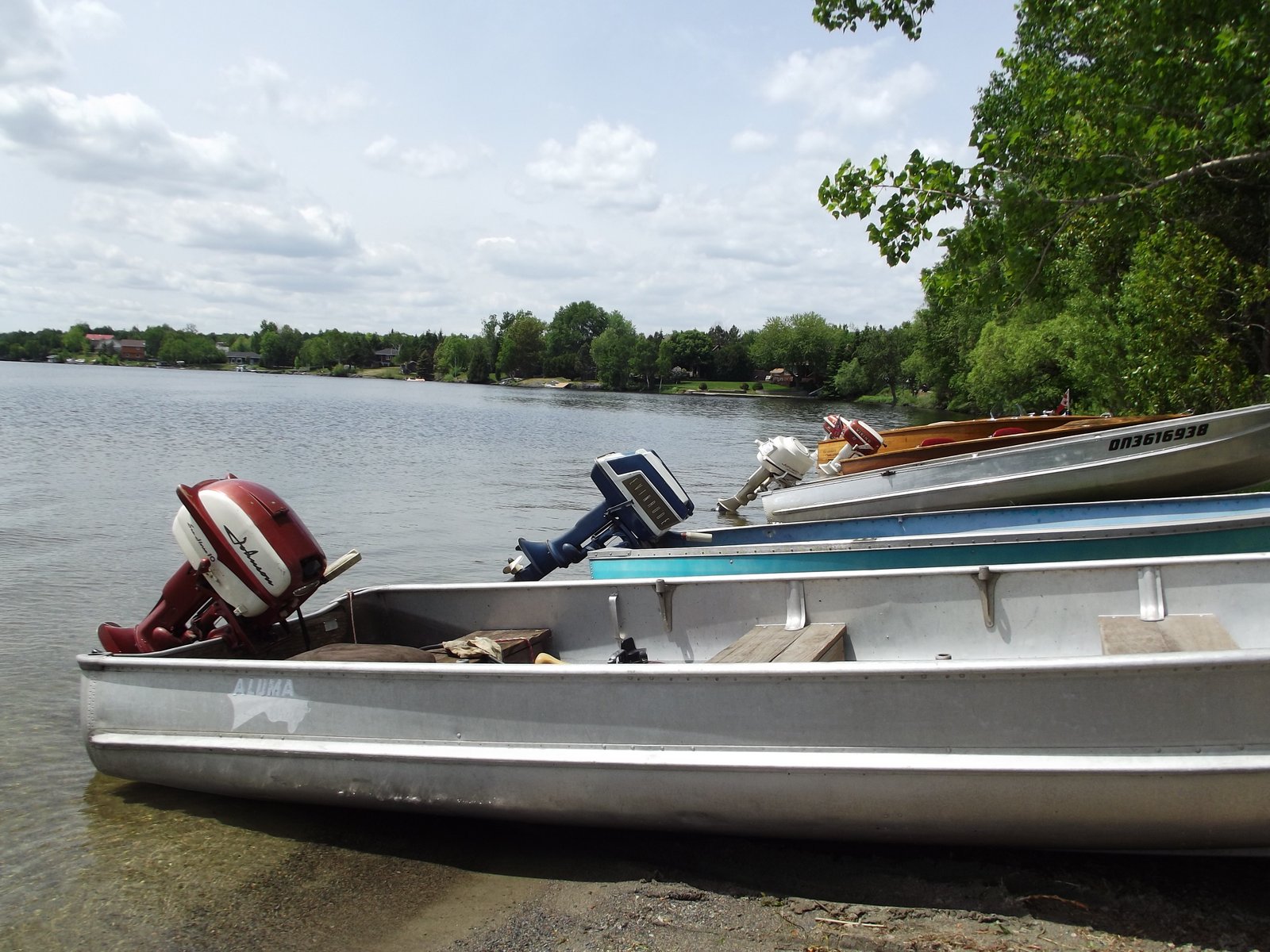

              Did 58 not have some improvements to the powerhead? Don’t remember the details, and then into the early 60’s as well. I really like the 58 Johnson styling, here’s mine on my Alumacraft FL. Got about 20 MPH out of it, which I thing is pretty decent.
