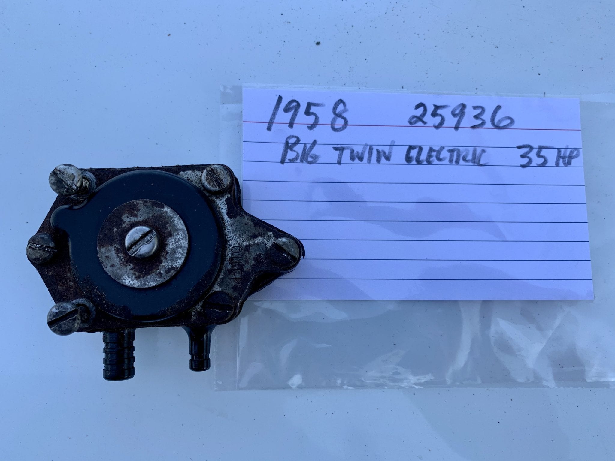

      What’s the best way to go in repairing/replacing a fuel pump for a 58 Evinrude big Twin? Seems like the repair kit is more expensive than a new pump, if I remember correctly.
      IMG_2706
      #200562
        That is not the original pump. Besides, I don’t think there is a kit for the one you have. But no matter, as you suggest, there are Chineesium pumps out there now at cheap price.. I have no idea what their quality is.
        #200607
        76-j
          Make your own DIAPHRAGM___ needed is BUNA N rubber, having a thickness of .015
          #200792
          davidk
            I took it apart again to look at the pieces. I see what you mean. I’ll give that a try, thanks!
