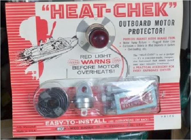

        These old school temperature warning lights show up occasionally on Ebay and the sensor goes under a head bolt. An aircraft supply might have something similar.
        Temp-Light
