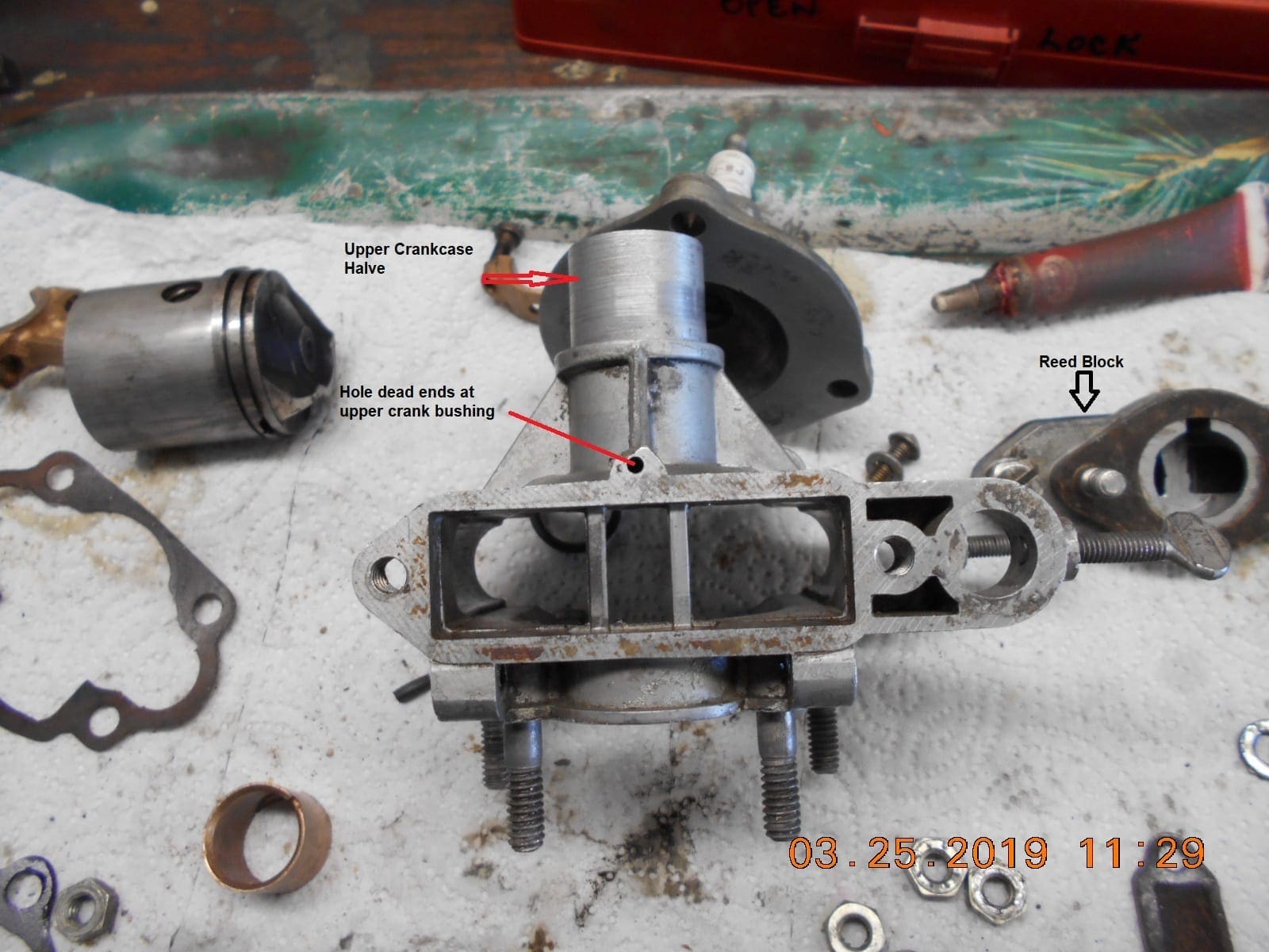

      Working on a 1956 Mighty Mite, and replaces the top main busing
      with one I had the of the correct OD, but had to bore out the ID.

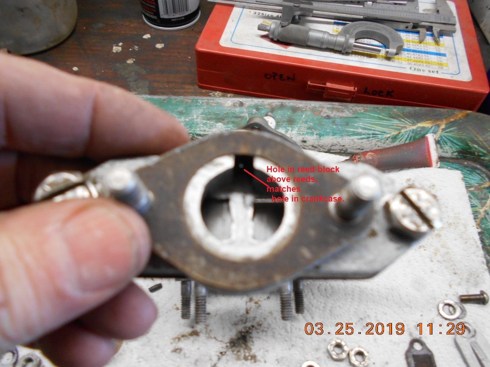

      After I installed the new bushing, I noticed a small bleed hole
      in the reed block housing, above the reeds, that matches a hole
      in the upper crankcase half. When probing the hole in the crankcase,
      it dead ends into the new bushing. There was no hole in the old
      bushing that matched up. There was a channel on the OD of the
      bushing, that ran the length of the bushing, but from all indications,
      it was turned 180 degrees opposite.
      Not sure if the old bushing was installed wrong, or if I screwed up
      marking it.
      What’s the purpose of this little hole in the reed block? to the crankcase?
      Does it re-burn excess fuel, help the reeds close, or what?
      Thanks!

          Frank, thanks for the interesting thought. If I drilled thru the bushing
          thru the pilot hole in the crankcase, it would only be an 1/8″ up
          from the bottom of the bushing, but perhaps that’s all that would
          be needed to get oil into the bushing, which is close to 1-1/2″ long.
          If the old bushing was installed wrong, or never drilled, that might explain
          why it was “wore out”.

              Garry, there was a groove machined in the outside of the bushing, that did
              not go all the way to the top, and would have had no way to get oil to the inside
              of the busing. Also the way the old bushing was installed, it was 180 degrees
              turned from the bleed hole,
              I stuck a drill bit in the crankcase bleed hole and drilled thru the bushing.
              Can’t imagine it will do much, but maybe better than nothing.
              Thanks.

                  Frank, if the old bushing was turned 180, the groove on the outside of the bushing would
                  have aligned with the hole from the reed box, but it would have just been
                  a passage into the crankcase, as the groove didn’t go to the top side
                  or into the bushing, hence I don’t see how it could have aided in
                  lubricating the bushing. I may have to buy another 1956 Mini Mite to
                  see how it’s put together, lol. The bushing was not oillite.
