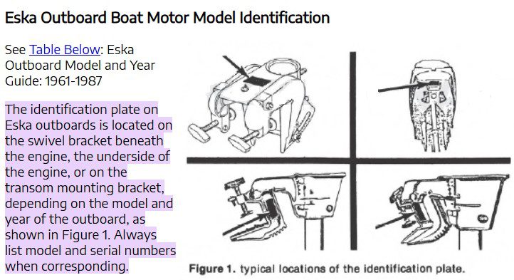

        Try this:
        Screenshot-2024-11-04-204837
        MY guess: If it has a water inlet ram tube coming out of the underwater exhaust outlet (Facing the prop), it likely is a 3hp.

          Thanks Frank.  With help from the diagrams you posted, I found the ID plate at the top of the transom clamps after removing a think dirt buildup.  I have a model 100,  1961 3 HP.   Not really a motor I actively seek, but I don’t often turn down freebees!
