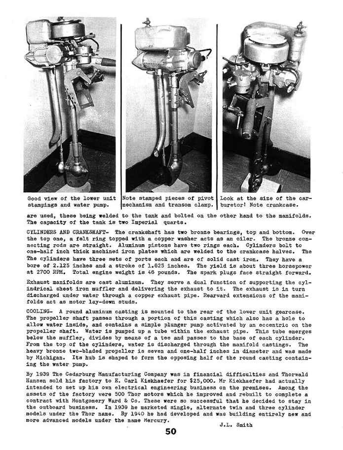

        This page shows the B&S for the opposed twins
        Thor-Opposed-Twin-pg-3
