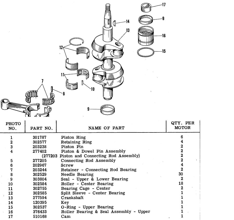

      Hello friends I have a 1956 15 hp Johnson I want to replace the bottom crank seal. Cant find parts on Marineengine but I replaced the seal 303804 On my 12 hp buccaneer Im almost certain its the same seal. Could someone verify it will be the correct seal ? 303804 It seems to translate to Sierra 18-2060> I also need the part number for the powerhead gasket

        #190584
          303892 on the power head base gasket

                    Here’s the ’56 FD-10 parts manual in PDF for you to download . Enjoy!

                        Thanks Mumbles !!! I had to get my sweet wife to do that for me lol . She printed them for me !!
