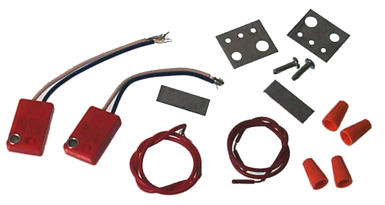

            What you want are the RED Atom Modules for your outboard.

                  Anybody have any idea what the difference is between those red ATOMs and the brown ones like I have? I’ve seen the ATOM literature and that company sure seemed to think there was a difference. The new ones I see from other companies are advertised as "one product fits all."

                        I read all the pages linked to about the Atom. Nothing there (unless I missed it) that explains the difference between a red module and a purple module and it seems the ones being copied are based on the red.
                        I have a bunch of new-old-stock Atom brown modules and am wondering how they differ from the purple. # 209 brown is listed for two-stroke chainsaws and trimmers, whereas #7 purple is listed for outboard motors with fixed timing. Seems going by the description – they both do the same thing.
