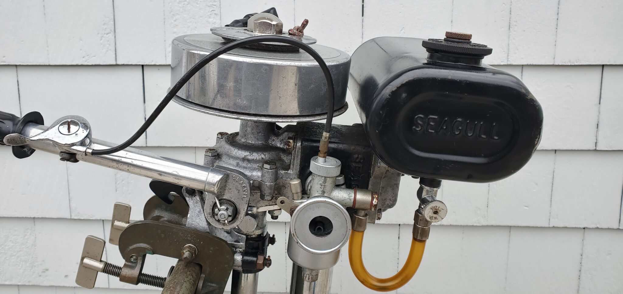

                I sold this motor but would like to help the buyer solve this problem. The brass piston inside the carburetor throat was not closing all the way. Earlier on, the motor was shutting down as it should. I do recall adjusting the location of the throttle on the tiller handle sometime prior to the issue.
                After looking through some literature, that was kindly sent to me by cajuncook1, there is a very specific design location and orientation of the throttle, and mine was set too far towards the tiller grip. I’d like to readjust the throttle and see what happens. The cable adjustments didn’t help, and the keyed carburetor cover is positioned correctly. Service sheet no. 7 in a service manual shows the center of the throttle to be only 2 1/8″ from the tiller tilt bolt. I tried to post the manual, but the file is “too big”.
