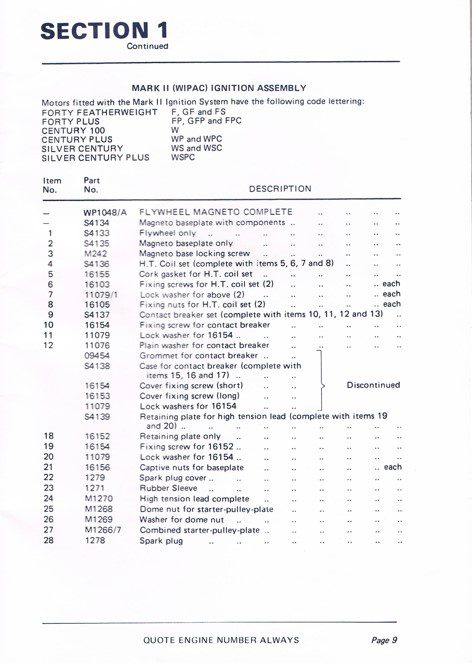

              #264241
                Takes a 1278 (D16)   Item 28
