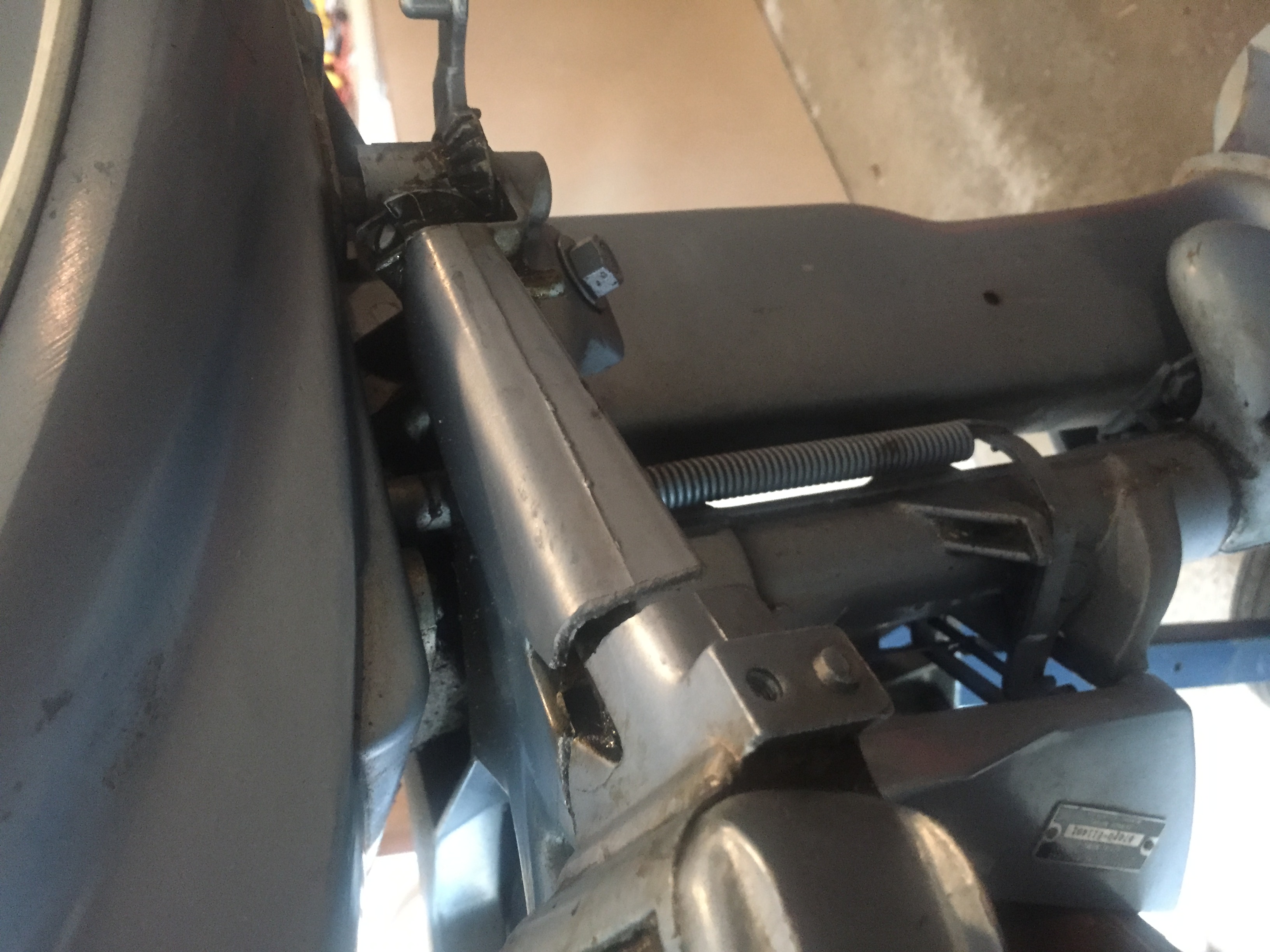

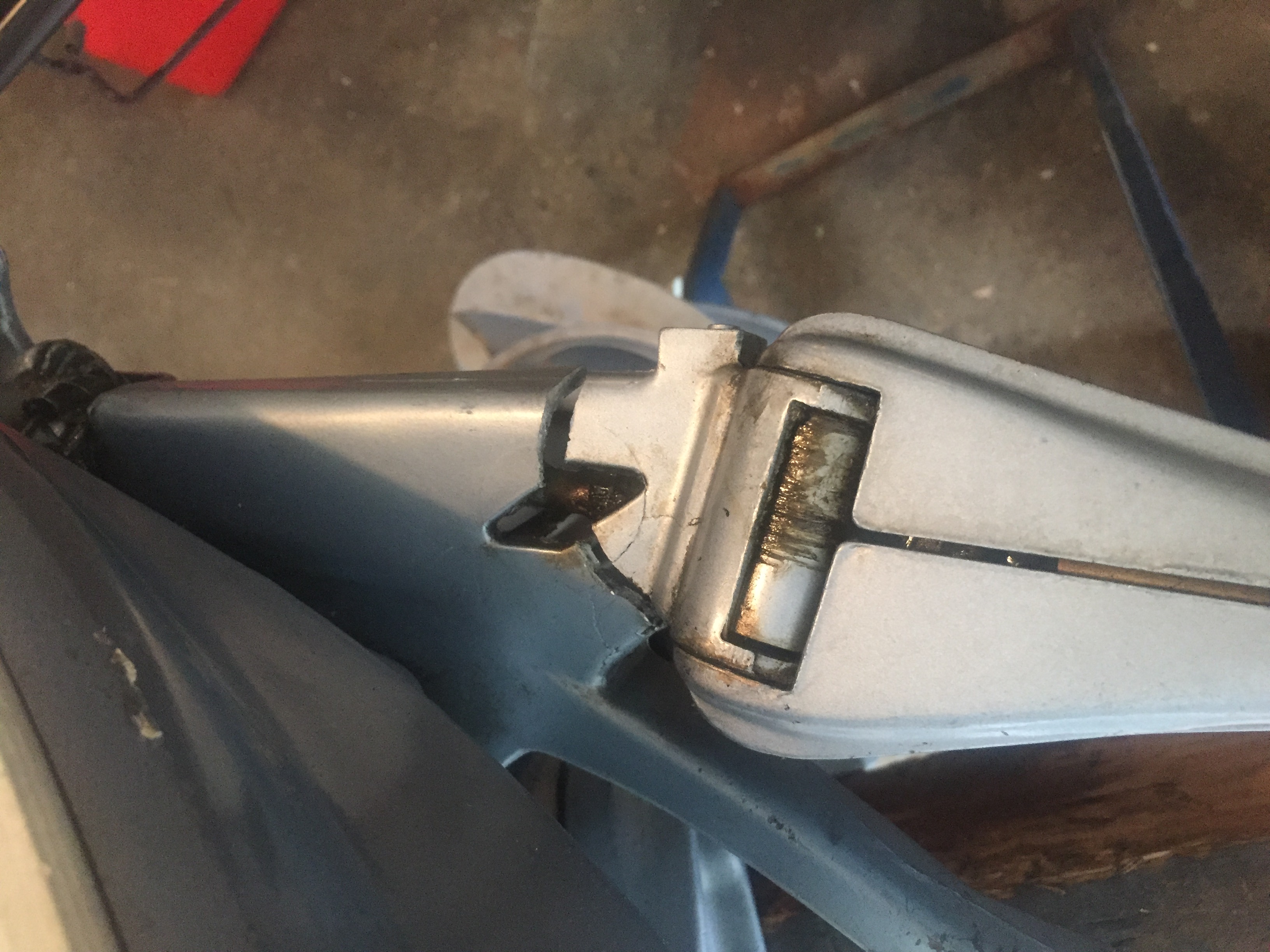

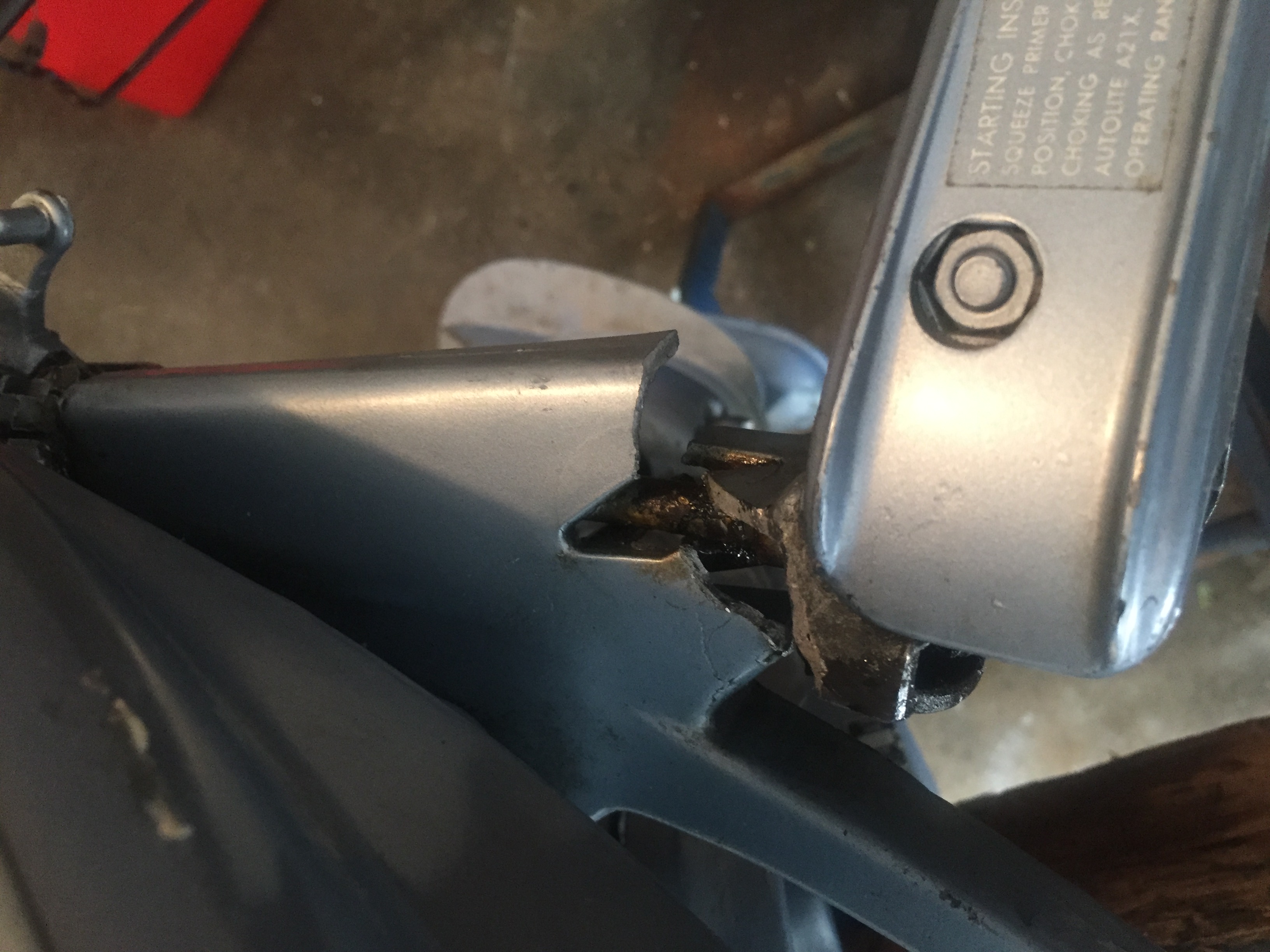

      I have come across a 1967 6hp Evinrude in very good condition. With the exception of the steering bracket. Evidently, somewhere down the road, someone must have pushed down on the tiller arm, probably in a river, and the bracket broke aft of the hinge.
      To weld or replace?
      If replace, how does it come off? Pull powerhead? Lower unit? Never did one.
      Thoughts?
      #79782
      twostroke
        You gotta’ pull the powerhead to replace it as I remember. I’ve see a bunch of them TIG welded over the years…..they work fine, but ain’t real pretty. Should be pretty easy to find from one of the ebay cannibalizers.
        Jim
        #79786
          Unless I am sadly mistaken, you do not have to pull the powerhead. Remove the clamshells from the lower mount and the nuts from the upper side mounts and the nut from the upper front mount. Remove vertical throttle shaft and disconnect gas line.
          Now swing the lower unit aft and lift the whole motor up and away from the steering bracket.

                I’m sadly mistaken with you Frank…You don’t have to pull the powerhead to replace the steering bracket..
                But, I guess if it was me, I would go ahead and pull the powerhead/gearcase at this time to do the water pump and check powerhead seal components…
                Looks like a nice motor otherwise…
                #80220
                rjoynt
                  Done!!! Learned a lot. The nut under the motor just has to be loosened, easier if you remove the pivot arm above the throttle gear. But done in 3 hours, faster next time!
