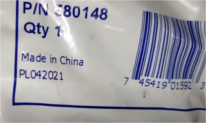

      For many years, OMC/BRP had their 580148 ignition points manufactured in Turkey and they were of consistent high quality. Then suddenly, almost overnight, the quality disappeared and I don’t know why.
      OMC-Points-China

        I found the same issue on my last couple restoration projects. The points previously fabricated in Turkey always fit perfect but the latest versions just don’t fit properly. I’ve always replaced the points as part of my routine tune-ups but I think from now on, I’ll just clean and re-gap the old points if they are in decent shape.
