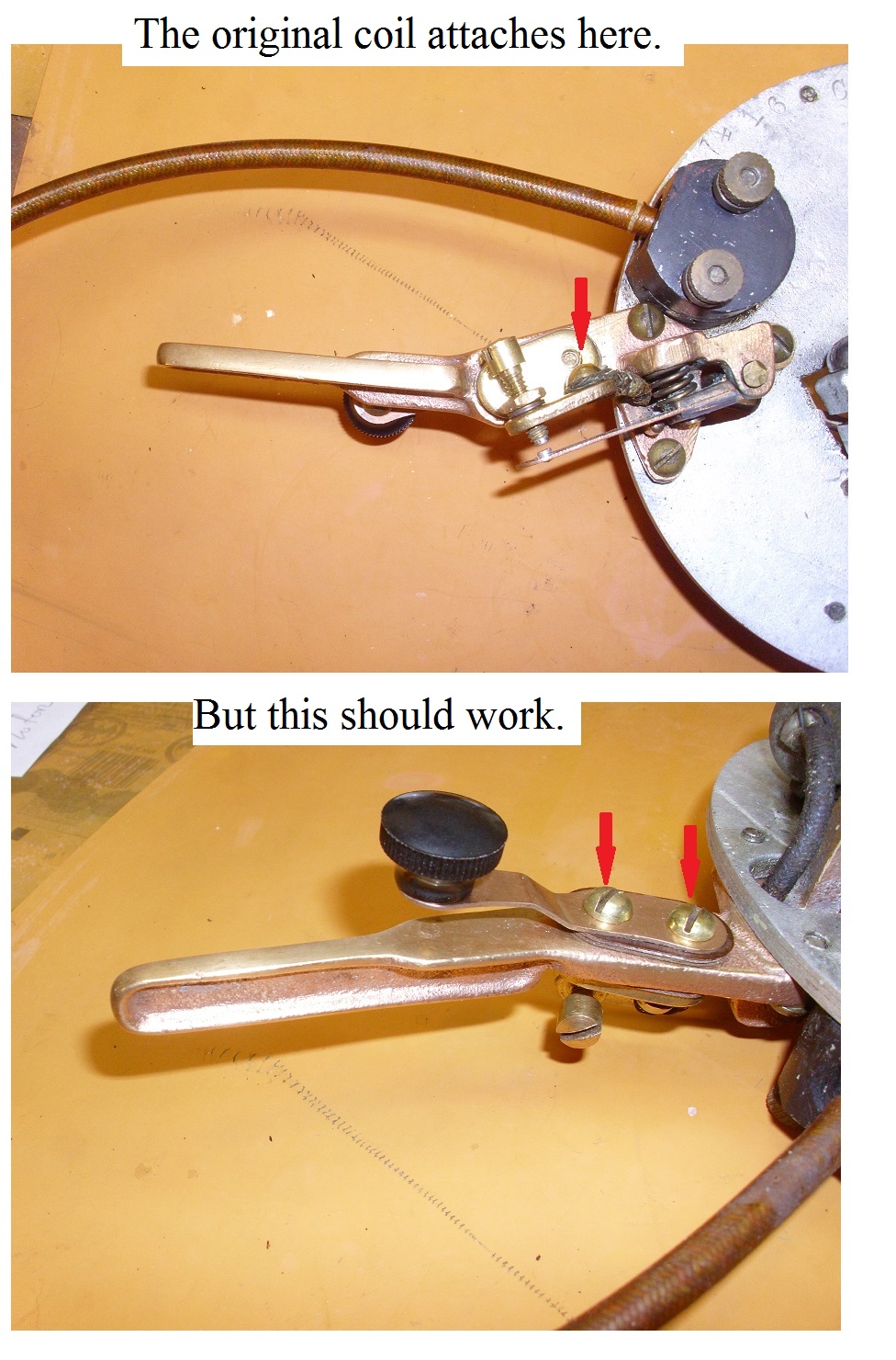

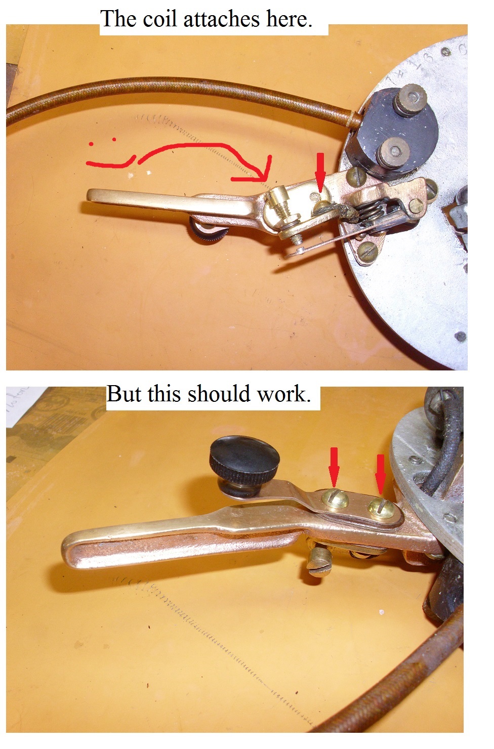

Hello all–I made up a Buss Box to run my 1919 Evinrude row boat motor–three wires to the motor from the box–one to the spark plug—one to the ground and one to the points—QUESTION: where do I connect the wire to the points from the buzz box? Sincerely, Bob Watson, Key West, Florida–Phone: 305 292 4821—Email: bwkeywest@comcast.net

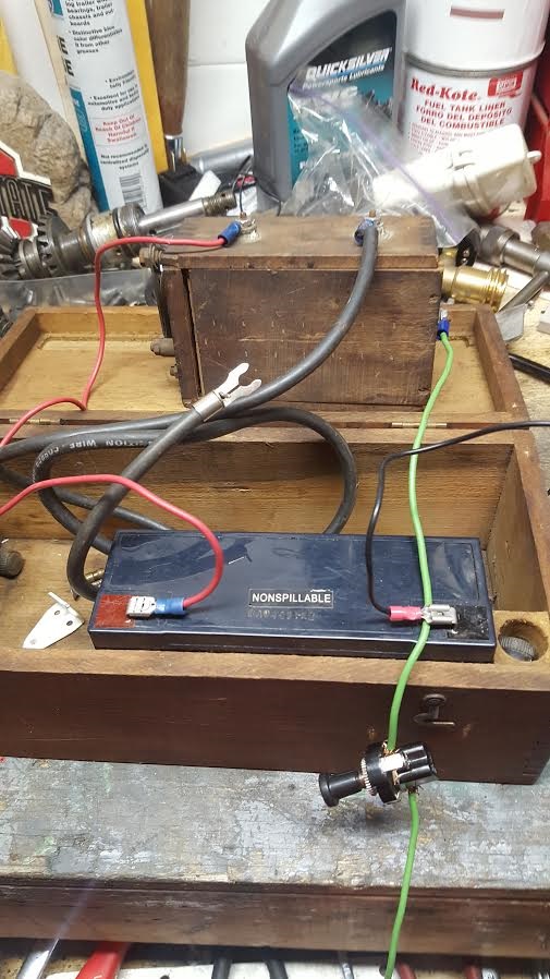

March 14, 2017 at 9:03 pm #54331Ground from battery to ground on motor, usually on the right side of transom.
Green wire from bottom of buzz box to points,
red from buzz box to battery positive
Plug wire from buzz box to spark plugSee attached photo
Oh and unless you like getting "buzzed" don’t touch the plug end while engine is running…..trust me…LOL

classicomctools@gmail.comMarch 14, 2017 at 10:37 pm #54339Sorry–I`m not making myself clear—"WHERE" on the points do I attach the wire from the buzz box? Sincerely, Bob Watson-Key West, Fl.–Phone: 305 292 4821

March 15, 2017 at 1:06 am #54344March 15, 2017 at 1:08 am #54345Also remember you MUST disconnect the stuff under the mag….MUST
