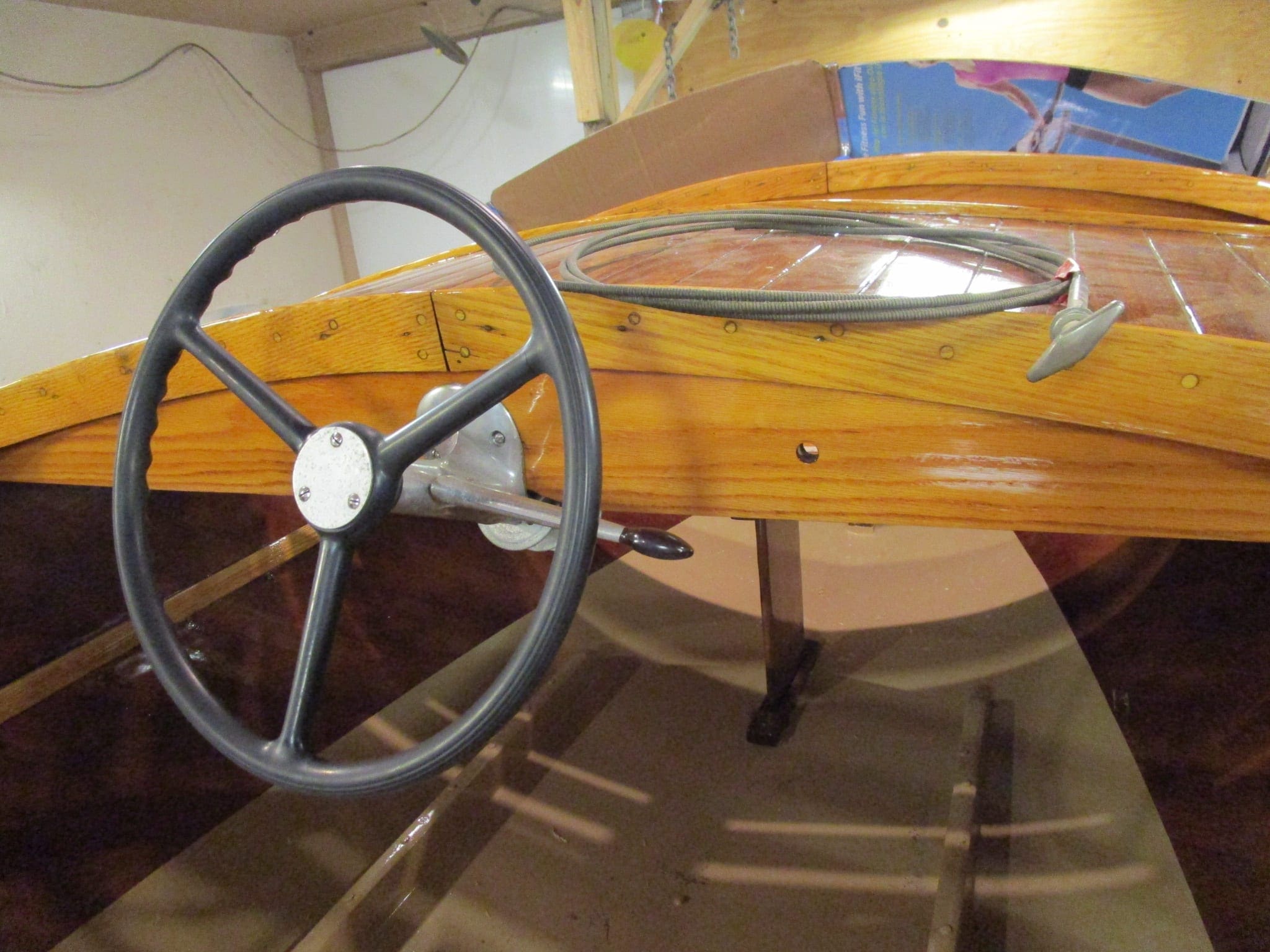

              Samuel Phelps
                I have a question about my steering bezel . There is a lever on the side which I presume is a forward reverse lever . I also have a push pull type cable set up that I guess is for the throttle.
                With the Speeditwin having no neutral/ reverse could the lever on the steering bezel be used for the timing lever on the motor somehow ?

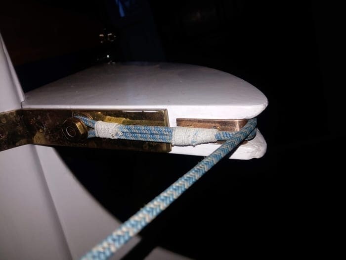

                russonz
                  Regarding tying off Dyneema. For race boat use our regulations say it must be double clamped but for recreational use I would use a half hitch and a single ss clamp. Alternatively I have used it as in photo of Dyneema on a small boat I own. Regarding sun damage it is uv protected. Here in New Zeland we have very high levels of uv due to our geographical position, much higher than Florida and it’s performing well. I think uv damage would become apparant on the outer layer long before the inner layer strength could be affected. I like it.

                  Samuel Phelps
                    What size rope is that ? 1/4” ?
                    And are the clamps under the twine ? Reg cable type clamp ?
