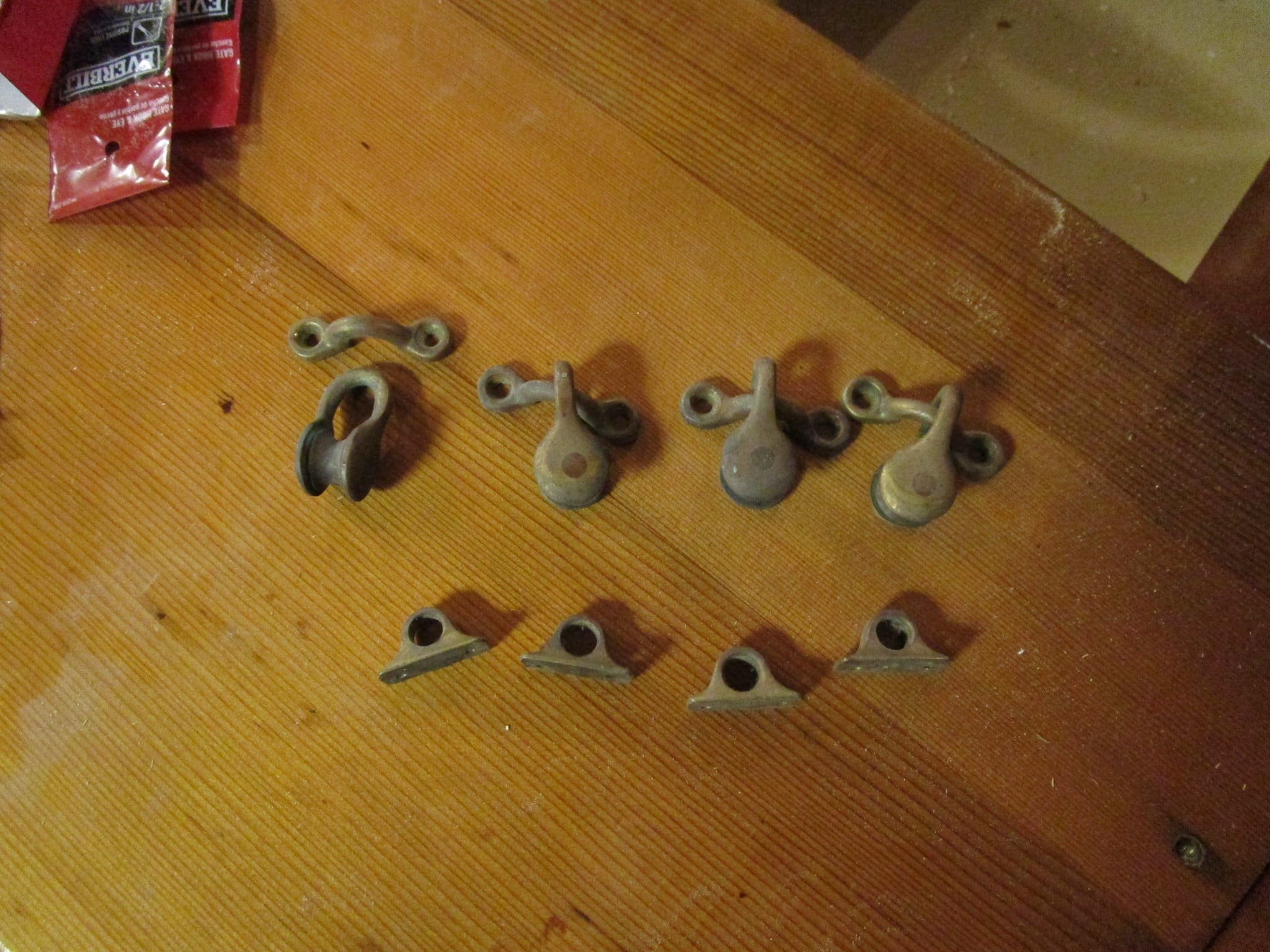

                    Here are the brass pulleys. The U shaped clips were screwed into solid thick wood under the gunnel cap with 1-1/4’’ wood screws .
                    D2796496-E80D-43DE-A1BD-B59EC3BD269F
                    The hull of my boat is probably 3/8’ cold molded veneer plywood . I hate the thought of a through bolt through the side of that but definitely want to be safe .

                      I’d use the hardware you have.If it doesn’t work like you’d hoped,you can easily change it.As others said,you should through bolt the the main attachment points.Sometimes you can bolt through a frame and avoid going through the hull.
                      #178436
                      amuller
                        If you use the type of SS wire rope with many fine strands, as used for halyards on sailboats, etc, it would normally be OK. But those sheaves look small to me. You can look up the minimum sheave diameter on line.
                        Do you want to use this hardware for authenticity, or just because you have it?
