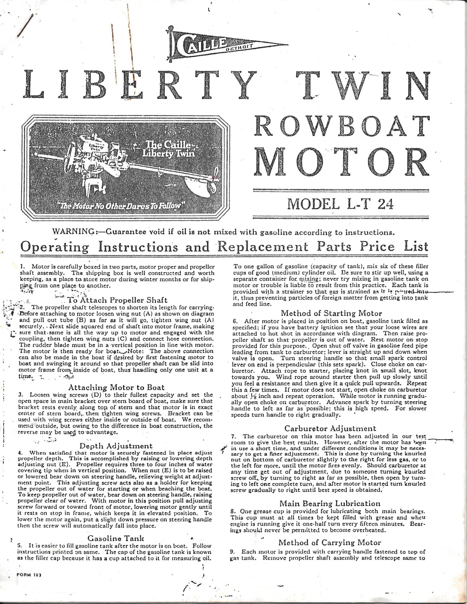

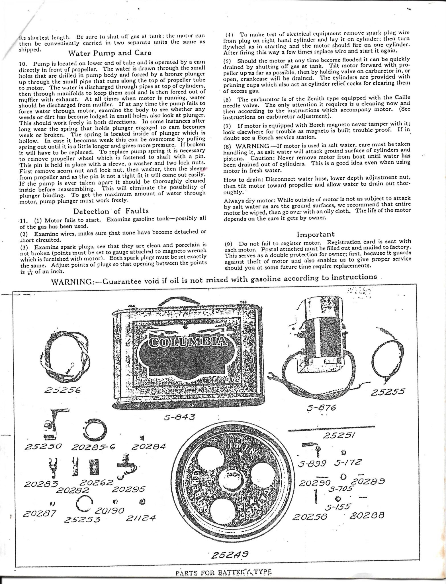

        MIKE SIMS
          I have this poor copy for the twin if it might help. You might reach out to Randy Kallevig the Caille special interest group leader.
          Caille3
          Caille4

          mas
            Thank you OldLure…that’s what I was looking for…do you think the Liberty single is the same as the twin?   I sent an email to Randy…no response yet.
            Thank you again,

              Hi all,
              I’m revisiting this thread in hopes of more information for “factory” starting instructions of the Liberty Single.  OldLure was able to provide very valuable information for the Liberty Twin, but after reviewing, there are enough discrepancies to cause me to further seek out the instructions specifically for the Liberty Single.  I could interpret and get close, but I would like to be more historically accurate.
              Maybe my request could be pass along at the different Chapter meets with the hopes of someone having this information?
