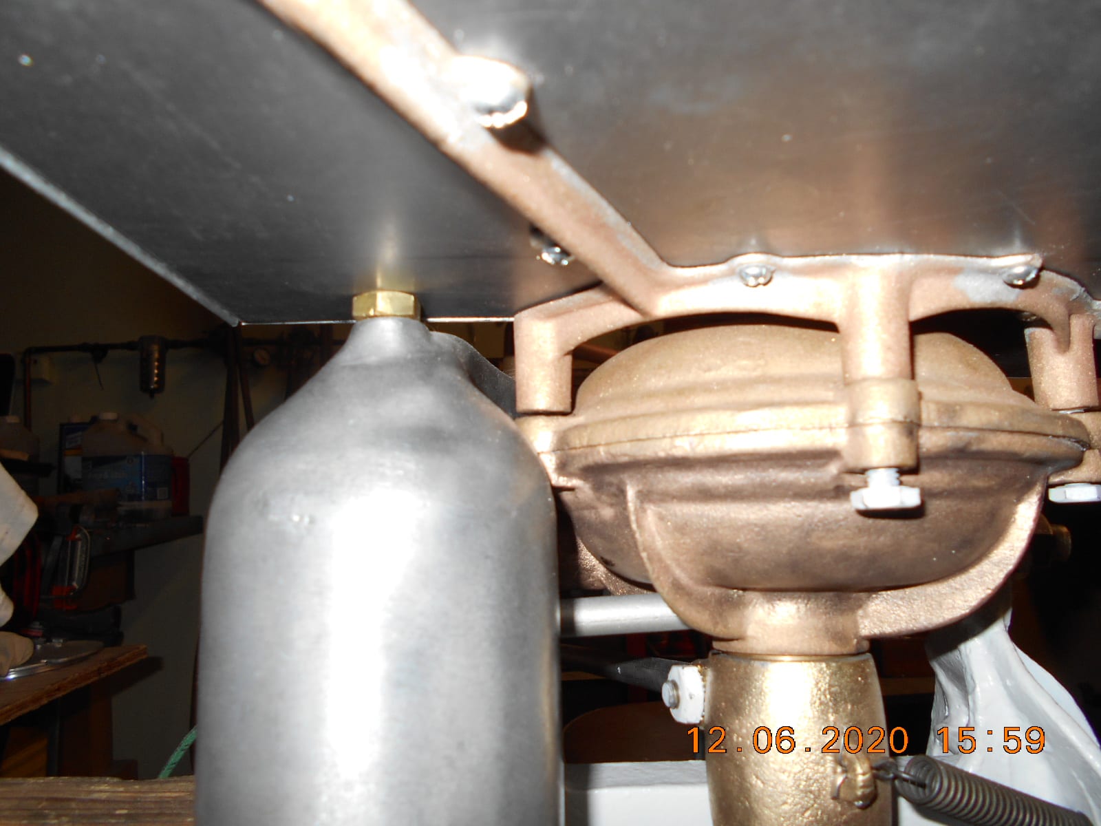

          A little more progress, or perhaps regress, this afternoon.
          I test fit the tank mount to the tank one more time while
          on the motor. Looked okay where I had it marked, so
          I drilled the holes, bolted the bracket to the tank, and
          test fit it again. It’s as least, or more square to the cylinder
          that the original tank…… hard to tell.
          DSCN9923
          The bracket isn’t sitting down on the crankcase flange all
          the way on one side, as the bottom of the tank is hitting
          the top of the muffler canister bolt. Not sure if the bolt is
          original on the muffler, and no idea if there were spacers
          between the tank mounting bracket and the crankcase flange
          originally, as the tank was not mounted when I acquired the motor.
          Anyone know if there were originally spacers?
          I could shave down the top of the bolt 3/32″ or so, and would probably
          take care of the problem.
          DSCN9922

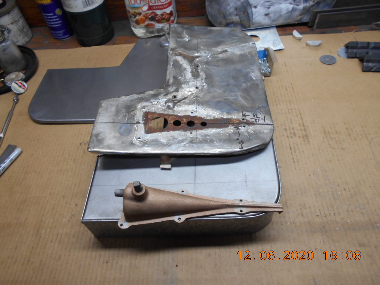

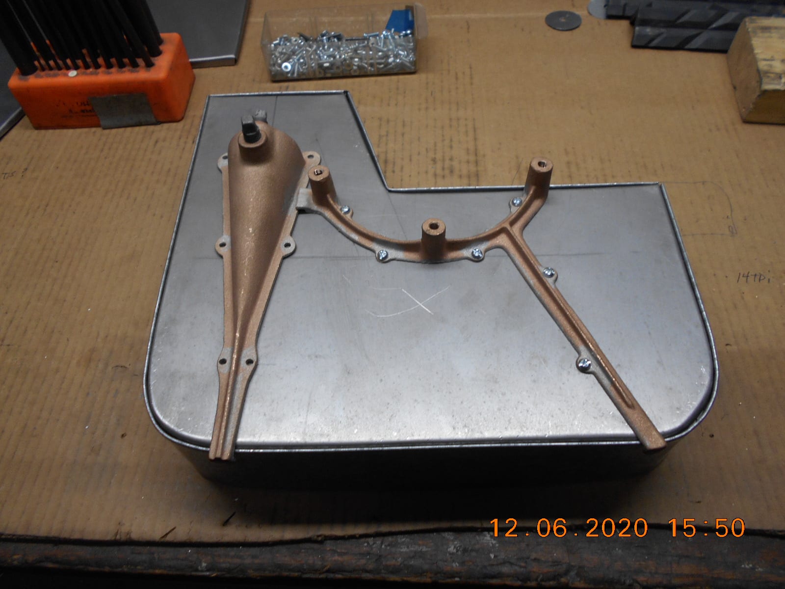

          I have not drilled the rivet mounting holes for the trough on the bottom
          of the tank yet. While I was thinking about it, I noticed on the
          old tank bottom that it has a series of holes drilled in the bottom
          of the tank for gas to get to the trough.
          I can’t see needing as many as holes as the old tank bottom had
          above the trough. Wouldn’t one hole suffice?
          Kind of curious what you did here Joe.
          DSCN9924
          DSCN9920

            The original and replacement tank on my Caille RBM needed to be shimmed up.
            #224421
              Thanks Tom, I’m more than likely missing original spacers.
              I’ll make up some brass ones about 1/8″ thick, and I should
              be good to go.

                JOSEPH BRINCAT
                  Spacers are good! …
                  Don’t know why all the holes? I suppose that one would be fine. But holes are easy if you have one of those handy cone shaped step drills that have one cutting edge, only way to go in sheet metal. if one doesn’t have a Greenlee punch set.
                  Joe B
                  #224454
                    Spacers are good! …
                    Joe B
                    Joe, sounds like I better tell Santa about those step drills.
                    I never would have thought they’d actually work, but
                    I’ve seen some guys on YouTube use them.
                    I have a well use and somewhat dull gasket punch set……
                    not sure they’d make it through the 22 gauge sheetmetal.
                    Will have to look up “Greenlee” punches.
                    Thanks!

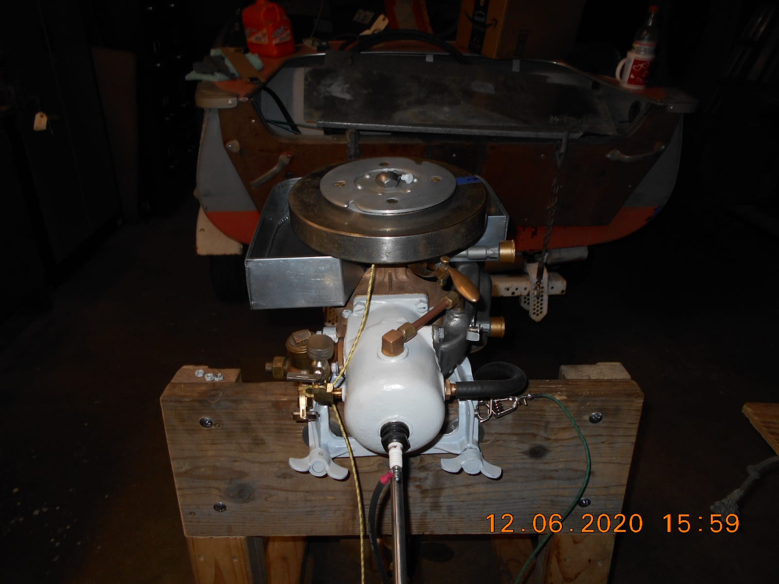

                      Tubs, you and Joe think alike. I’m not sure how far this motor will actually
                      tip up, and if you tip it up at all, you need a 5/8″ wrench in the boat.
                      Not sure how you land the boat at a shallow landing. 🙁
