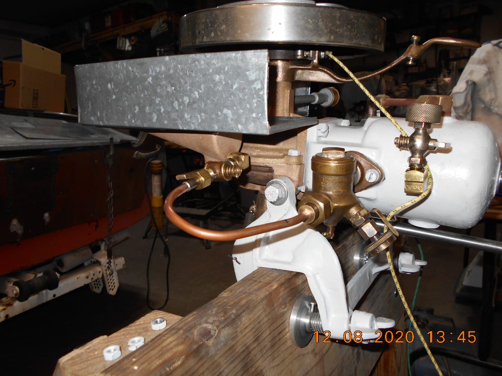

      I had no fuel tank petcock nor fuel line with the Caille when I got it.
      Not sure the mixer is correct for this model, but the bolt pattern
      and porting matches the cylinder.
      The only way I could hook up the fuel line is with an elbow on
      the tank trough.
      If I tried the petcock straight out of the trough, the fuel line would
      have needed too sharp of a bend.
      I don’t really like the looks of the way I have it set up.
      Anyone have any detailed photos of what the original setup was?
      Thanks.
      DSCN9936

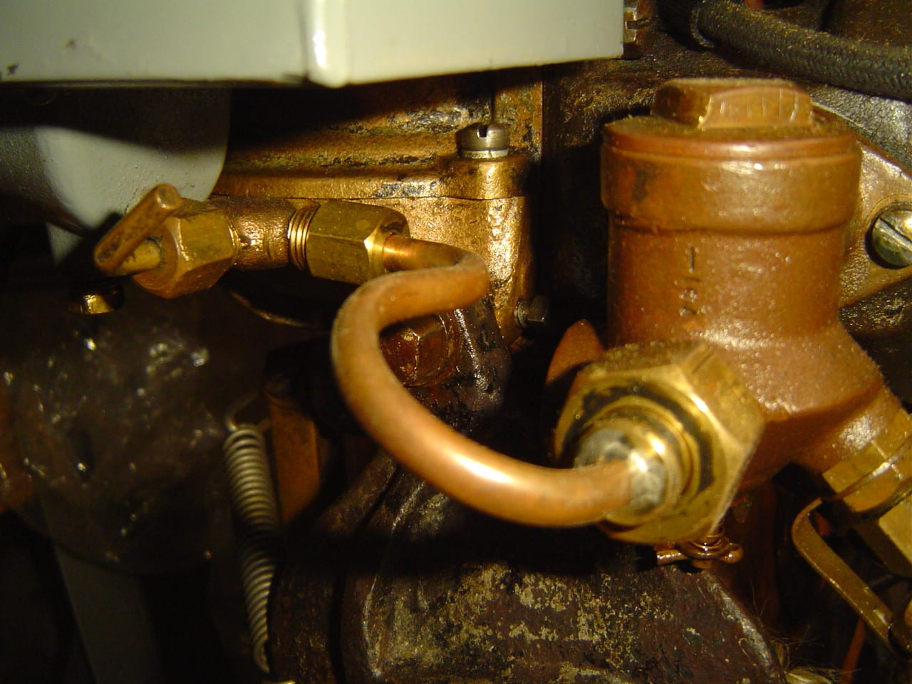

        #224667
        JOSEPH BRINCAT
          Buc, Here is how mine is piped, I assume original set-up
          Joe B
          Caille-fuel
          • This reply was modified 5 years, 11 months ago by Mumbles.
          #224678
            I wonder if you can make the fuel line and coil it..that will allow you to come straight off the tank….Just a thought.. I have seen something like that, but do not remember the motor…
            Perhaps I could coil it and make a sharp bend if I did have the stiff line near
            the petcock due to my adaptation of 1/4″ to 5/16″ line.
            #224680
              Joe B
              Caille-fuel
              Ahhh, Thanks Joe. Glad to see your mixer is like mine, and it’s
              possible to come “straight out” from the trough. Looks like
              I’ll just need to find a better suited petcock and fittings.
              I looked for petcocks on the Net, but they either have the wrong
              sized plumbing, look to modern, or are way over priced, lol.
              Joe, it that a Ferrel type fitting on the gas line at
              the petcock end, or did they even have compression
              type fittings circa 100 years ago?
              • This reply was modified 5 years, 11 months ago by Buccaneer.
              #224686
              JOSEPH BRINCAT
                I think that that is a ferrurl fitting at the petcock( metal ring around the tube, compressed by the nut). Not sure what you mean by a compression fitting? the flare type?
                Joe B
                #224745
                  Joe B
                  Thanks Joe, From what I see the Ferrule type fittings are often called
                  compression fittings now days. My dad tought me “Ferrule”, so
                  that’s what I always called them.

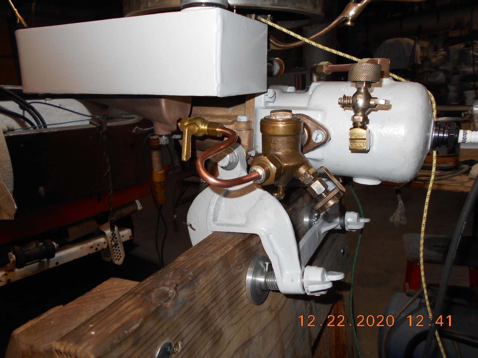

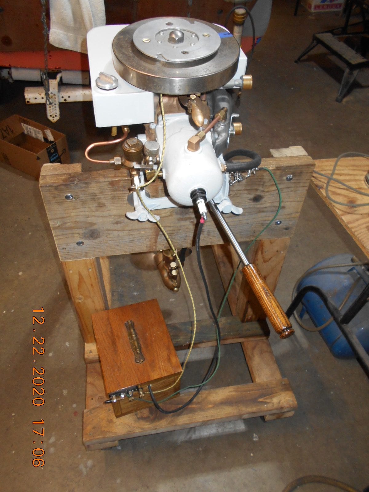

                  #225773
                    I got a “more correct” petcock, and I’m happier with the way the fuel line
                    presents itself.
                    I ended up brushing on Ford Light Gray paint. Not sure if I gave it
                    the “antique” or kindergarten look, but better than when I got it.
                    DSCN0051
                    DSCN0055
                    #225785
                      Buc – outstanding piece of work! Looks fantastic!!
                      1982 Evinrude 25hp
                      #225809
                      JOSEPH BRINCAT
                        Bucc, very nice , in deed! Are we ready for a little “blue smoke” ?
                        Joe B
                        PS, I’ll keep an eye open for a proper primer cup for you.
