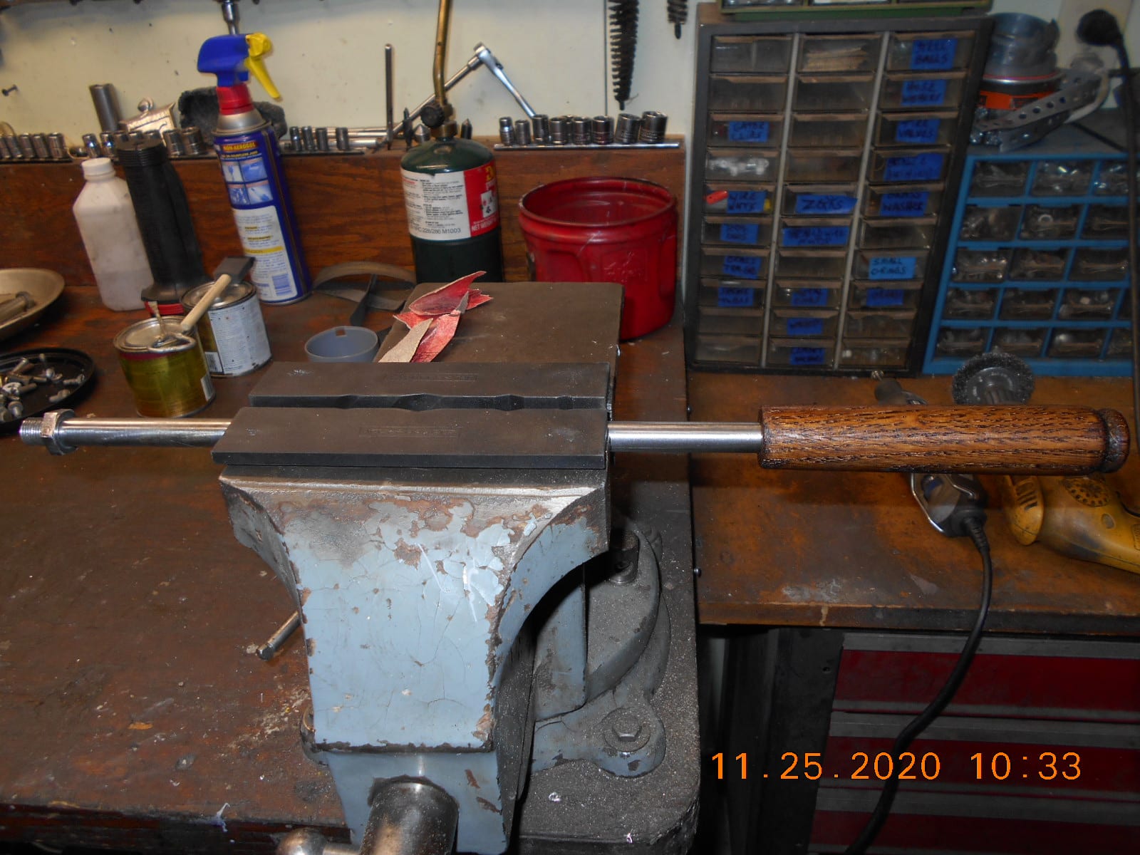

      The Caille is starting to take shape. Threaded a rod today for tiller handle.
      Some of the ads look like they may have had a wood grip, but can’t tell.
      Anyone have one with wood?
      DSCN9837

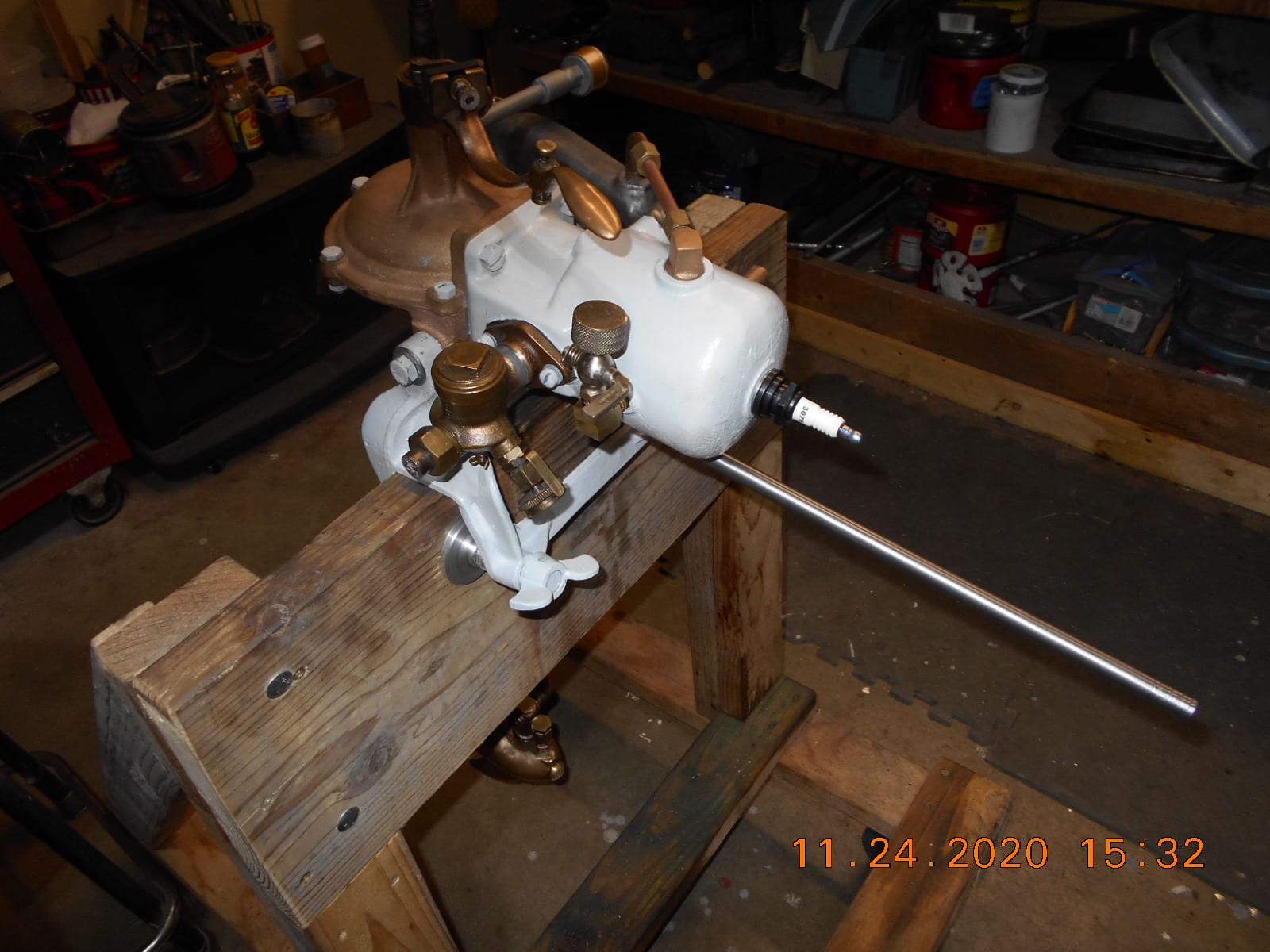

      What kind of grease is recommended for the crankshaft grease cups?
      I suppose some of the grease could eventually migrate to the crankcase,
      so thought I’d ask.
      DSCN9835

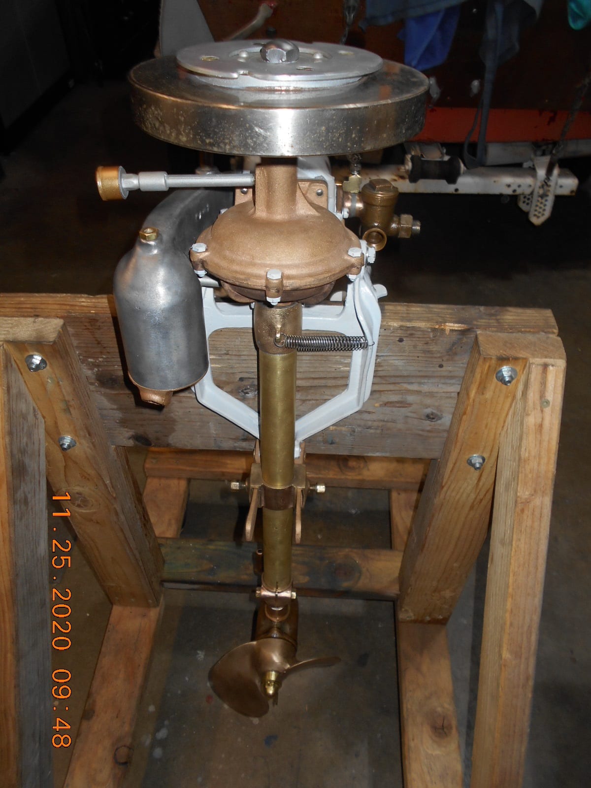

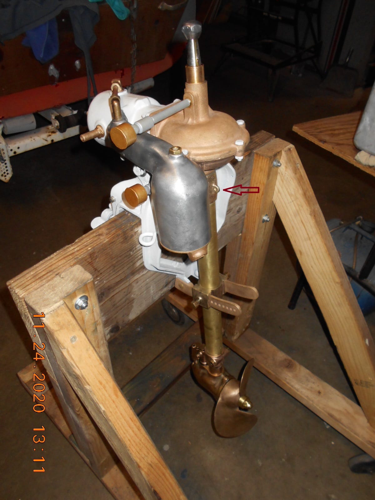

      What’s the ear for on the back of the lower unit, that looks like it would be a good place
      to attach a spring?
      DSCN9836

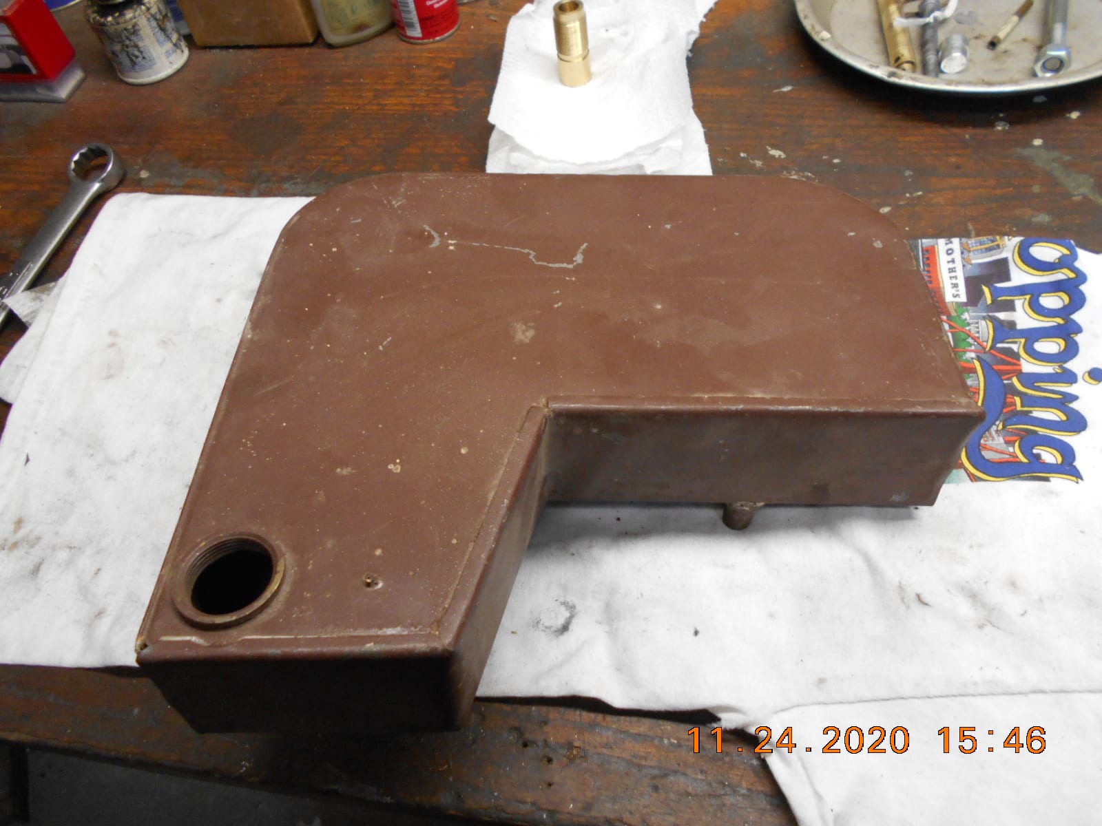

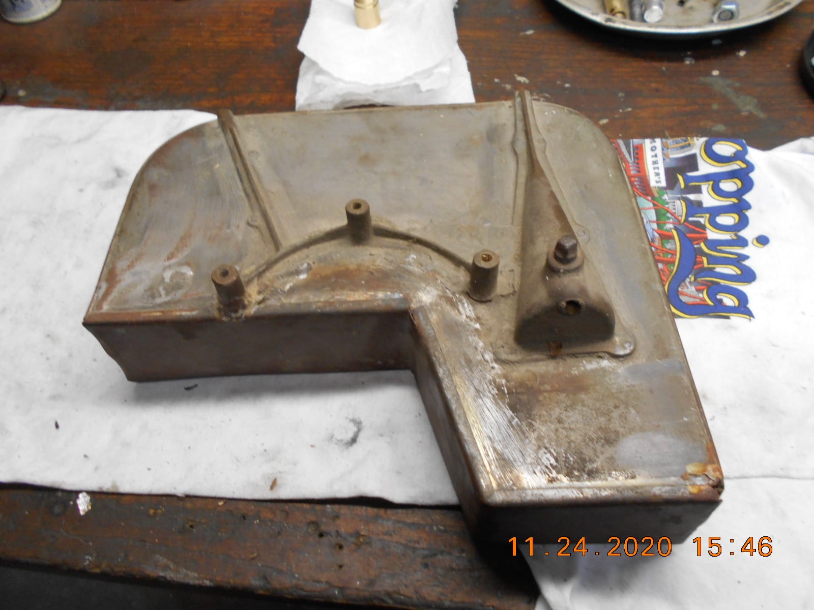

      I’ve not started on the gas tank yet….. wish me luck!
      DSCN9843

                #221662
                  George, interesting about the tiller handle locking the steering for “auto pilot”.
                  I don’t have that feature on my Caille, and if my Wisconsin has it, I’m not
                  aware of it. Mine just has a 1/2″ x 20 tpi threaded hole in
                  a casting on top of the lower unit.
                  Mine has a spring on the back side of the casting (that the handle screws into)
                  to help maintain an even course.

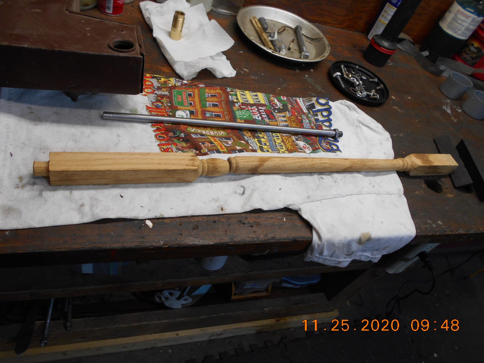

                  I did end up making a wood handle out of an old old stairway spindle.
                  Maybe a brass ferrule on it would be a good touch!
                  Thanks.
                  DSCN9845
                  DSCN9847
                  DSCN9846

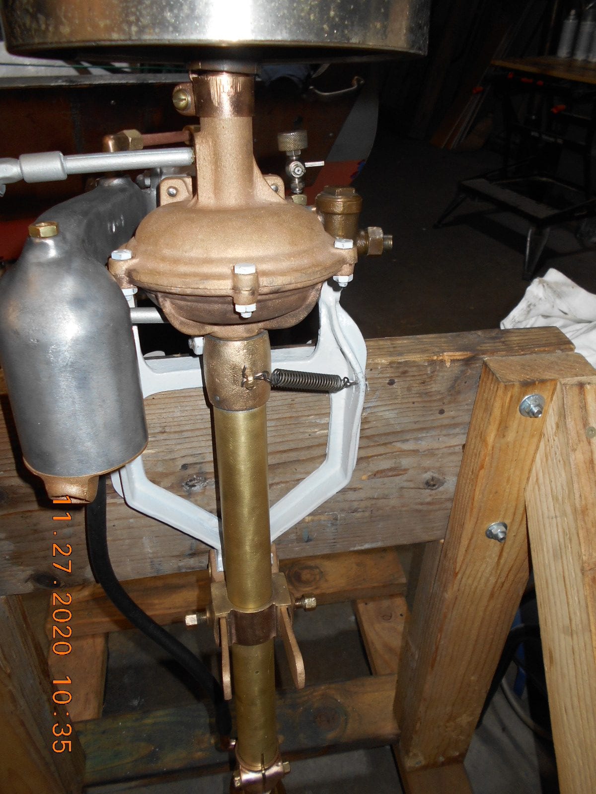

                    The hole where you’ve attached the end of “Steering spring” in transom on my motor has a cotter pin installed in it, then the spring is attached to the loop in end of cotter pin. I’ve seen several that way. Not sure if it’s correct?/
                    #221703
                      I wish I would have thought about that! It sure would have made
                      it easier to install the spring! I’ll probably re-do mine, I need
                      a stiffer spring anyway. Thanks!
                      #221725
                        I redid the steering spring on the motor as Eltoquad mentioned, except
                        I put a ss cotter pin on each end, and a different spring. It works better,
                        looks better, and easier to install. Thanks for the tip!

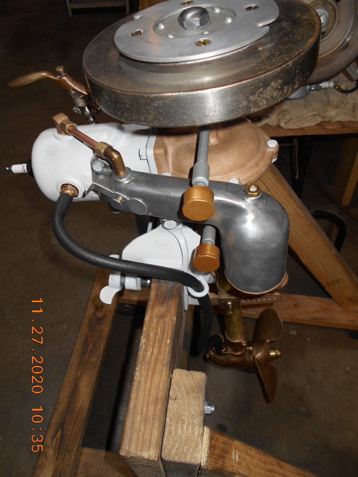

                        I also went by someone’s sage advise and used acetone to remove the
                        white printing from the fuel hose I used on the water pump hose to make
                        it look a little more “correct”.
                        The 1/4″ ID hose went on the pump end okay, but the cylinder fitting
                        was larger diameter, and I had to machine it down a ways.
                        Will have to purchase some antique looking hose clamps to finish it off.
