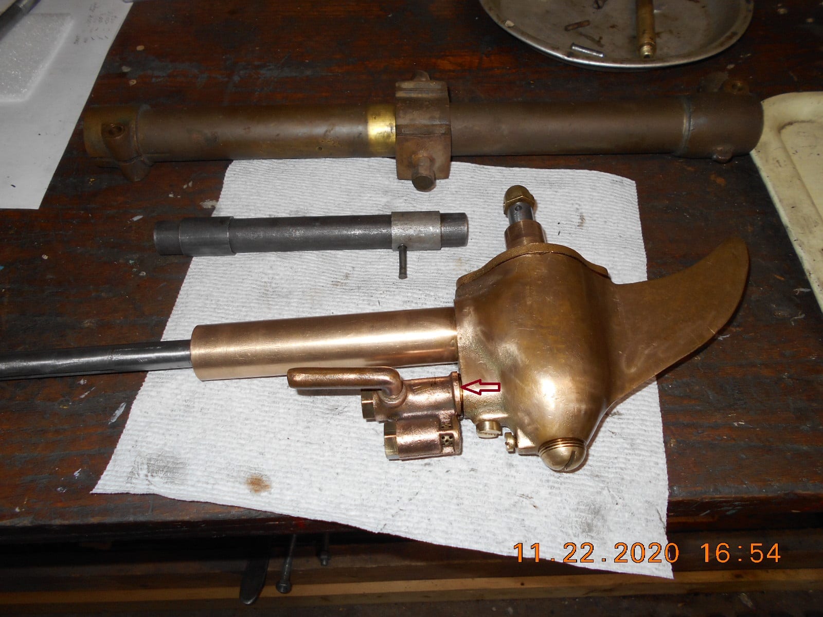

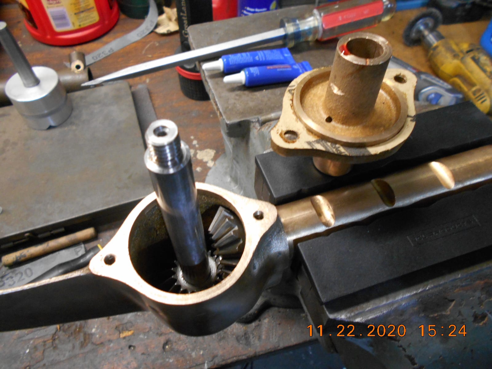

      I got the new prop shaft, bushings, etc., back in the gear case and it’s
      starting to look like it could to be a runner again.
      As I was looking at photos I took today to document my progress,
      I was wondering if there’s suppose to be a gasket or sealing washer
      between the gear case and the water pump assembly
      ? The pump
      bore fits in the case somewhat snug, but not water tight, so I put
      some Indian Head gasket sealer around it when I put it together.

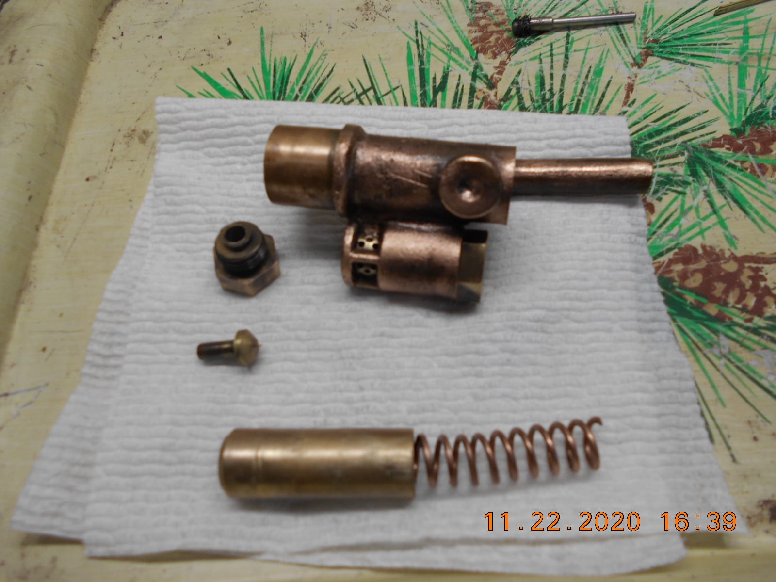

      When I took the water pump apart I was expecting to find check “balls”,
      but found little check “valves”. Are they unique to Caille?

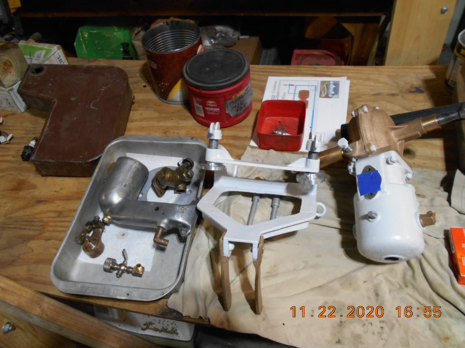

      The gas tank will be a major pain, if I can salvage it. Some of the seams
      are loose. Not sure how solid it is yet. Once I get the heavy primer off of
      it, I’ll know more. Anyone have any luck unsoldering the tanks seams to
      gain access to clean the interior, the seams, etc., and get it back together
      and soldered, or would that be a big mistake on my part?
      The Callie never had a tiller handle. I “believe” it’s just a skinny pipe that
      screws into the crankcase somewhere. Anyone know if the handles were
      brass pipe, or iron, and if they had a “grip” on the end, and if so, would
      it be rubber or wood?

        Check valves not unique to Caille. Most motors of that era with the plunger-type water pump use them as do all Johnson model A and A-25’s. Clean the seats out with a brass brush and some wet Comet cleanser. The check valves can be cleaned up with a scotch-Brite pad if they need it.
        No sealer or gasket around, in, or under the water pump. They are far from watertight. Water gets in and gets out. Its why Lubriplate grease is the shittiest grease you can use for a rowboat motor lower unit. Use something that is going to stick to the innards of the gearcase.
        Taking gas tanks apart is just something that needs to be done on rowboat motors, especially if they show signs of heavy rust, either inside or outside. They will come apart using a good heat gun if you want to avoid using a torch on it.
        The steer handle is more than likely nothing more than a length of round stock with a 1/2″-20 NF thread on the end that threads into the tiller yoke. You can use whatever metal stock (Aluminuim, brass, steel) that you have. Most Cailles that had a grip used one of rubber. Jack’s website will have a lot of photos on it to use for comparison. I’m not going to look for it because you should do that research anyway. Just be aware that looking at the variable pitch prop motors won’t help you much because the handles and grips are all together different.

          The check valves in the water pump were in nice shape, but I lapped them lightly anyway.
