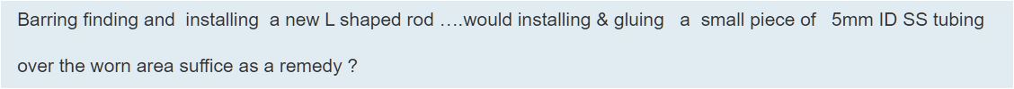

      Barring finding and  installing  a new L shaped rod ….would installing & gluing   a  small piece of   5mm ID SS tubing
      over the worn area suffice as a remedy ?
