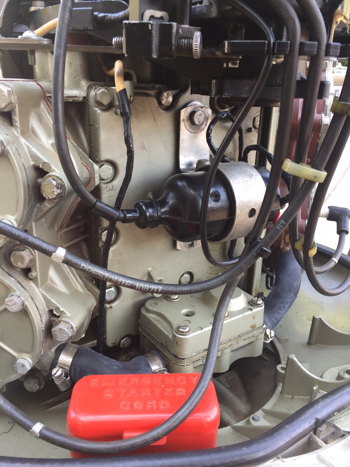

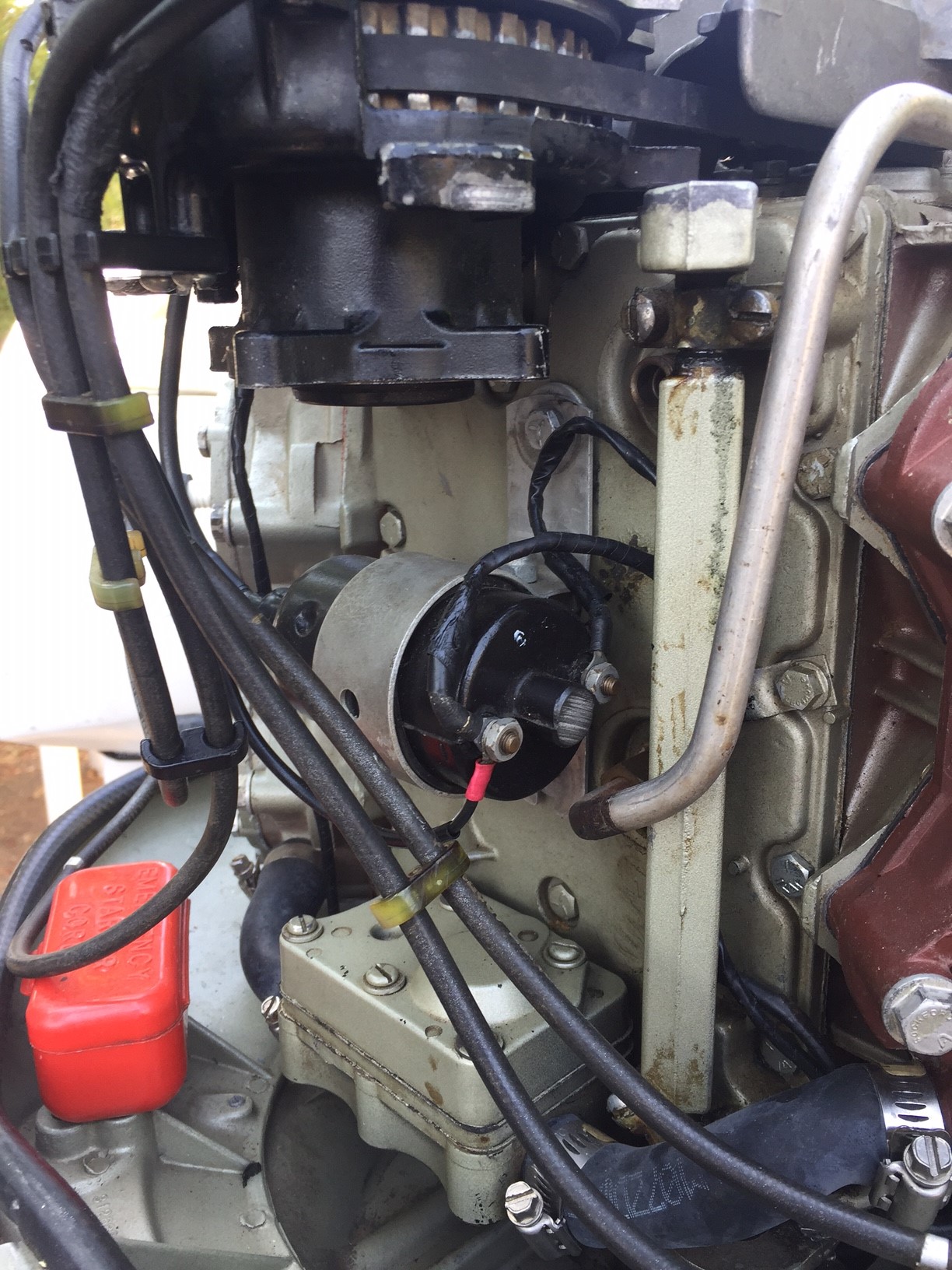

Hello to all;
Is there any way I can test the coil, on my battery / distributor ignition? Without having it running or buying a special tester??Motor was running rough, and then quit suddenly. Like hitting a switch. Wouldn’t make a single pop after that.
Testing suggested weak spark. Replaced points, condenser, and rotor. Distributor cap good, (almost new).
Testing still results in very weak, intermittent spark. Quadruple checked points; they break perfectly.
I’m wide open for testing suggestions. Wiring, etc.
Flywheel has not slipped; flywheel and distributor are timed correctly.
Very long story short; I’ve had this motor running beautifully in the past. Wiring was crispy when I got it, but has been cleaned up and worked fine. Coil is a replacement, with only about 20 or 30 hours on it.
After much work on the entire fuel system, no improvement. Yes, this is the 80 HP V4 I’ve posted on a million times. Yes, I have fumbled, and replaced parts needlessly w/out thorough diagnostics; the classic rookie approach to repairs.
All suggestions welcome.
