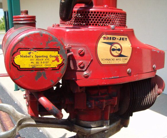

      Not very knowledgeable here but I’ve seen any number of decals, jet lower units, and gas tanks, on this power head. (from my picture files)
      Schnake-Mid-Jet-1

        That appears to be a 1960s outboard with a Tecumseh 2-stroke powerhead.  I have not seen one with a separate driveshaft and exhaust before, nor that specific swivel system design.  I find these motors interesting.  Yes, it’s worth repairing – it has quite a simple powerhead, I think, but the carburetor with its diaphram instead of float bowl makes things a little different.  You can still find a carburetor kit.  I think it’s Tecumseh # 631893A.  As this motor has an air-cooled powerhead, you might be tempted to think it is ok to run it out of the water.  However, there is no gearbox to fill with oil.  Instead, I believe the lower driveshaft bearing in the jet area is water lubricated, so don’t run the motor out of the water.  The powerhead likely needs at least a 16 to 1 gas oil mix.  Maybe 12 to 1 or 8 to 1.  I know I have been surprised before when I was informed that a Tecumseh 2-stroke called for more oil than 16 to 1 mix.  16 to 1 will likely be fine in this motor with synthetic oil.  Please make sure you use air cooled two stroke oil.  TC -W3 rated oil, likely saying outboard oil on the bottle is unsuitable as it’s meant for cooler running engines.  Have fun with your new project!  P.S. Check for a patent number you can look up on top of the jet drive
