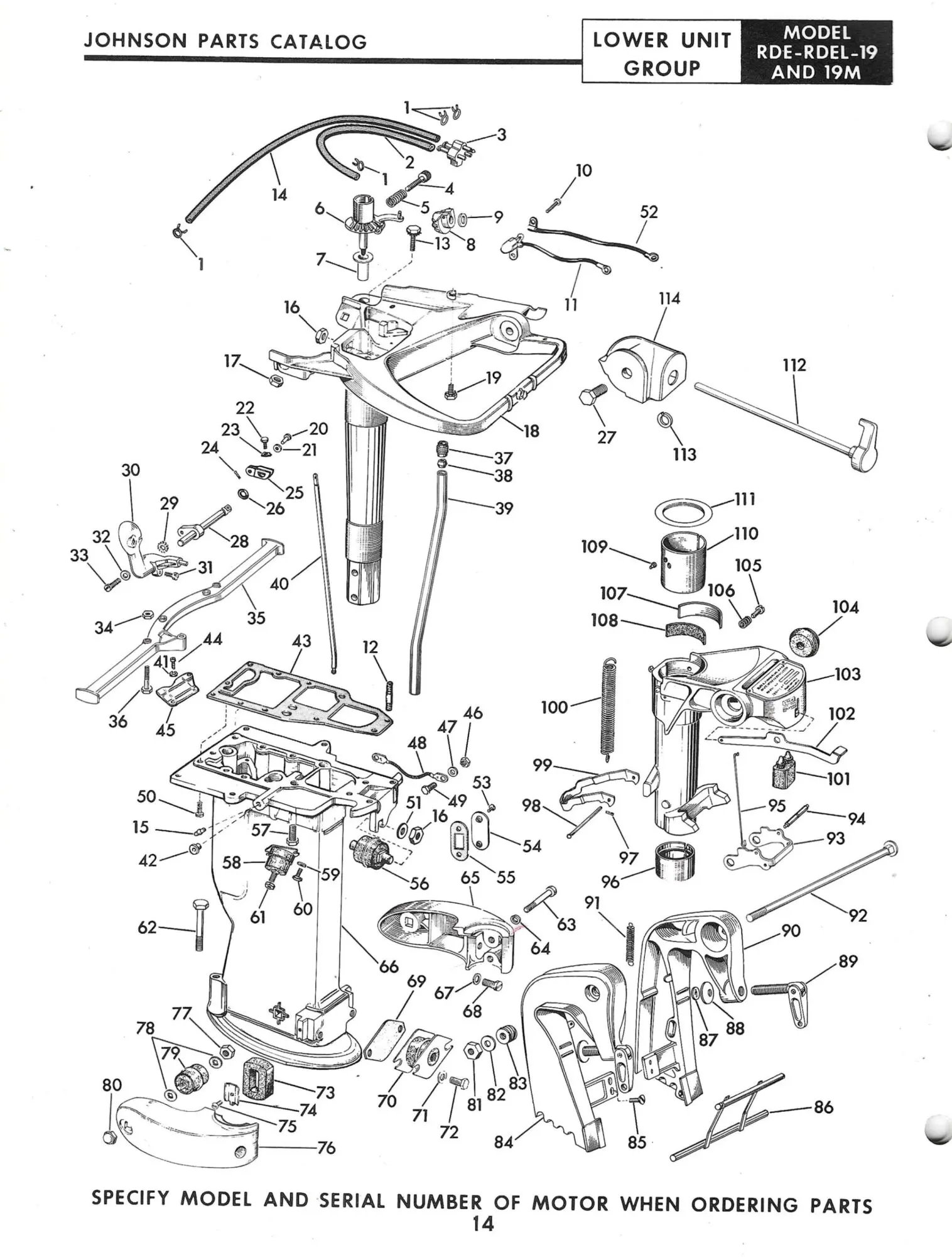

      #323547
      MIKE SIMS
        What Don said. And
        I had a motor that the gear #6 in the pic was seized on bushing #7 (old dried up grease)
