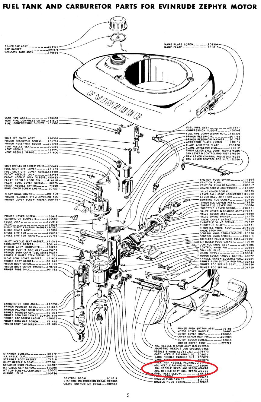

        My Zephyrs run and the carbs adjust OK but my Lightfour tends to flood badly on the high speed circuit.
        This diagram mentions seats for the needles but doesn’t show them. I suspect the Lightfours high speed seat has fallen out and now I can’t adjust the fuel flow on it. I sure wish I could find the exploded diagram in my files of the carbs which does show the seats. You might have the same issue.
        Click on the link for the Zephyr carb manual.
        ZephyrCarburetorMaintainance
        49-Zephyr-Tank-and-Carb

          If you remove the HS needle you should be able to see the seat with a bright light. I have a PDF of the carb maintenance manual can send it to you if you want.

                  I think the seat is part of carb body, I had that problem someone over tightened the main needle and damaged the seat had to replace carb

                    On the Lightfour the seats come out but apparantly with great difficulty, mine are OK.
