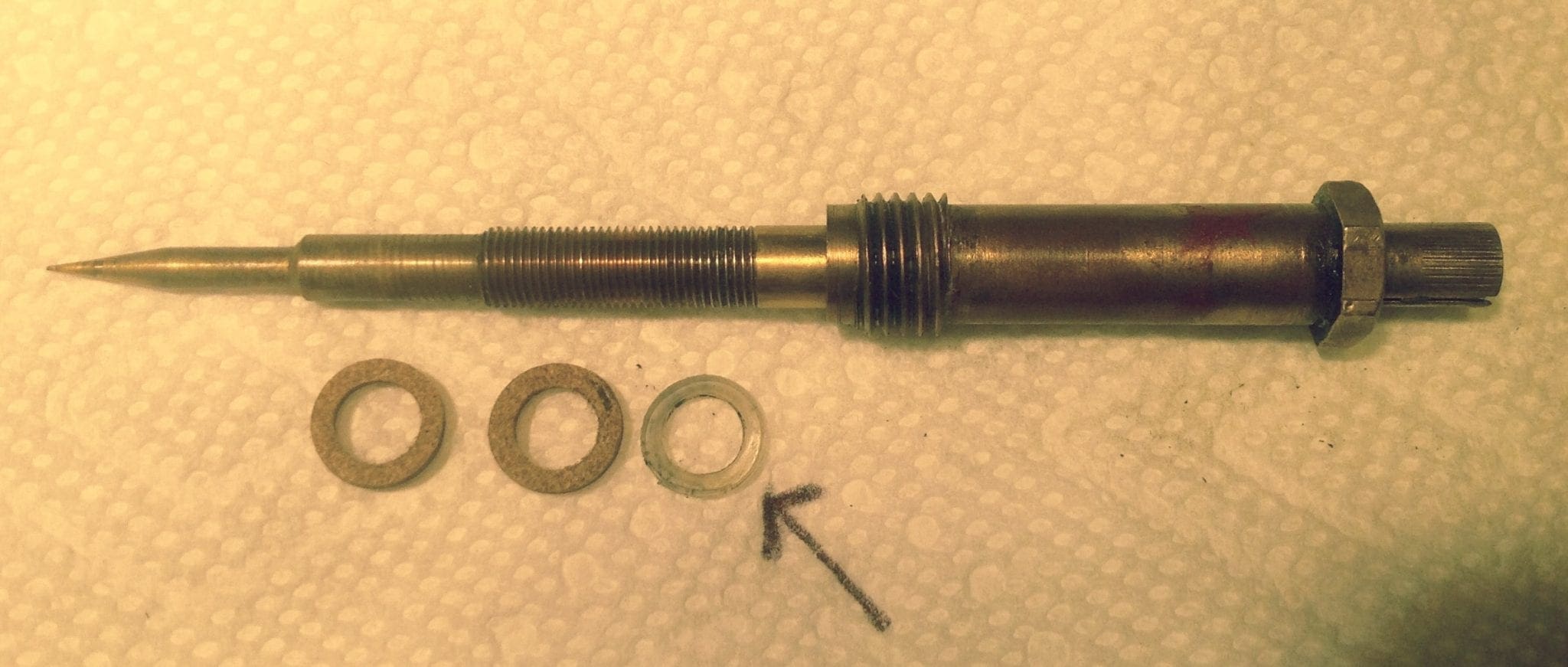

      Would anyone know if there is a separate part number for the white / clear plastic needle valve end bushings that is in the OMC carb rebuild kit.
      If no number is available,is there an aftermarket supplier?

          Jim, I don’t think that’s the part?
          The one I am looking for gets stacked with the 43-123 fiber washers. It looks just like the fiber washer (flat) and is the last one you put on after you stack your 2 fiber washers.

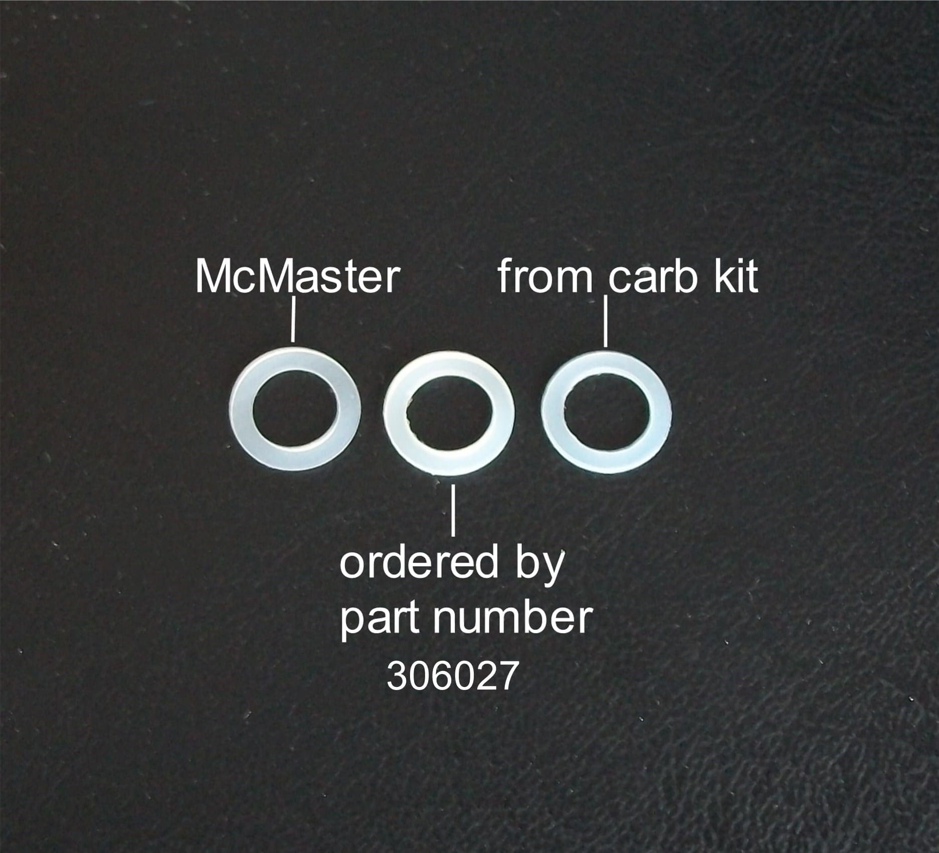

                  OUCH. That’s nuts. Thanks for the part number.
                  Maybe I’ll dig around McMaster-Carr to see what they have?

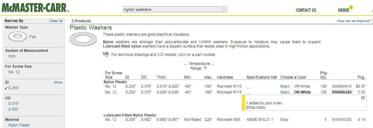

                    I got these from McMaster Carr a while back and they work fine. 2 different sizes. The little thicker ones work better and are closer to the original.

                      Thanks Steve, that’s a bit better…..100 for almost the same price!
