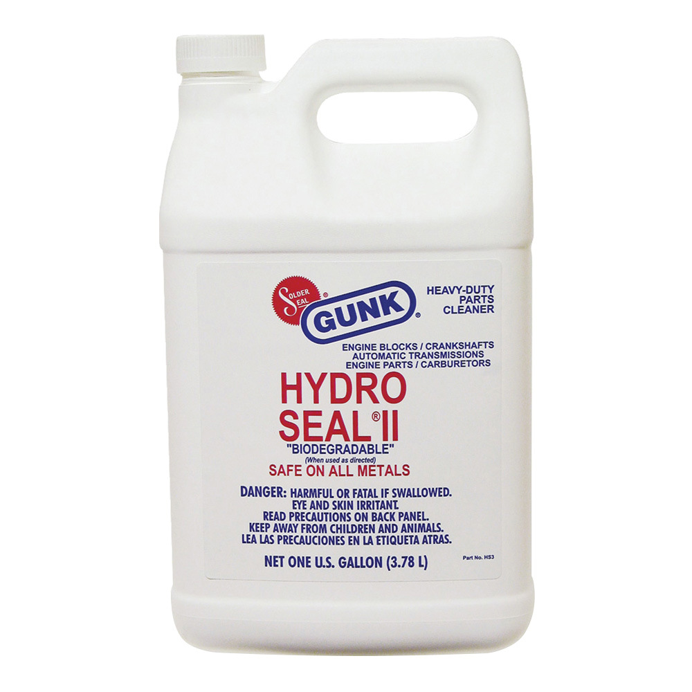

July 2, 2016 at 2:08 pm #39456This
http://www.ebay.com/itm/like/301984923735Set it in the basket and wait 24 hours. Rinse with hot water. Really gunky ones take 48 hours. Never even had to scrub them

Robbie RobertsonJuly 2, 2016 at 7:59 pm #39480July 3, 2016 at 12:21 am #39499I have never seen that product before. Thanks Mums, I’m going to give that a try.
