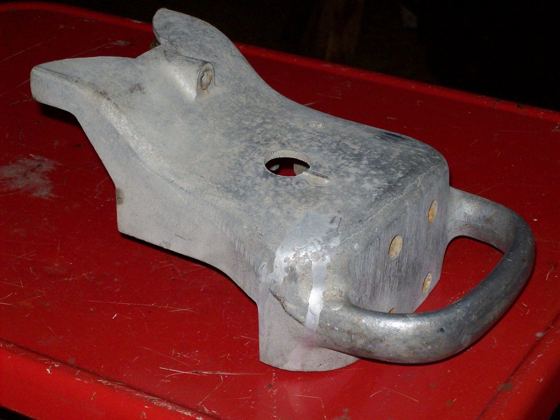

      Acquired at the Tomahawk met this carb cover/carry handle.  What motor does it fit?  Possibly Sea King by Evinrude5922resized
      , what model?
      #264143
      HARRY D. NICHOLSON
        ID found, Sea King model 492, 8.5HP, mid 1930s.

              Me too, I like it. Now I’m looking for the rest of it.  That 1935-38  8.5HP 492 has a more advanced carb than the similar 1932-34 8.0HP 417 Sea King that I have which uses a check valve carb and no cover.
