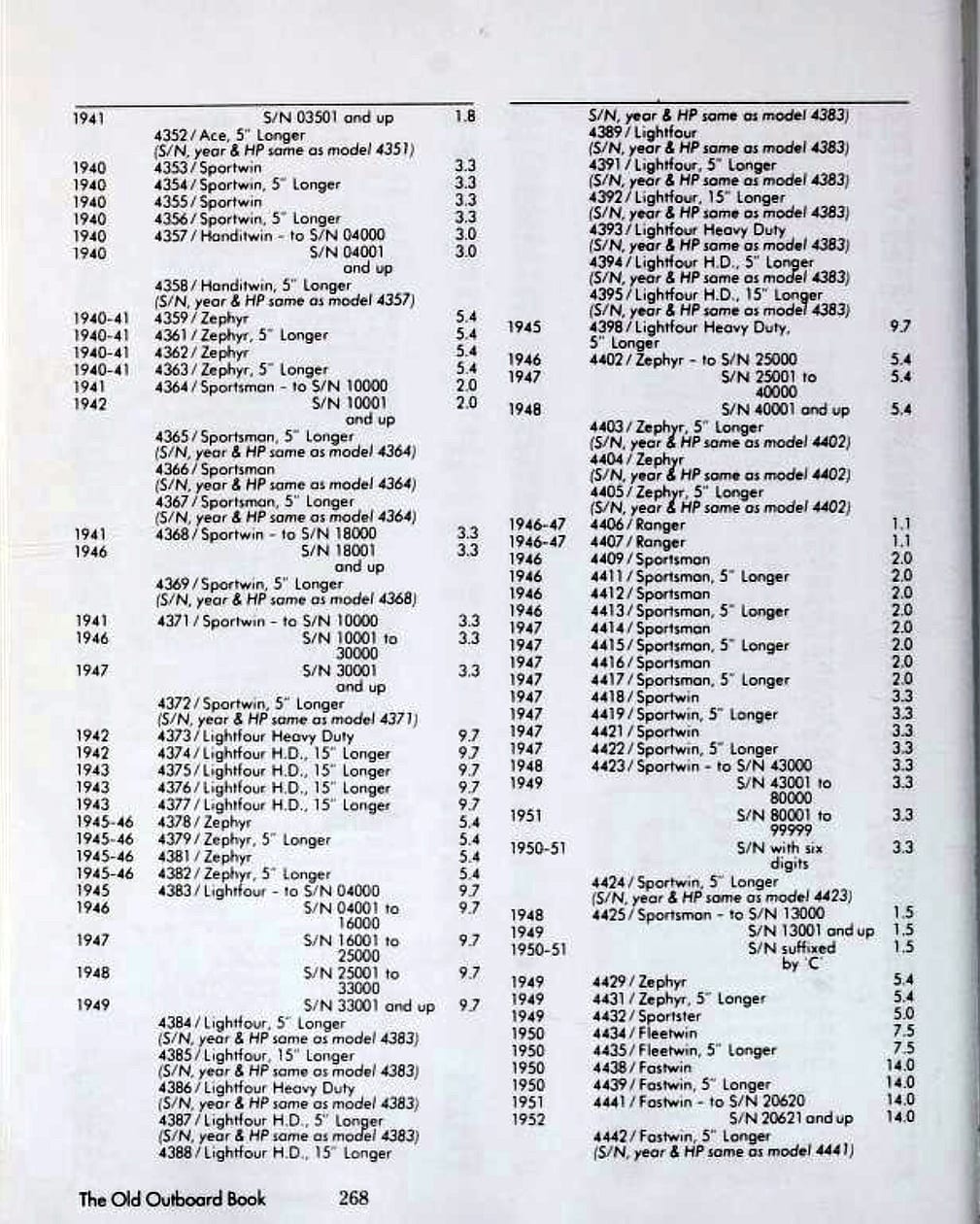

          seakaye12
            US Member - 1 Year (includes $3 online payment fee)
            Serial-Number-Chart_Hunn
