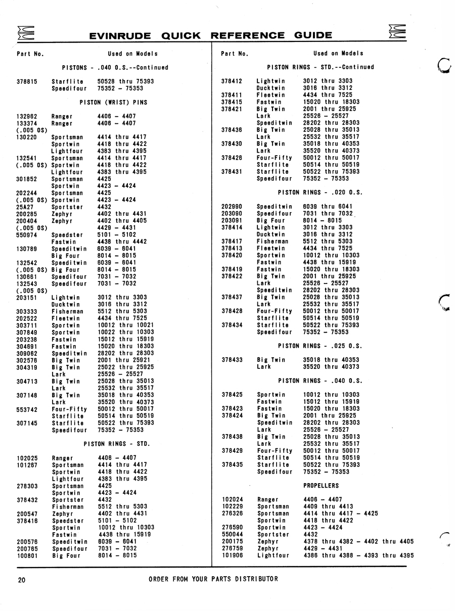

That 1938 Elto Pal – Evinrude Ranger carburetor was made by Evinrude and many parts are no longer available new. Some are found on parts motors, some improvised or adapted from other outboards. This is what I have. . . ๐
Torque specs are same as Sportsman –
