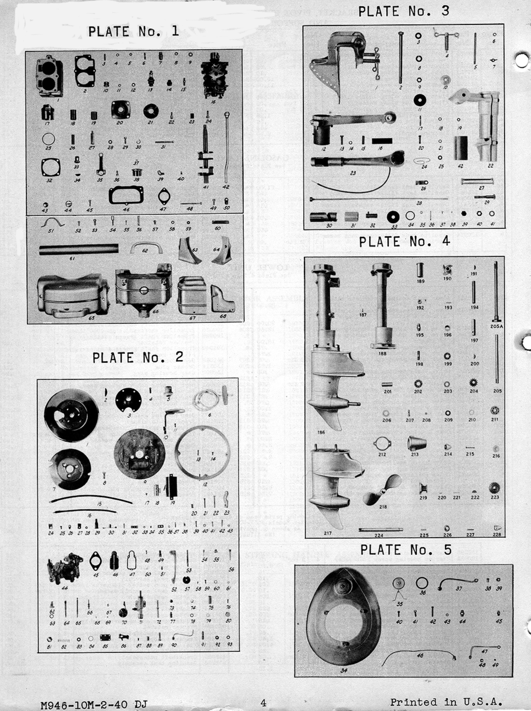

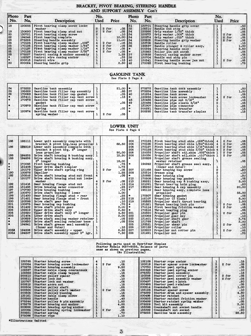

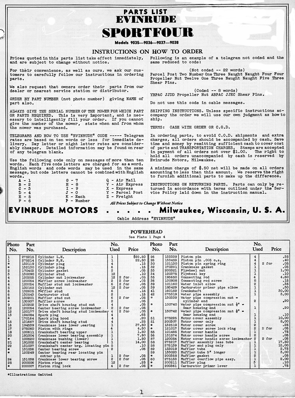

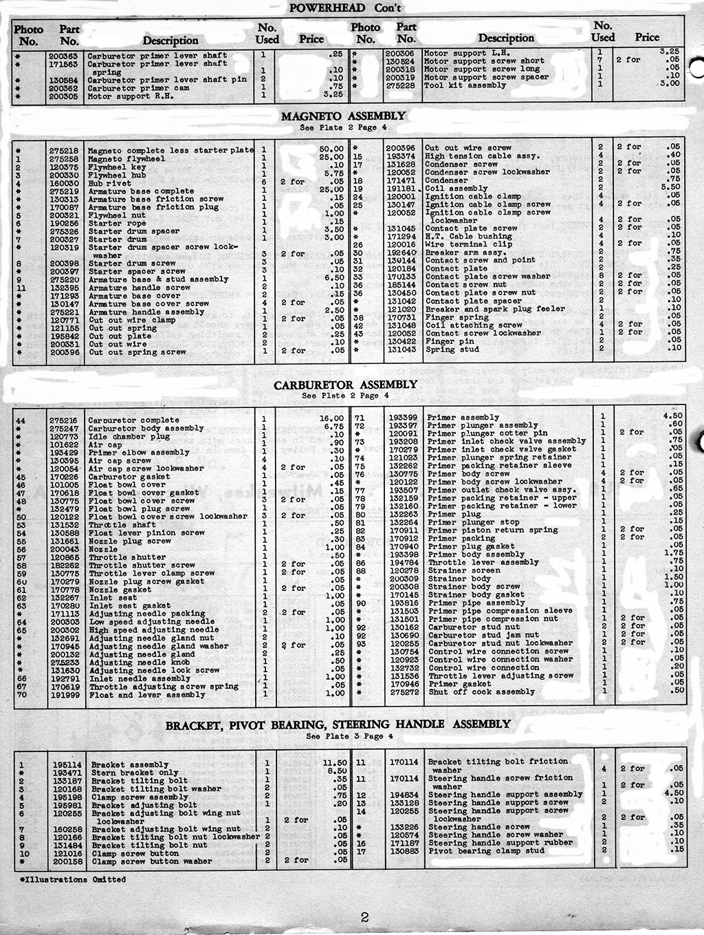

        Not sure what year Speedfour the parts sheets are for, but
        maybe it will help.
