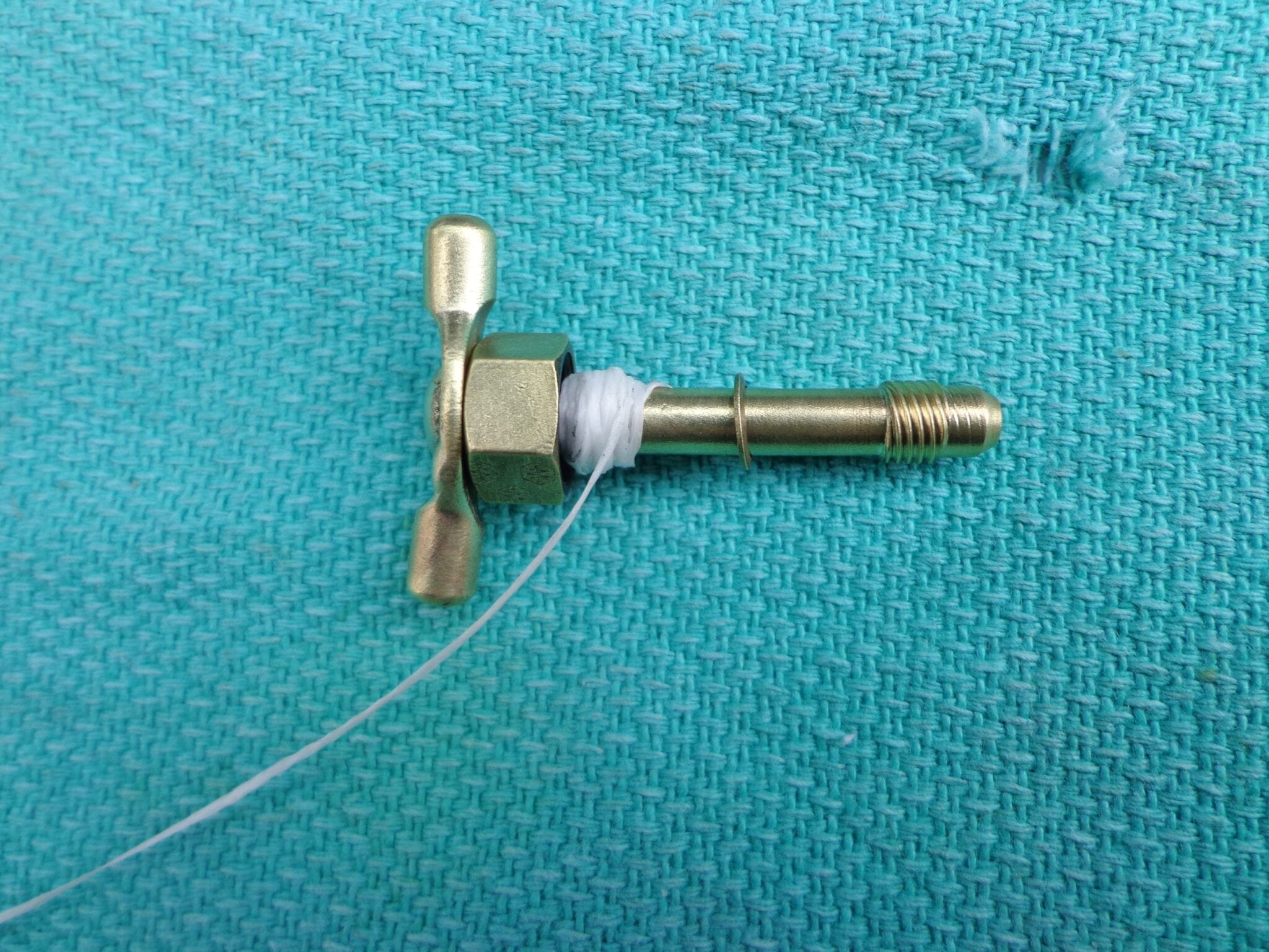

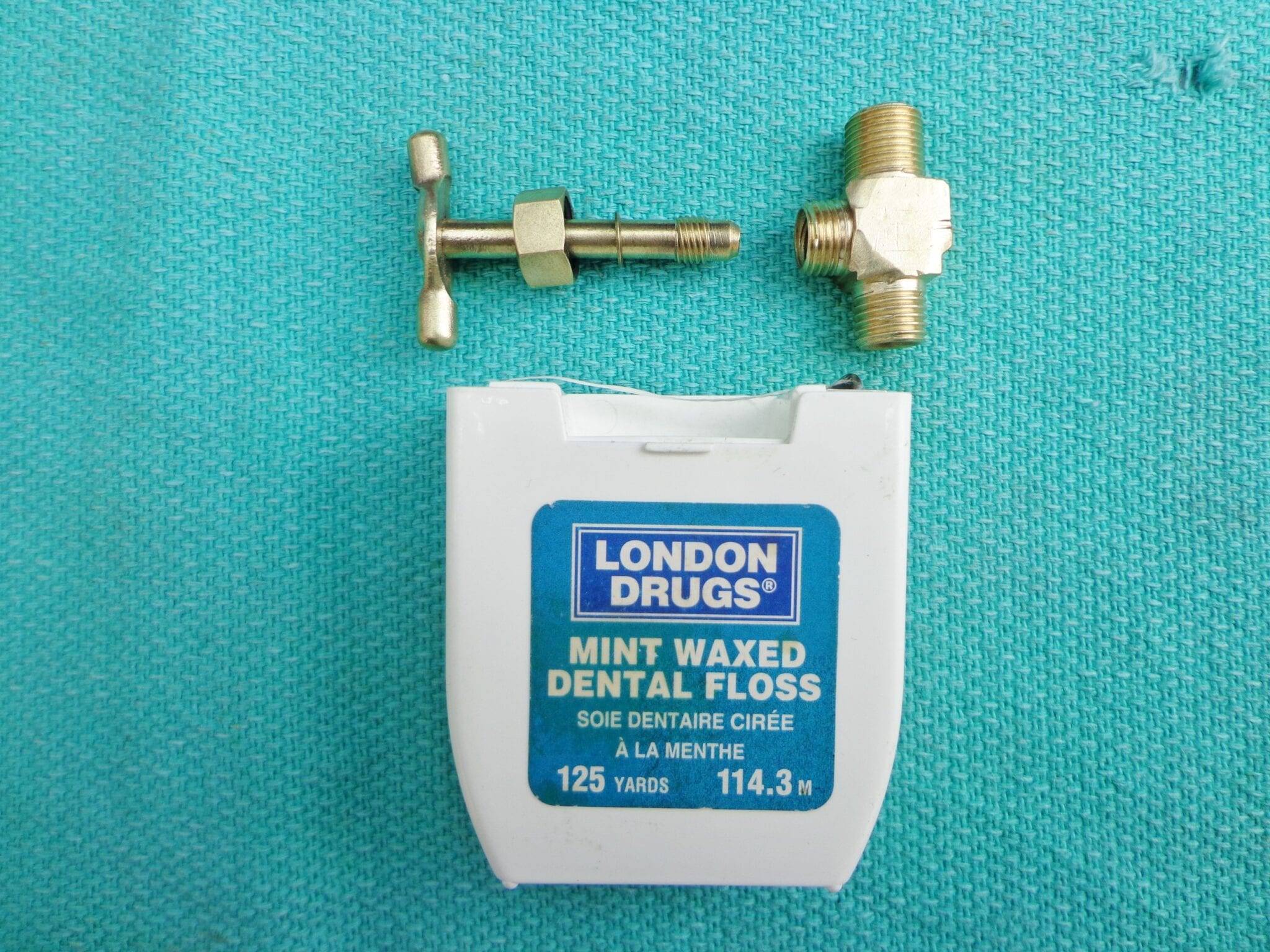

                      And dental floss being used as packing on a fuel shutoff tap.
                      DSC00051
                      DSC00050
