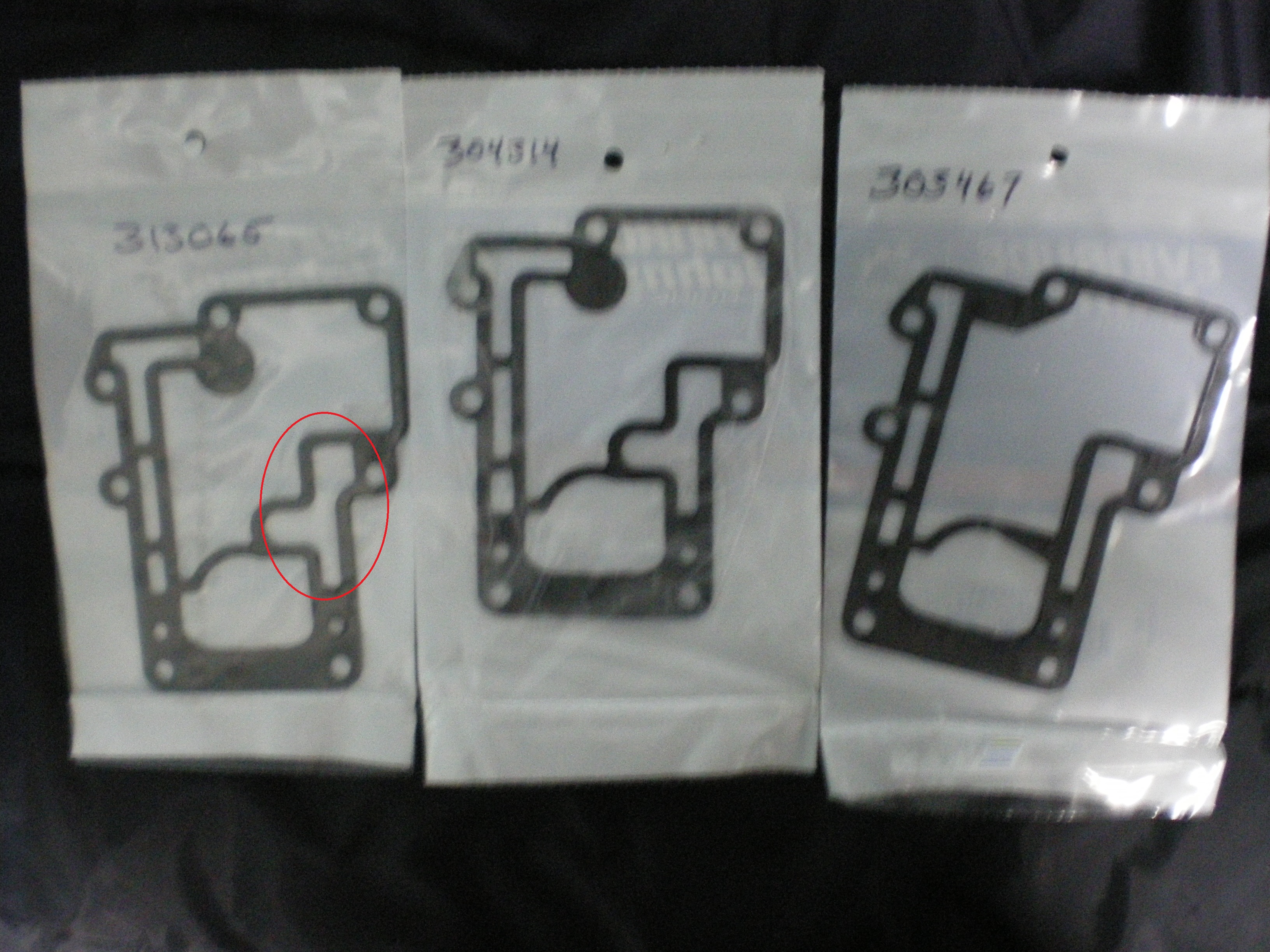

There are three different base gaskets used on the CD series, the wrong one will cause an exhaust leak into the cooling water under the powerhead…What part number base gasket did you use?June 1, 2017 at 12:38 am #58730Thank you all. First I mis-spoke in model, it is a cd 12, 1955. Has the hood with the two wing nuts on the front side, so I guessed wrong.

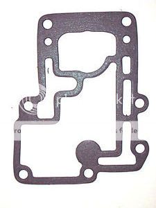

For part number, actually used sierra 18-2894-9 as replacement for304314. Hope that is right, marine engine only starts parts diagrams for cd-14.
June 1, 2017 at 8:53 am #58756You want the ’54 – ’55 303467 base gasket, not the 304314 one. Using the later one will give you an internal cooling water leak. The motor will have lots of water at the flushing port but will be leaking into the exhaust housing on the inside. Your CD-12 must be an early one with the thumbscrews on the hood and a flushing plug installed.
Here’s the two different gaskets for comparison. The 303467 one is the top one.
June 1, 2017 at 3:20 pm #58776Well! I can’t remember if I learned something today or re-learned something today! Ever have one of those moments? I have put on the site incorrect info about CD motor base gaskets. If I can find it, I will edit it. Just beware I have mislead someone out there. Sorry!
Of course the #303467 is the one Sierra doesn’t make! And the most expensive. I believe I remember that.

Why the heck are there two different gaskets for the 56-58 models, and all the later thermostat models?
My weak eye indicates the gaskets are really the same, one just has more of the water inlet passage covered, allowing water through just a small hole in the gasket. And, again, my tired brain would think that the restricted gasket would be used on the non thermostat models, but the opposite is the case….
Any thoughts?June 2, 2017 at 5:10 pm #58827I don’t know why they use the 313065 restrictor gasket on the T Stat models but I would think the water tube alone would be more restrictive than the hole in the gasket. BRP might have realized this as some six horse 313065 gaskets I bought from the dealer didn’t have the small hole and were identical to the ’56 – ’58 304314 gaskets. I guess it’s possible they could have been packaged wrong to but switching them around doesn’t seem to affect the operating temperature or water flow in the motors. The motors can’t tell the difference.
