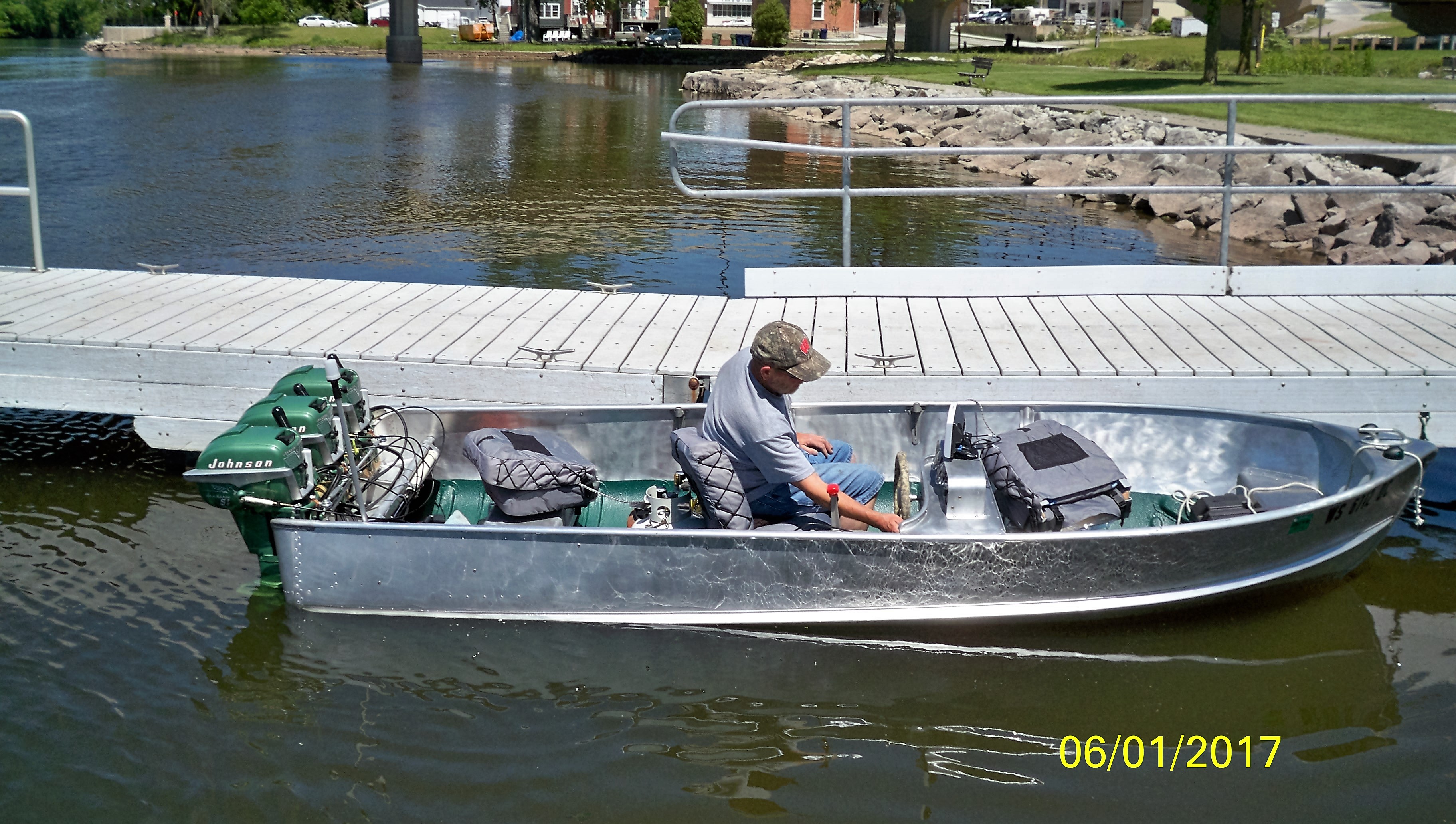

      Here is a picture of the maiden not so successful voyage. They all ran in a barrel before I started out on this "burn-in under load" trip to open water. Could not get them all to run at one time, and although a wide and slow moving body of water, the lower Fox River, was not a good place to fight a trio of hard starting, poor running fresh (amateur) rebuilts!
      Also the maiden voyage of the Alumacraft FD-6 that was restored along with and specifically for the little CD’s. At least the boat test went OK….it didn’t sink!

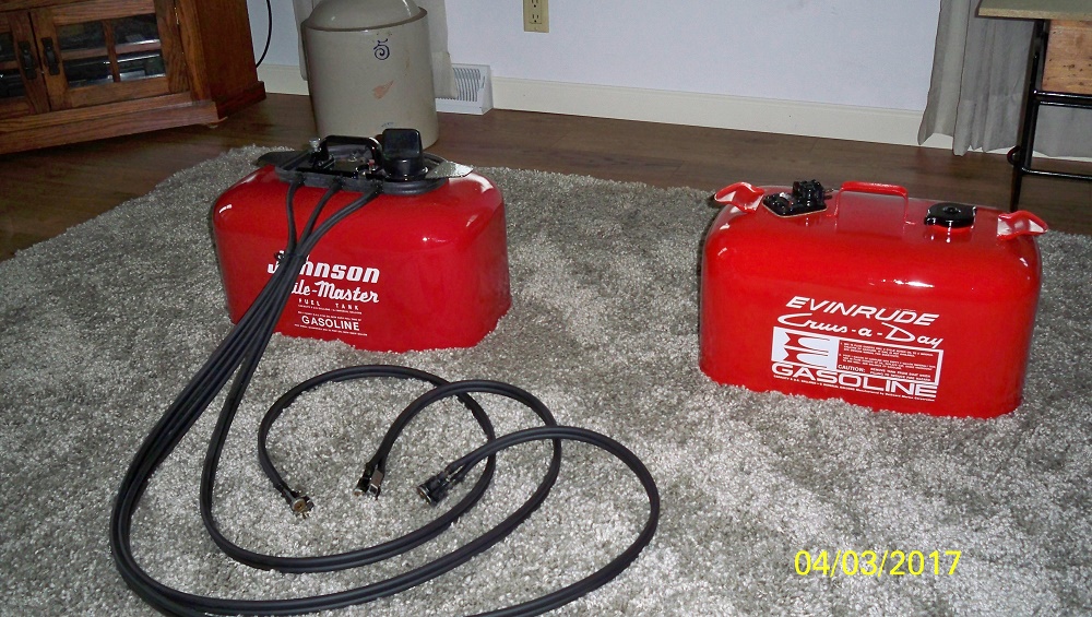

          Just curious about the three motor setup. Are you using pressure tanks or have you added fuel pumps? Have you linked them all to one tank? If so and it’s a pressure tank, did you get by with just putting all the lines in parallel? I’ve got a boat I’m thinking of rigging for two 1958 10 HP QDs, but once rigged, I also have two 1956 15 Evinrudes I acquired a month ago that I need to get running when time permits.

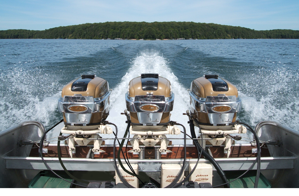

              Nice job on the triples to. They look great sitting on that boat! 😎
              #58901
                Triples are really cool –
                I had to do these with PhotoShop. . . 😆

                  I ran circular manifolds for air and gas around my restored tank, and "T"eed of branches for each of the three motors. Manifolds gave a more equal supply/pressue drop for the fuel and air to each motor. I am awaiting a tach as mentioned to verify all will run concurrently at max rpm without being starve for gas. They all ran together briefly at a pretty high speed in my test pond. Don’t think manifolding these three little guys will be an issue.

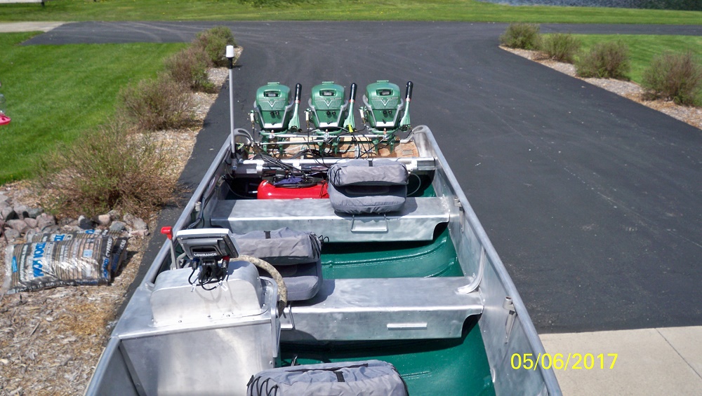

                  Another couple of closer pictures. Aesthetics are at least an accomplishment, mechanicals will continue in progress. I wound up buying a running CD-11 that I am only going to spruce up, and I found another beat up old CD-10 that runs, but plan to use it as parts. Buying stuff at bargain basement prices is addicting. I wonder if there is a 12 step program for this?
