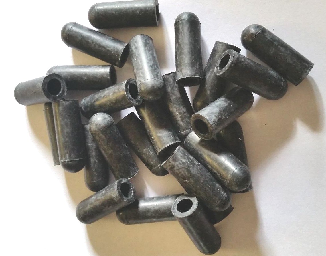

                I’ve used Mumbles and aquasonic’s tips in the past when needed, also BigRich has some nice repros, and I’ve also used rubber vacuum caps in the 3/8" size found at auto parts stores or ebay. Just need to shorten them a little. I recently bought a bag of 25, came out to about .44 each. I can send you a couple if you want them.
                #74029
                aquasonic
                  Great idea Steve D! I’ll be looking into getting some of those vacuum caps. So many times those mounts fall off and are just missing.
