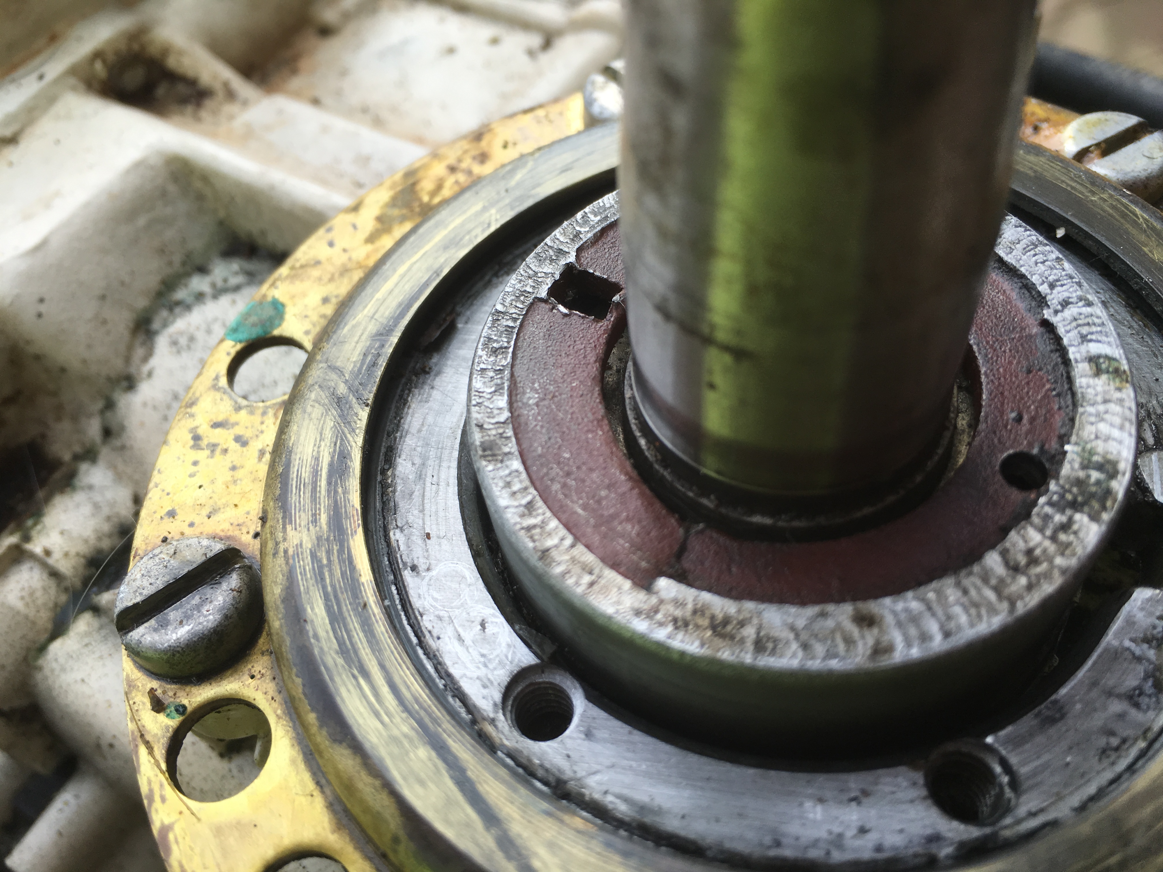

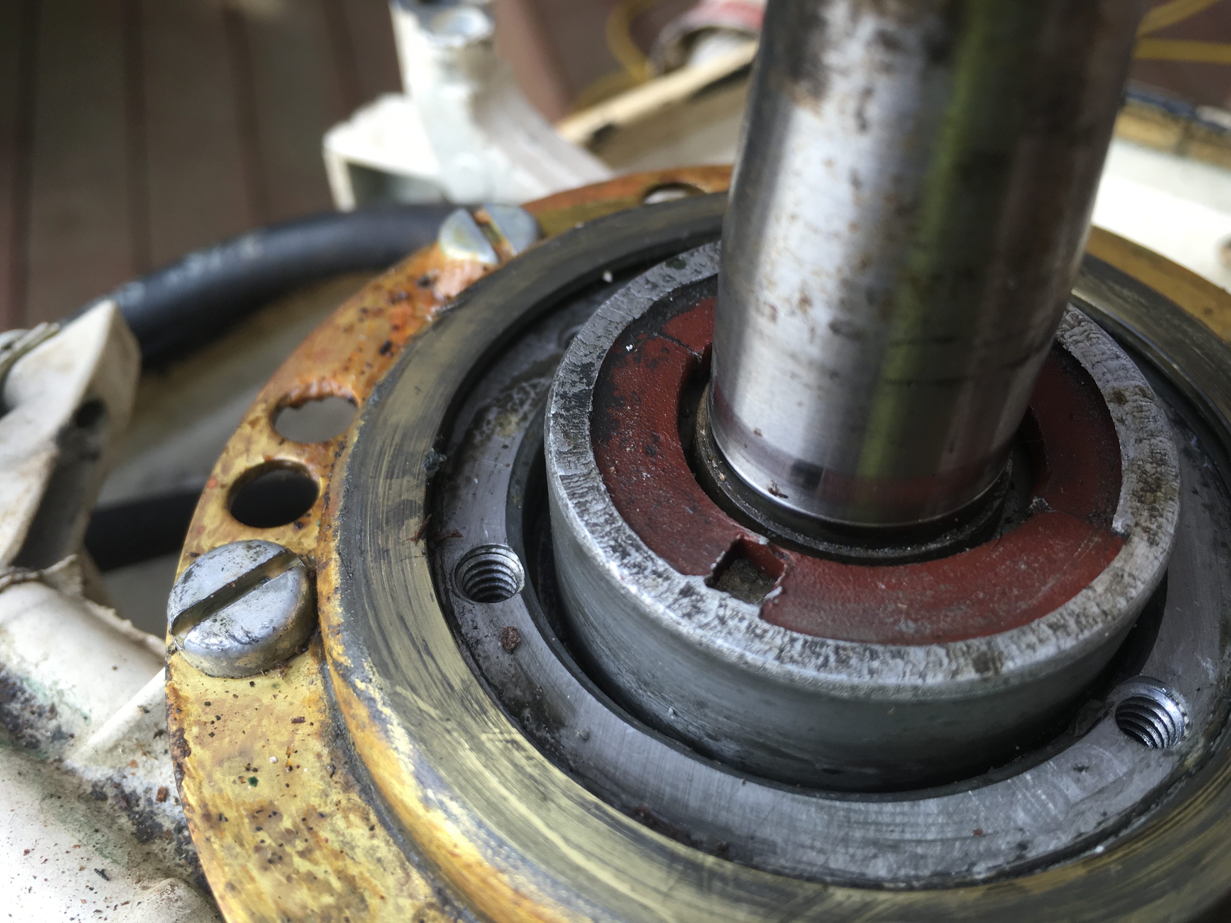

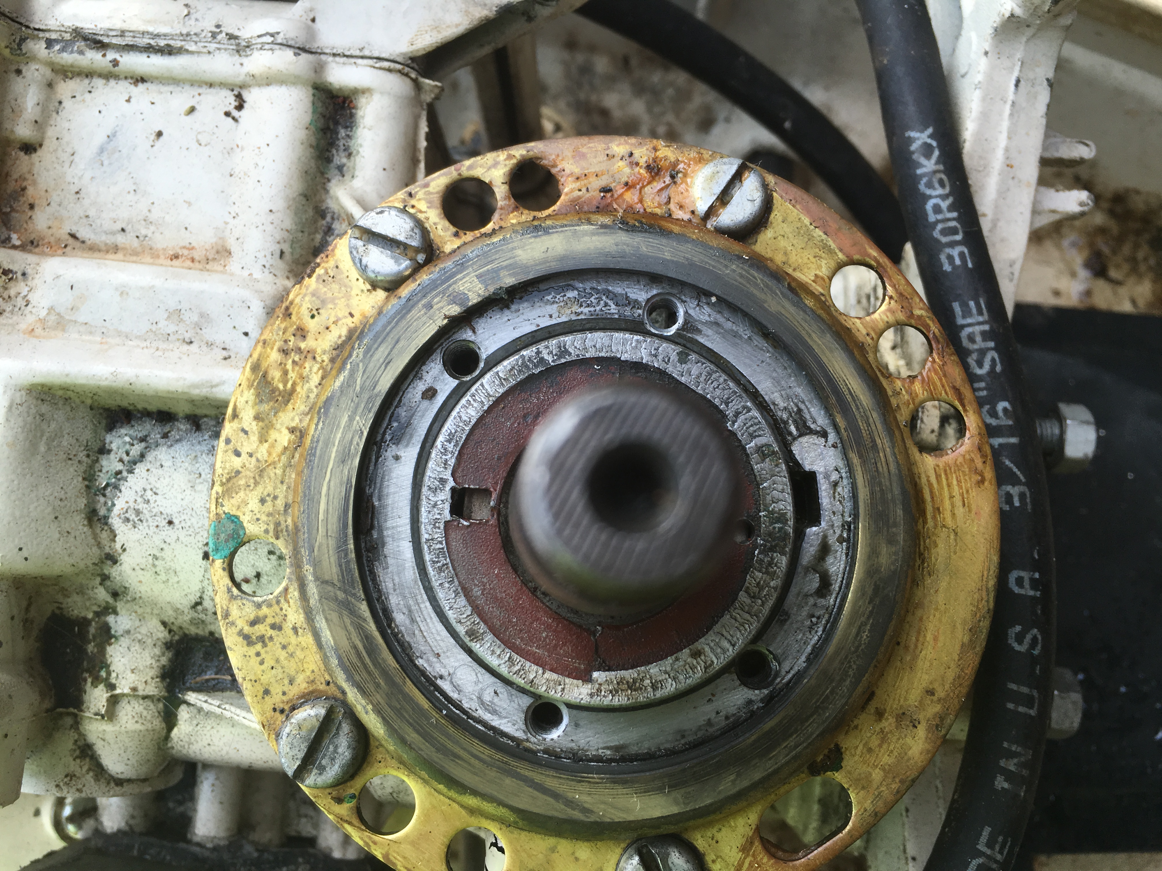

      I am working on a 5.5hp CD 17 it was on a small aluminum fishing boat I obtained last year by trading a 18hp twin for it. I have never worked on one and I have a few questions. I don’t know what the heck is going on with the top seal on crankshaft possibly someone here can look at the pics and figure it out. I am unfamiliar with the top seal on this motor and can’t really figure out looking at marine engines schematic. Looks like it was hammered in there somehow.
      I did see that it has a slinger not a seal on the top. I am hoping to get it running it has great compression and new coils so it won’t take much to get it to go I am hoping this won’t stop it from running well.

        It looks normal to me. The top "seal" is not really a seal at all, it is an oil slinger. The only way to replace it, if needed, is to split the crankcase, remove the crankshaft and press off and press on a new oil slinger ring. To be honest, I have never replaced one because I have never found one to be bad. As the Brit’s say "Chive on. bloke".

            The primer colored area is part of the casting and the slinger is hidden right below it. Perfectly normal.
            #58544
              Oil creeping up the crankshaft is thrown out into a recess in the casting which is drained by a passage leading to the intake manifold. Since there is no metal to metal contact, they NEVER ware out. Failure happens when the passage to the intake manifold is blocked. Cleaning the blockage solves the problem. . . ๐Ÿ˜€

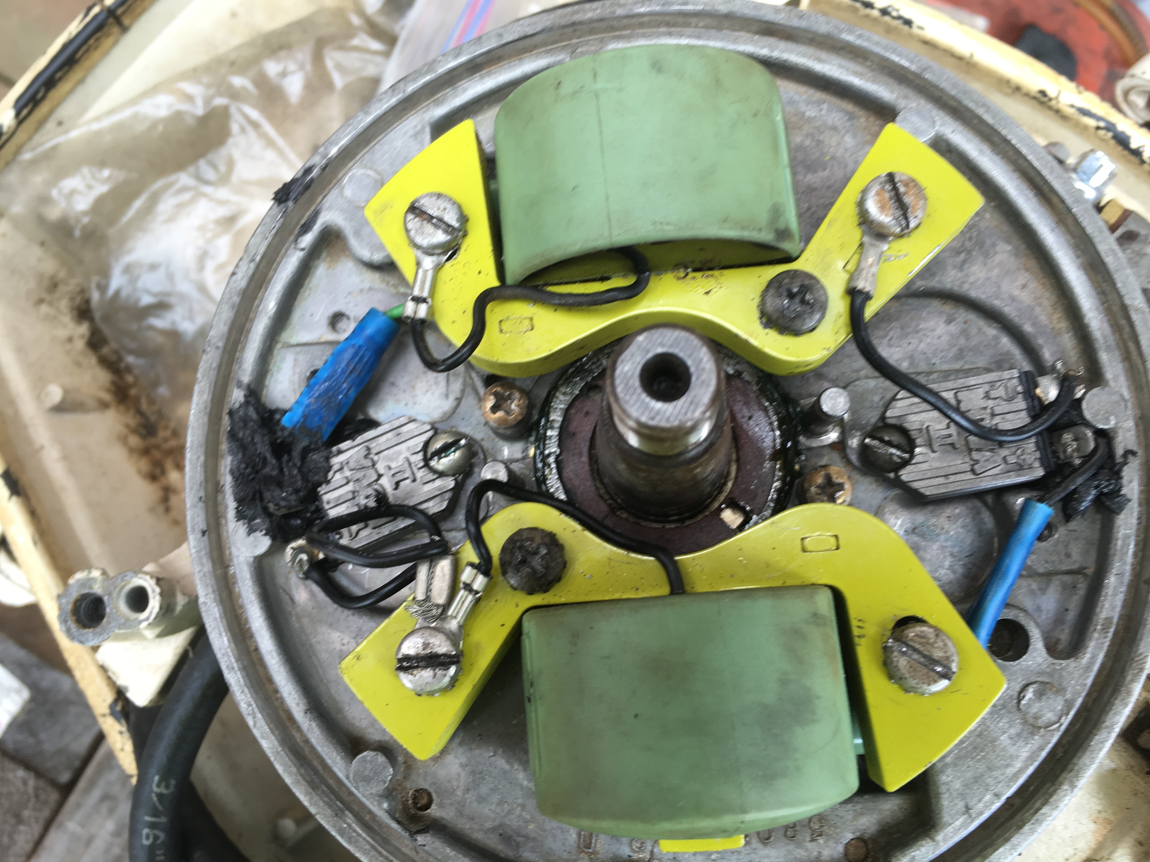

                      Shes all back together and running very well. Cleaned the carb, new iginition wires, new fuel lines and clamps, new starter rope etc.
                      Since it was a bit dirty under the magneto and the points were trashed I decided to convert her to electronic modules since I had a couple laying around and thought Ii would give them a whirl. I used a set on my 9.5hp Johnson which allows it to really get down and idle very slow since they fire exactly 180 apart every time. I solder the wires to the modules and keep them as short as possible this allows me to mount them under the magneto plate. I have heard folks here say they haven’t had much luck with the Nova modules but this is the second motor I have put them on and I already had a some so I thought what the heck.
                      I will put a new impeller on her now that I know shes a runner. Very quiet engine I am guessing it was one without roller bearings and has pretty low hours on the power head. I took a pick of my conversion and a couple videos on is without the cowl on when I was fine tuning the carb which was pretty simple on this particular engine. I did put a dab of black silicone under the positive side of the module to make sure it doesn’t accidentally ground itself. She really gets down and idles very slowly.
                      You can’t do the conversion on all motors. Just the ones with 1 set of magnets under the flywheel and weights on the other side opposite the magnets. I have only had success with omc motors 2 cylinders.

                      #58593
                        Let us know how much time you get out of the Nova II’s. I couldn’t get more than an hour out of them on an early 70’s four horse and one or two only lasted a few seconds.
