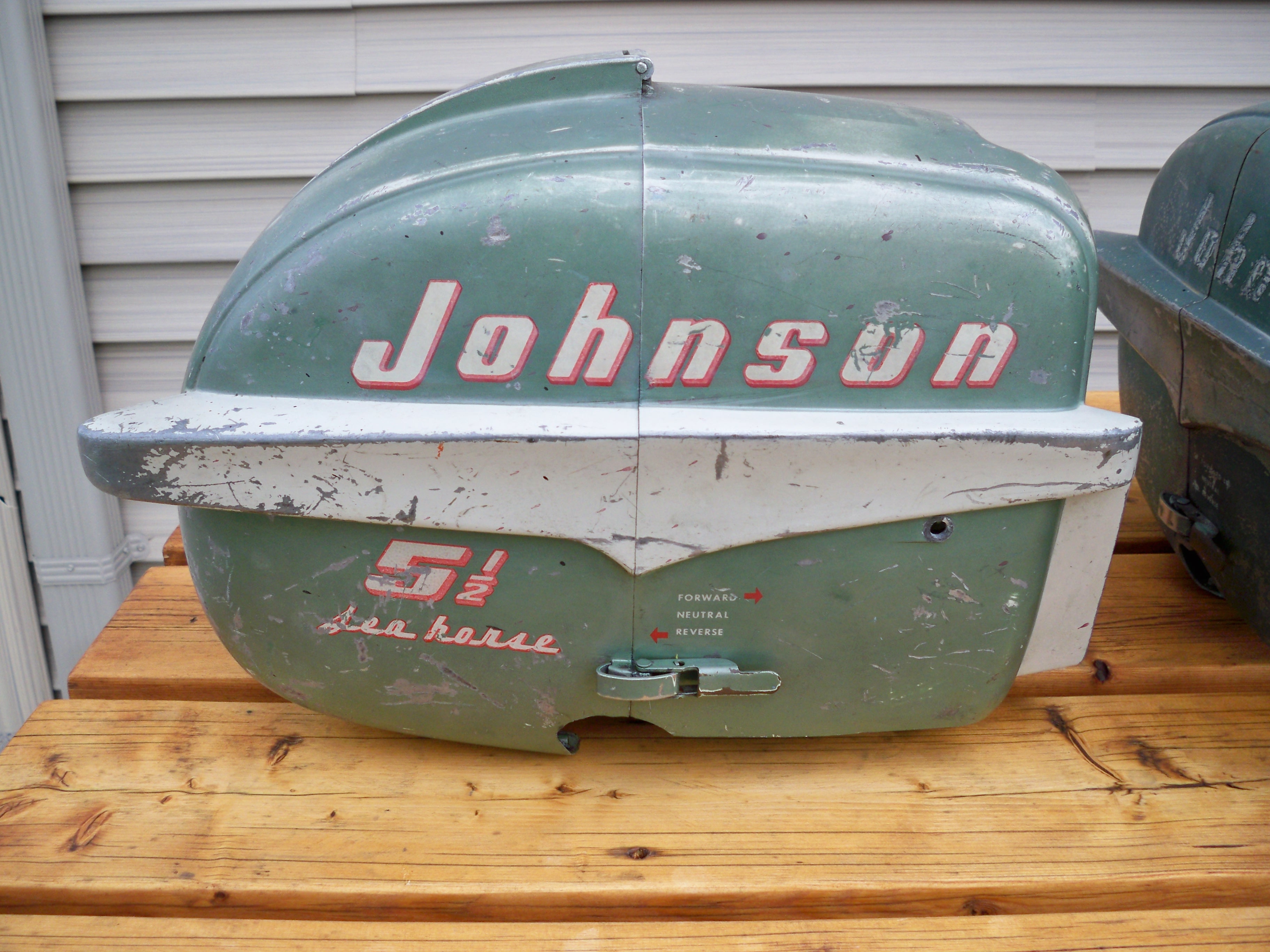

I could use some input as to what year this cowl was made. It came with a motor stamped as CD-11, but it does not match the cowls of the other CD-11’s or the one CD-12 that I have. Fits the CD-11 it came with just fine.

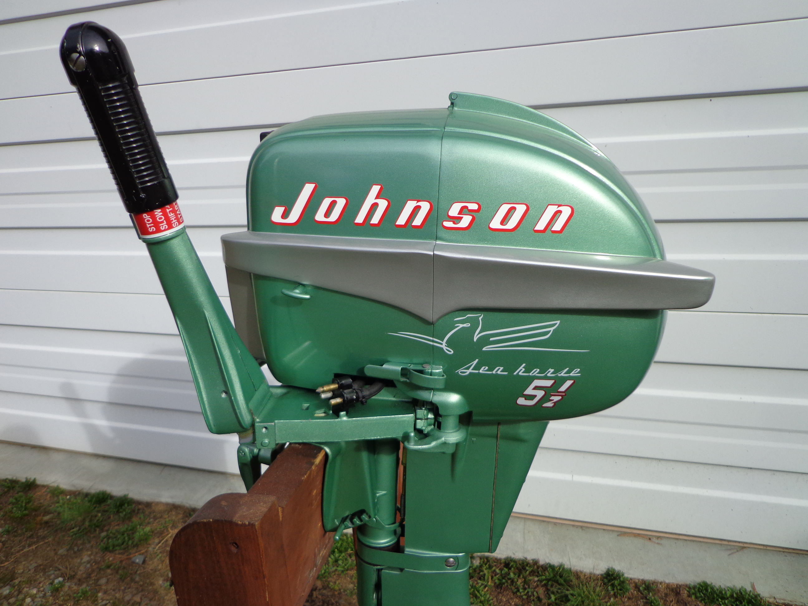

September 20, 2016 at 7:10 pm #44401The wing nuts were used through ’54 and about midway ’55. They changed to the slip off type, as you see in mumbles second picture. The intake manifolds are different for each cover type used, as well. I think the later style covers were quieter as well.
September 20, 2016 at 8:39 pm #44405quote t2stroke:All my wing bolts covers have silver trim. I thought they were early covers? Never have seen a white trim cover with wing bolts. Do they come both ways. I just assumed the silver trim covers were earlier motors. Not sure now?Dan in TN
I think you are right Dan. The silver trim was for the ’54 and earlier models, with wing nuts. Almost all the ’55 models I have seen were white trim and no wing nuts, but im sure there are some early ones out there from leftover stock from ’54

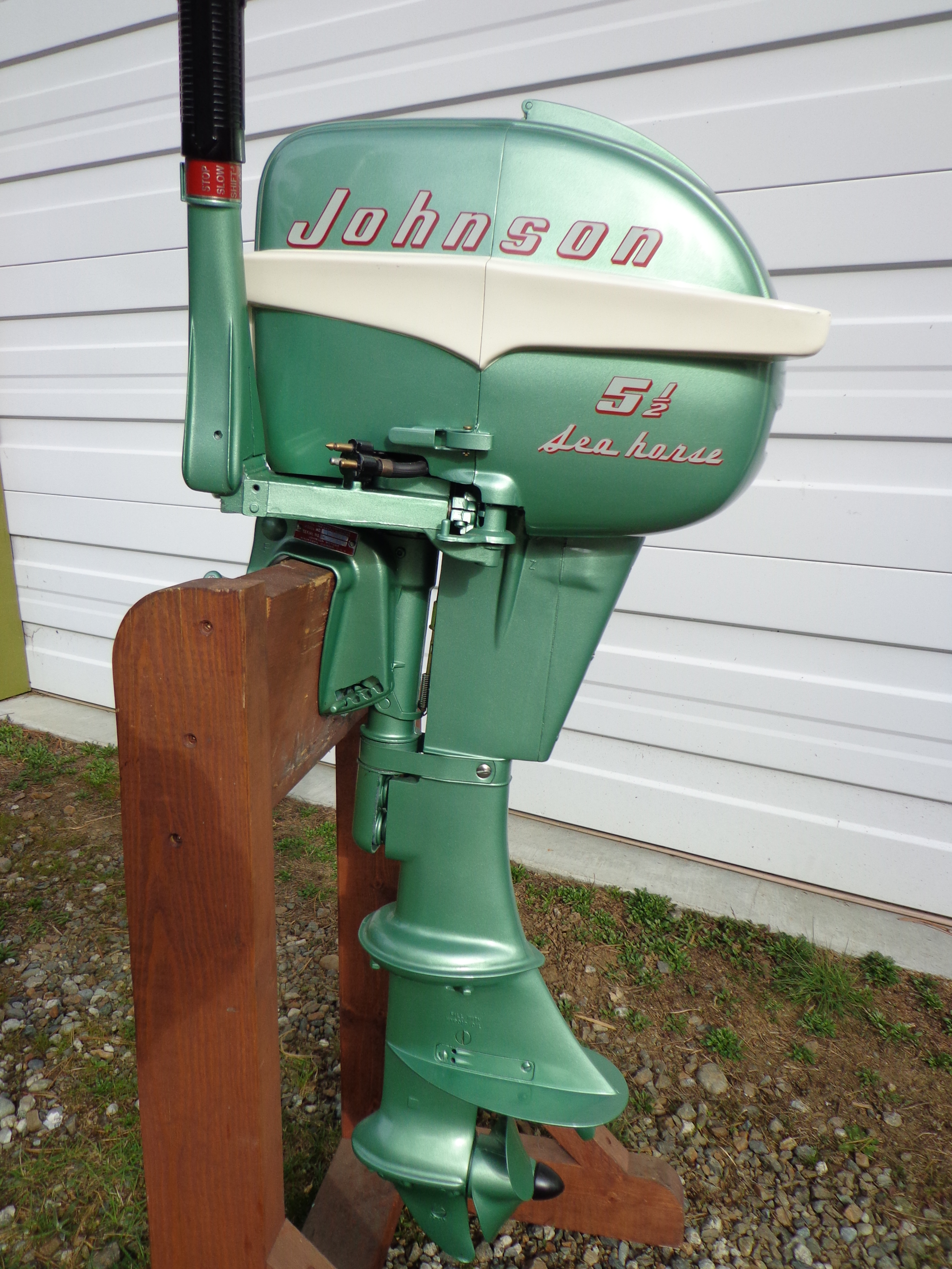

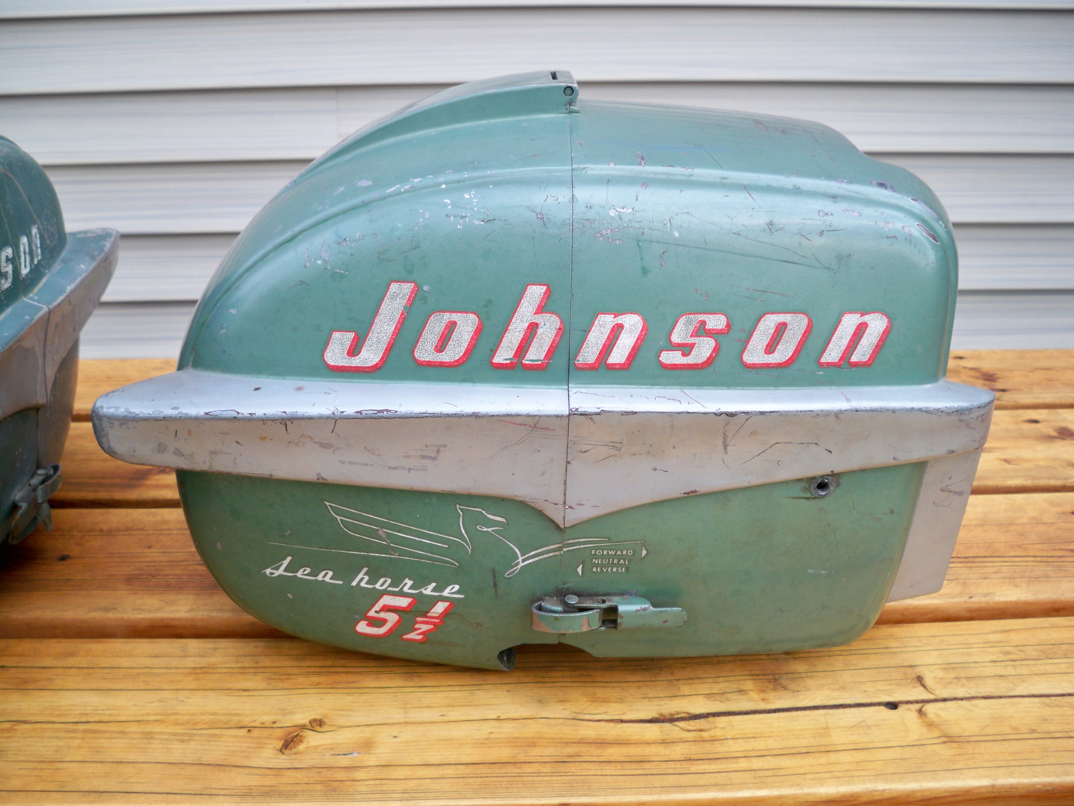

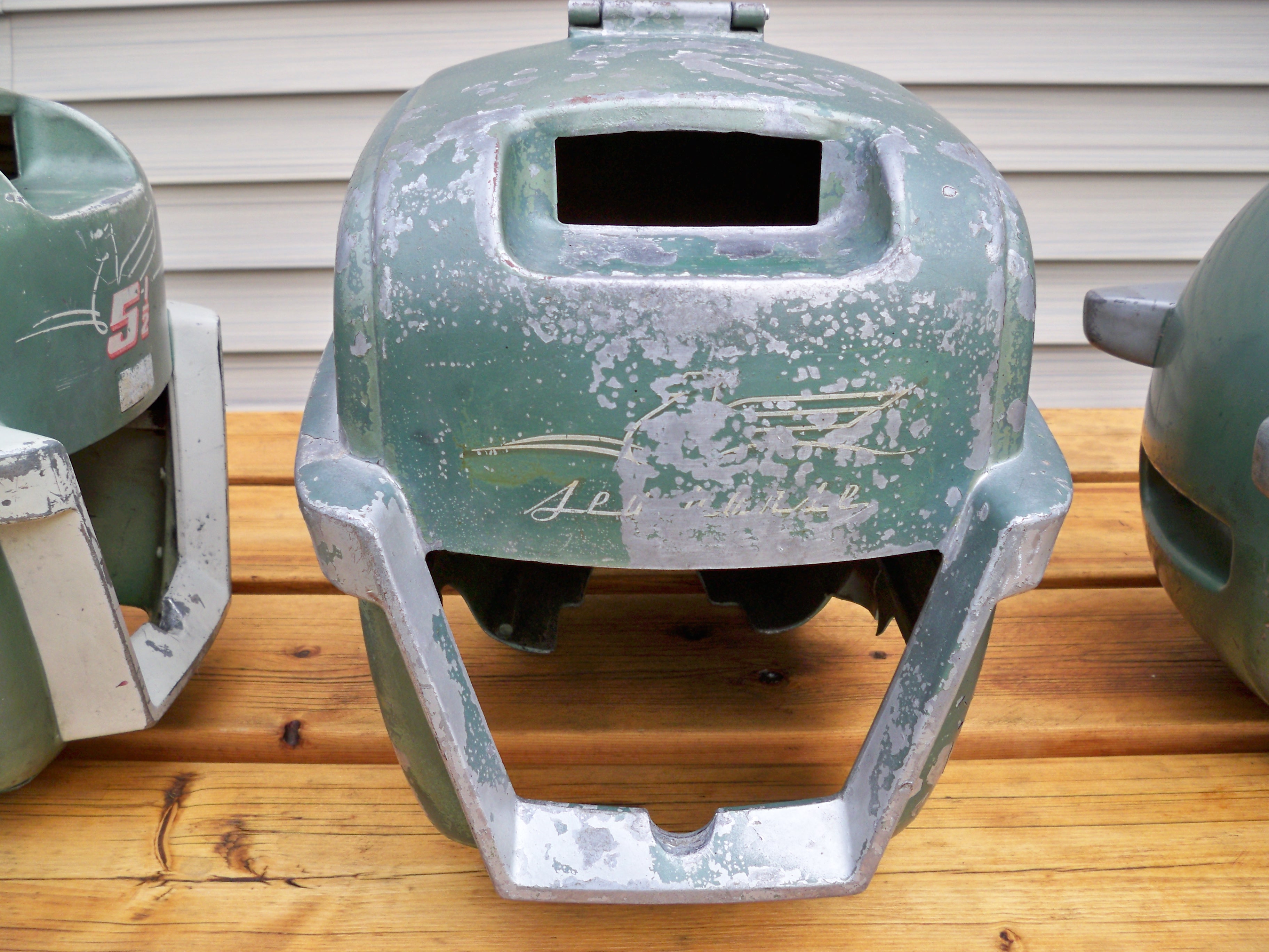

September 20, 2016 at 9:13 pm #44411Since this stirred up a little interest, and my question yet to be answered, here are some additional cowls from the other 5.5’s I am restoring. The first picture is the front of the original cowling which I am still curious as to it’s year of manufacturer.
The second picture is from my CD-12 (cream trim with wing nut attachment).
The third picture is of the cowling that came with one of my two CD-11’s.

920-764-0501September 20, 2016 at 9:27 pm #44413Well, it almost worked. Second pic is the CD-12 and the last pic is the front of the cowl in question. I am sorry for any confusion I have caused…won’t happen again (I hope).
